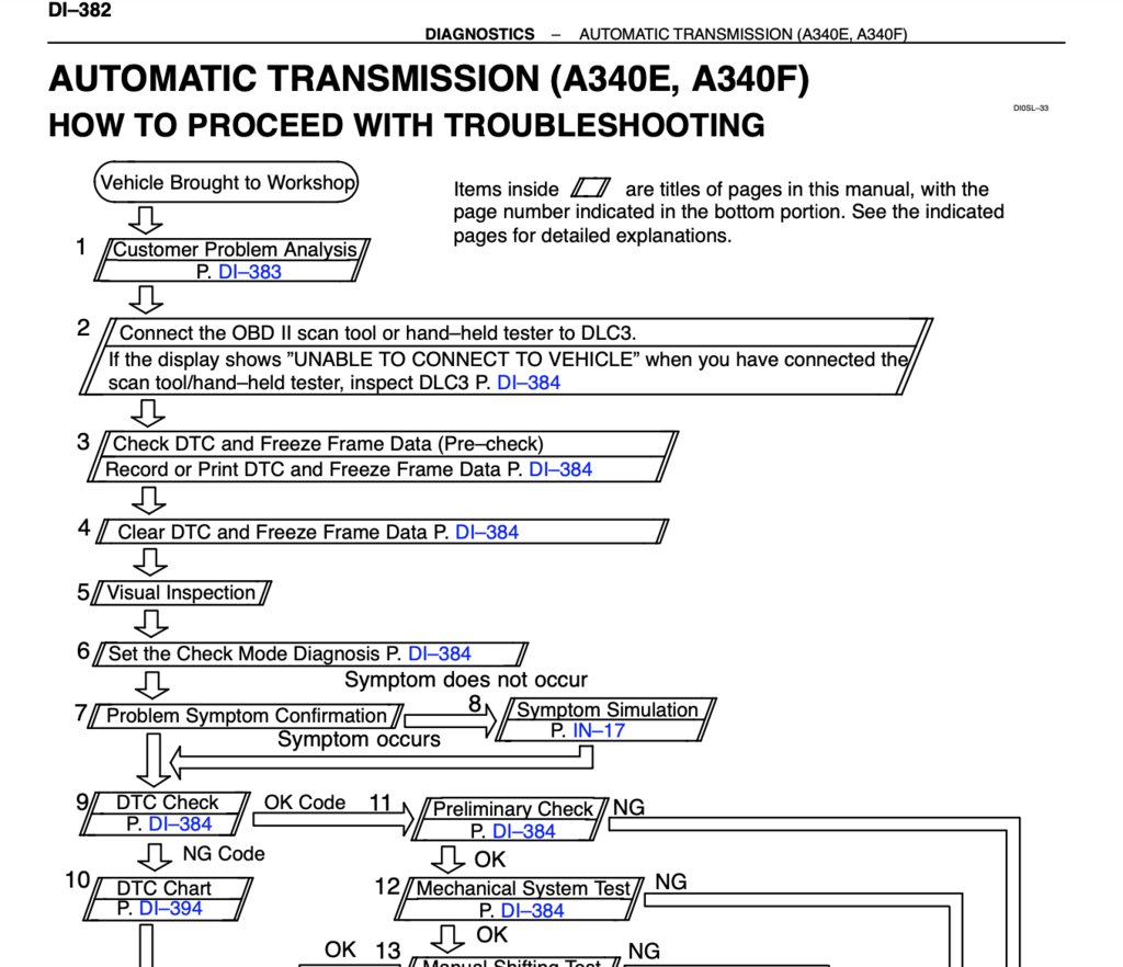

    No. I'm referring to section DI-382 page 1344

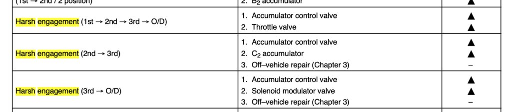

    also see section DI-401 page page 1363. Harsh engagement 2nd - 3rd.
