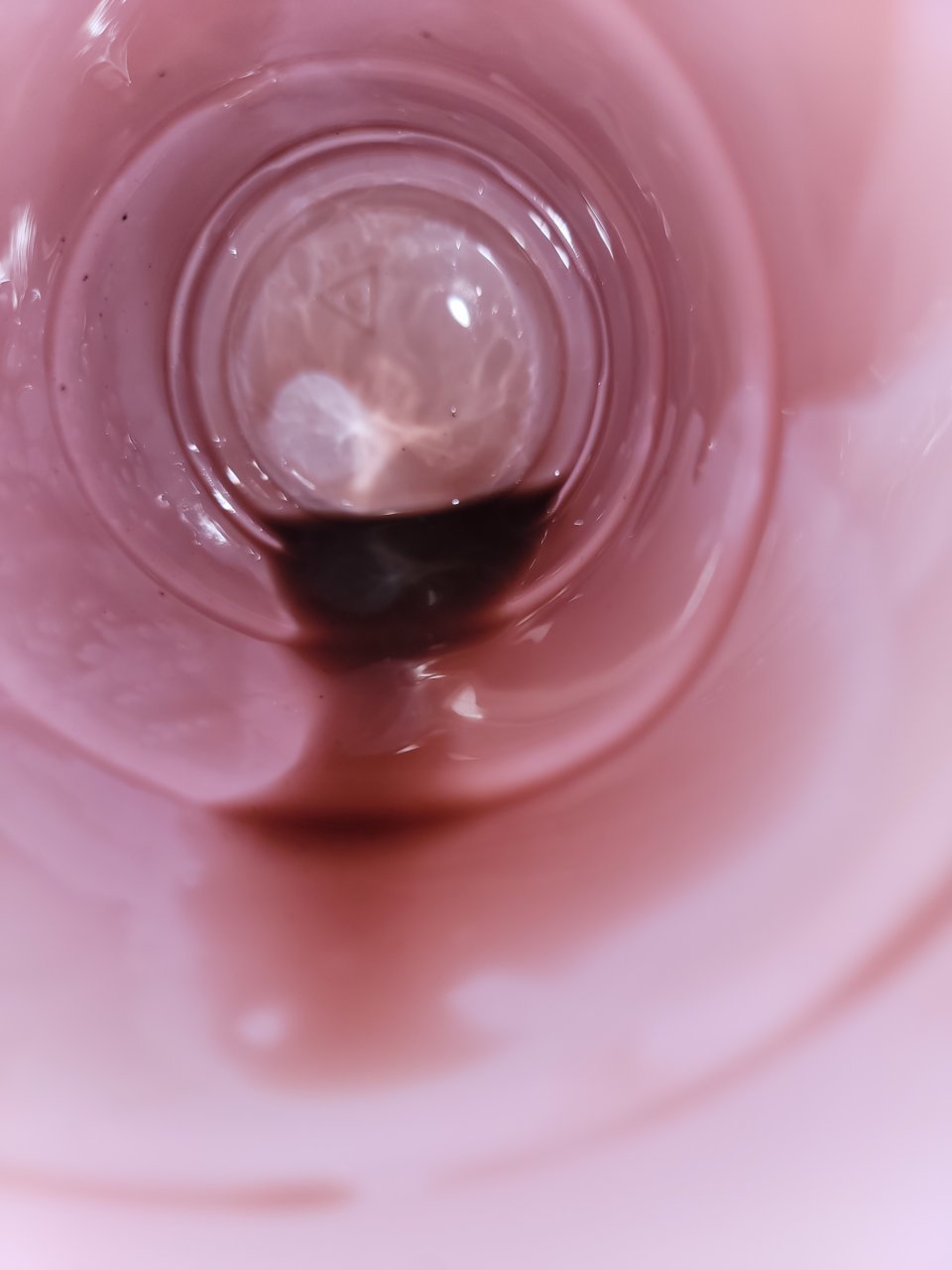

    So I tested the transmission pump today by putting a hose on the trans cooler. It seems to be pumping fine but does the attached image look like it has small pieces of clutch or something in it?20220420_185757.jpg

    Looks like my latest endoscopy.

    Pour it out on to some clean white paper towel to see what's there.

    theres little flakes of something. When you drop the pan to check/replace the solonoids, get a pic of the magnets.
