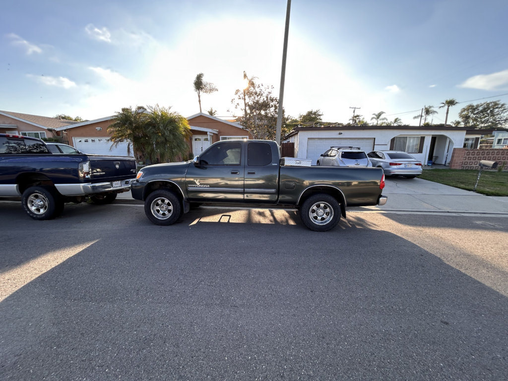

    I have a 2005 Tundra and I know some about cars. I've done the usual engine rebuilds etc. but I have done very limited work on this truck. I've noticed a slight sag in the back and I was trying to figure out if it was the leaf springs or the struts. It's pretty much stock as far as I can tell. Any advice will be greatly appreciated. 8E86B1B7-1BD3-4FAF-9CB0-9AD7930046FC.jpg

    How many miles? Leafs are probably worn out, or does it have a level kit in front? Those often go overboard and make older trucks look squatted.
    Add a leaf would likely be the cheapest easiest way to address it. Or new leaf springs

    Welcome aboard sir. You’ve got some kind of lift hardware going in the front. Inspect and report back or shoot us some pics and we can help sort that. Likely they “lift/leveled” the front and the rear got left behind. A leaf pack with some lift could even the score, or an add a leaf, or RAS, or airbags or *gasp* lift blocks. If you’re not wanting as much lift in the front, you can bring it down to level by changing up the hardware up front.

    I think I'm gonna start with the add a leaf. The truck only goes off-road a few times a month, so I'll be able to test it then. I watched a couple of videos, and it seems pretty basic of an install.

    You need to start by figuring out what’s going on in the front. Because your front is 100% not stock. I suspect they used strut spacers or aftermarket struts to raise it, or it’s also possible the made the stupid mistake of mixing both strut spacers and lifted struts.
    These trucks had a pretty hard forward rake from the factory which only gets more noticeable with age. Please take some pics of the top of the front strut tower for us, and some pics of the LBJ, and the strut assembly. It’s super easy to upload pics here.
    You also need to figure out if the LBJ are OEM or not. Many aftermarket don’t even last 2-3 years and when they fail, you can total your truck at best, or yourself at worst. It seems more often than not, with all the load on that LBJ, they fail without much (if any) warning. We’ve seen more than one sob story on here of, “My mechanic told me there was no play! A week later and $3,000 in repairs, I’m back on the road after it failed abruptly …”
    LBJ are a wear part. They should be proactively changed every 100k-125k miles max.

    Yeah no doubt you've got some lift in the front. Unlike my pickups and Tacoma of the past, the Tundras seem to very rarely have sag, because of how high the rear end is from the factory. My rear leaf springs were completely shot, and all it did was level my truck. No sag. I'd go out on a limb and say almost the only way you can end up with a sagging rear on a first gen Tundra is if the front is lifted.
