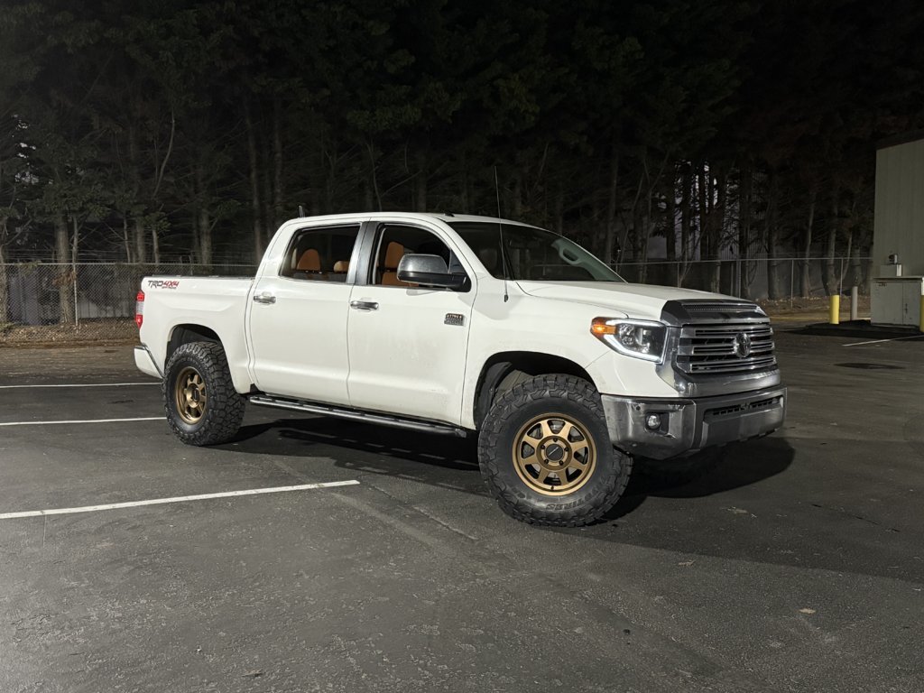

    We bought a 2019 - 1794/ TRD 4x4 Off Road in Super White and this is our build:
    -new to us on 2/20/25 with ~96,000 miles
    Here’s the most recent picture of our progress: April 26th, 2025

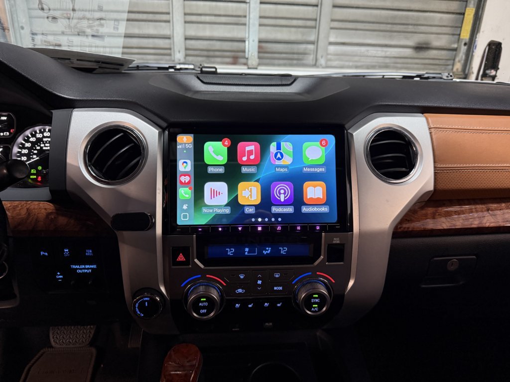

    Step one: Creature comforts
    I did a bunch of research and it seemed to me that the Dasaita 13, android(CarPlay) head unit was the best bang for the buck. It took maybe 45mins to install and now that it's in I think its even better. Full Carplay - check. On the Android side though, you can get in to some of the truck settings that I wasn't aware of like "one click unlock all doors", turn off "auto lock when in drive", adjust the volume level of the lock/unlock beep, and so much more.
    The Pop & Lock, tailgate power lock was also something the Tundra should just come with from the factory. Press lock and all the door AND TAILGATE lock. Press unlock and the all unlock, Amazing. This was a 30-ish min install. Sorry no picks.
    Interior storage organization: The Tundra is huge inside, but the wasted/unusable space is also crazy. It'll be a long term project to get this organized better for us.
    Running 4 Tacos is helping so far.

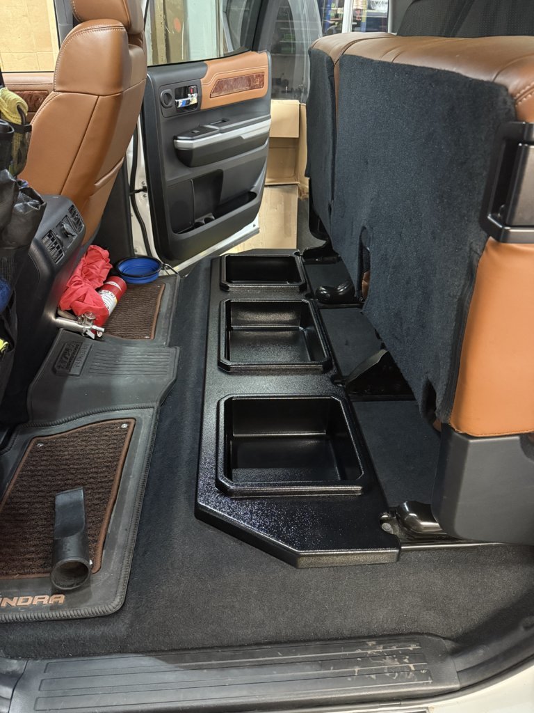

    3/12/25

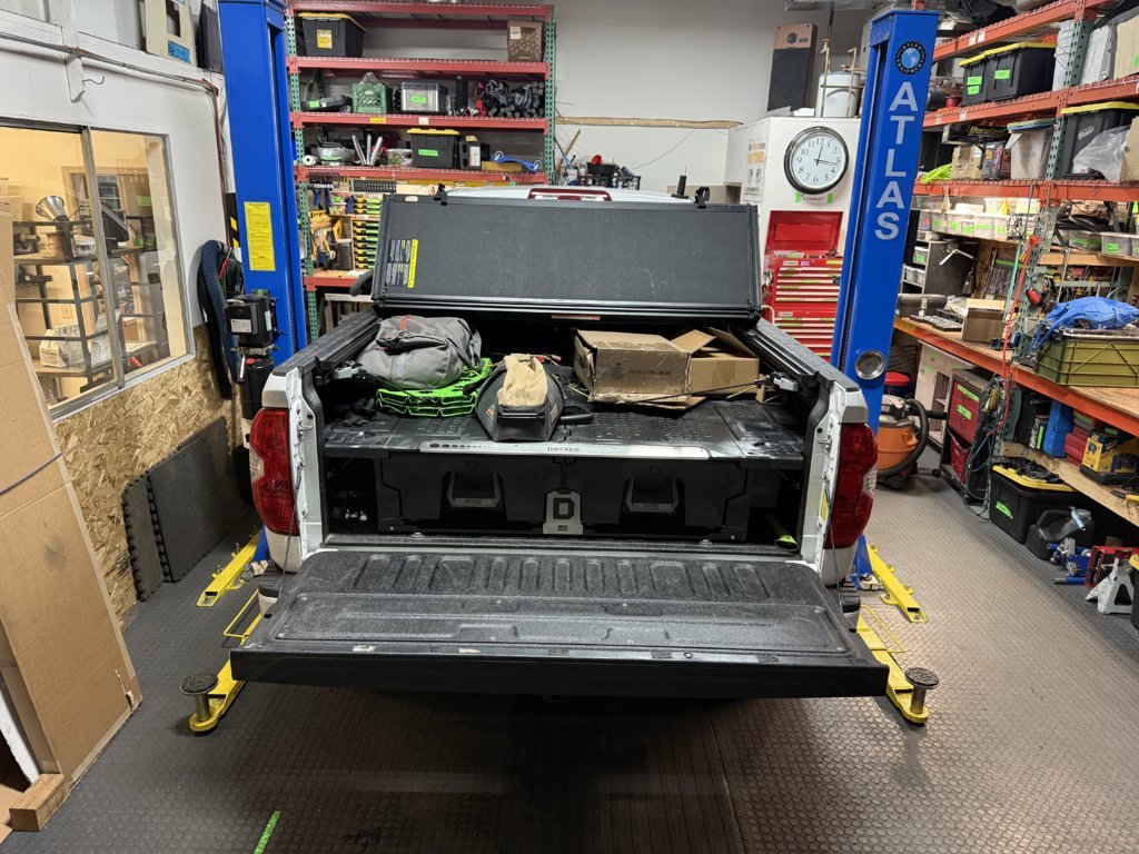

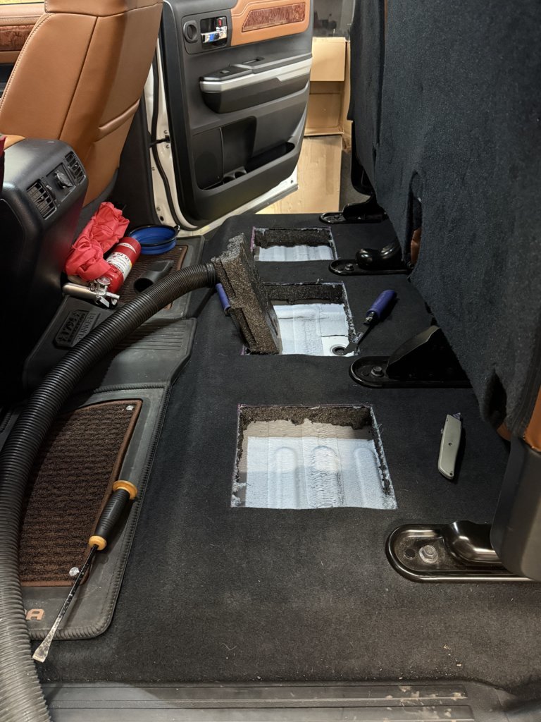

    ESP rear under seat storage:
    Why didn’t Toyota do this from the factory? Such a simple and well designed product. 10/10 recommend to all crew cab owners.

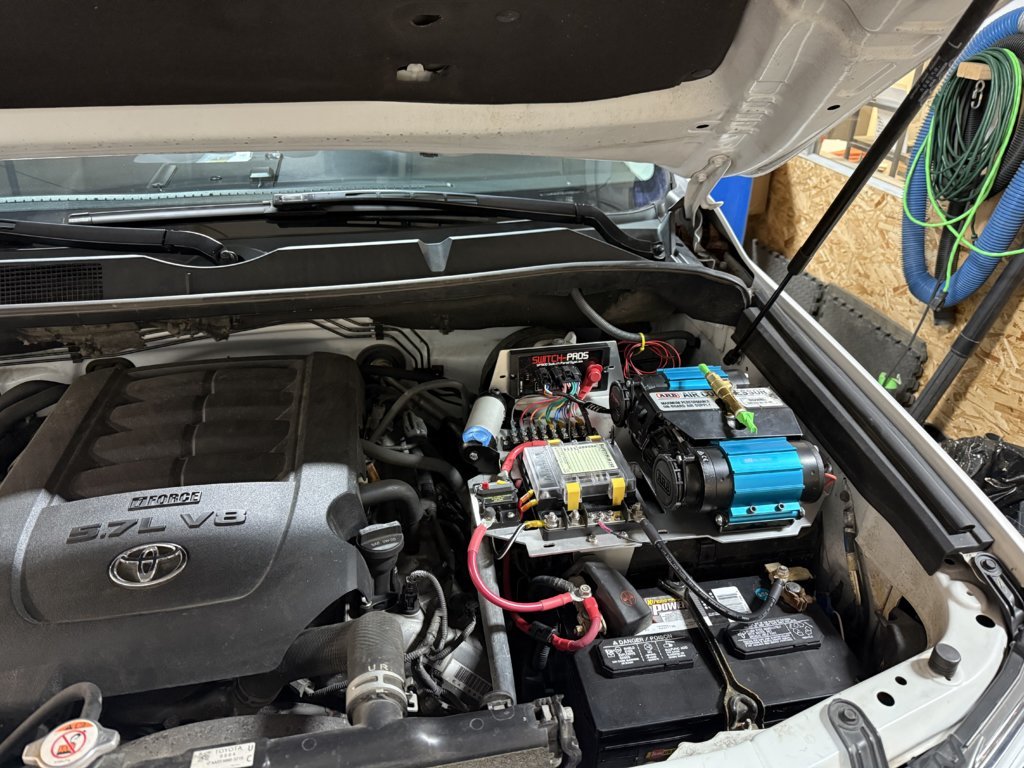

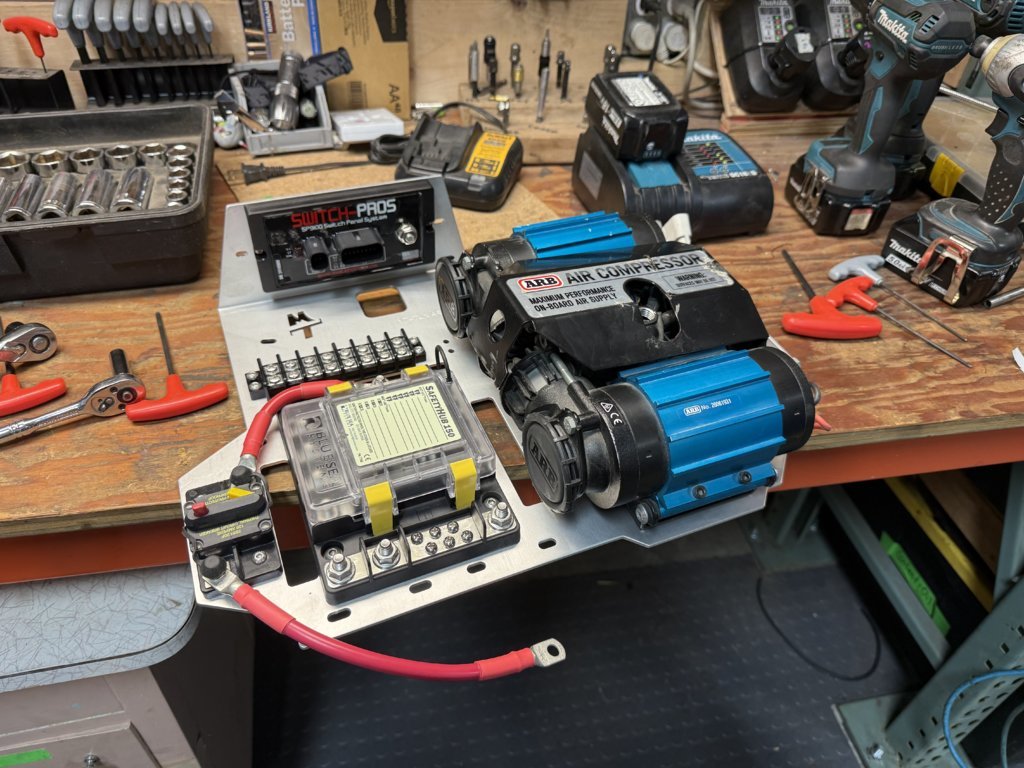

    3/13/25

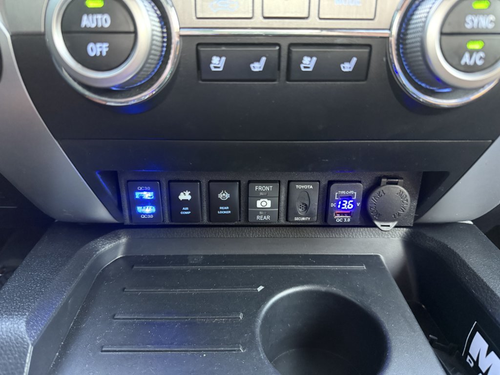

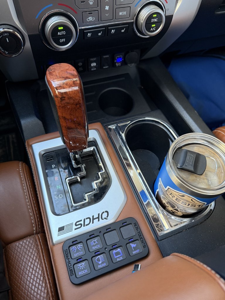

    -SwitchPro 9100
    -SDHQ 1794 switch pro center console mount
    -blackcatworks.com switch panel
    -sdoffroadmt engine bay mounting tray
    -ARB twin air compressor
    Here’s a big fun one.
    SDHQ kills it with this 1794 matching Switch-Pros panel mounting location. Setting ourselves up for the future with the light switches and the “Aux battery” goes to a 12v rear Anderson connector on the rear bumper to DC to DC charge our trailer. The “whip” turns on our WeBoost cell booster. Both brought over from our previous Lexus GX470.
    Black Cat works 3d prints this clean and simple switch panel allowing us to expand a bit. You always need more UBS ports, the ARB compressor is in and in the near future a rear locker. If you haven’t added the “anytime front/rear camera” yet, get on it.
    Chatting with Derek about his engine bay mounting tray for our Switch-Pros, ARB compressor and other electronics was great and super helpful. He has great customer service and maybe too much info on what he offers with his setups. Another 10/10 recommendations.

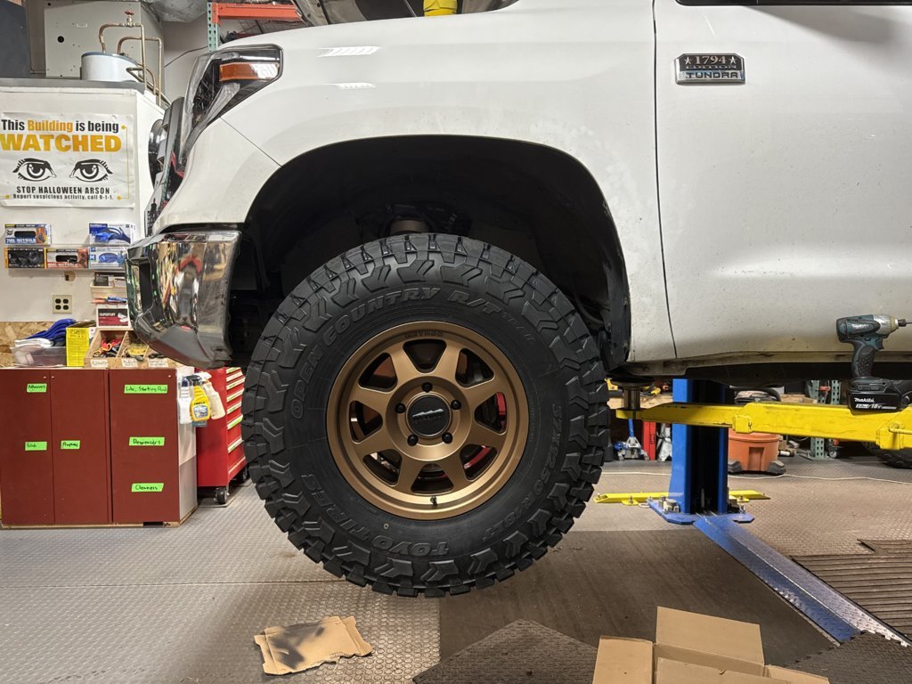

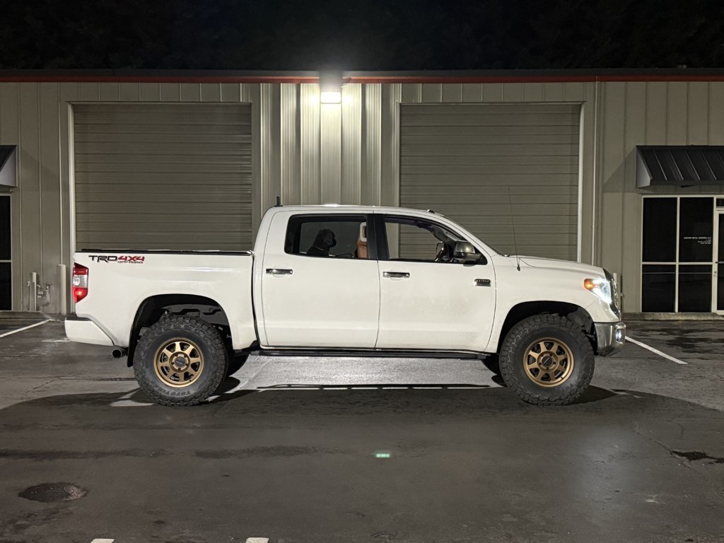

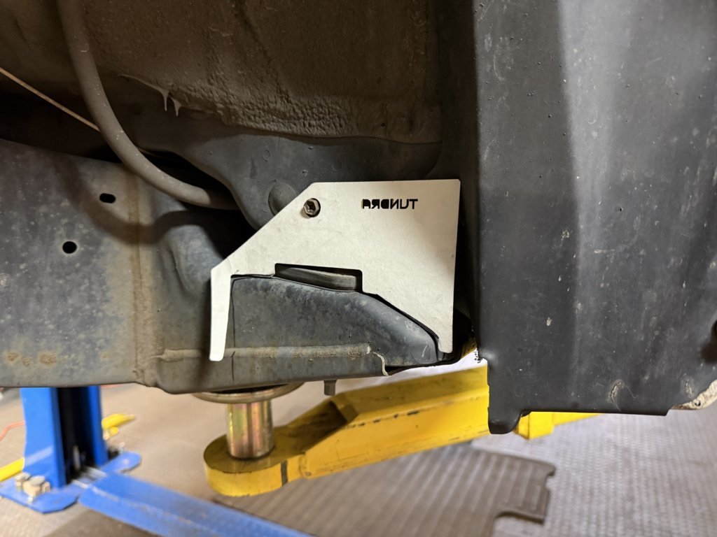

    Joining the Dirty-seven club. This is before our 3.5" lift kit is installed. A BMC, pinch weld adjusting, 1/2" front bumper spacers and no rubbing.
    -Method MR701 Bead Grip 18x9 / +25
    -Toyo Open Country R/T Trail - 37x12.5
    -Body mount chop w/ SDHQ filler plates

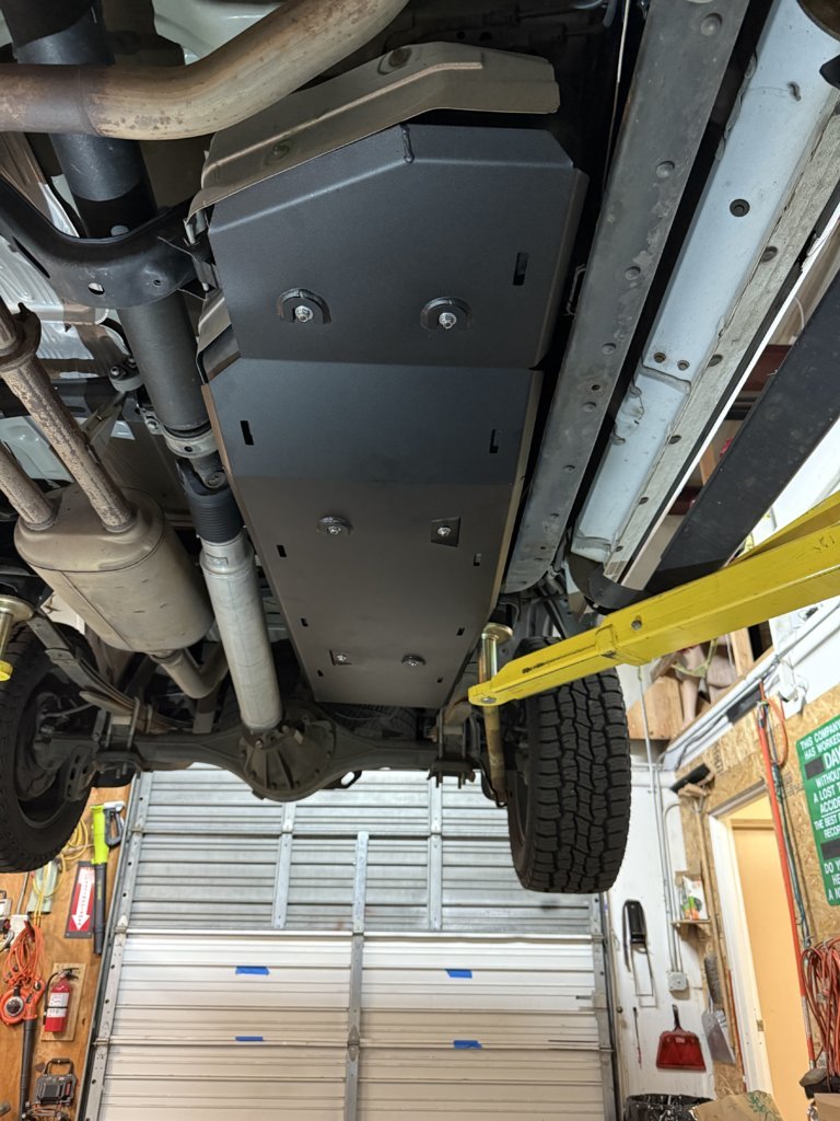

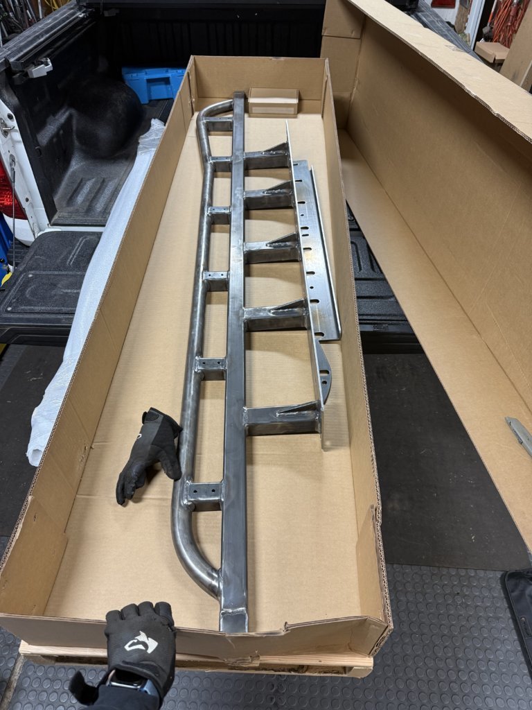

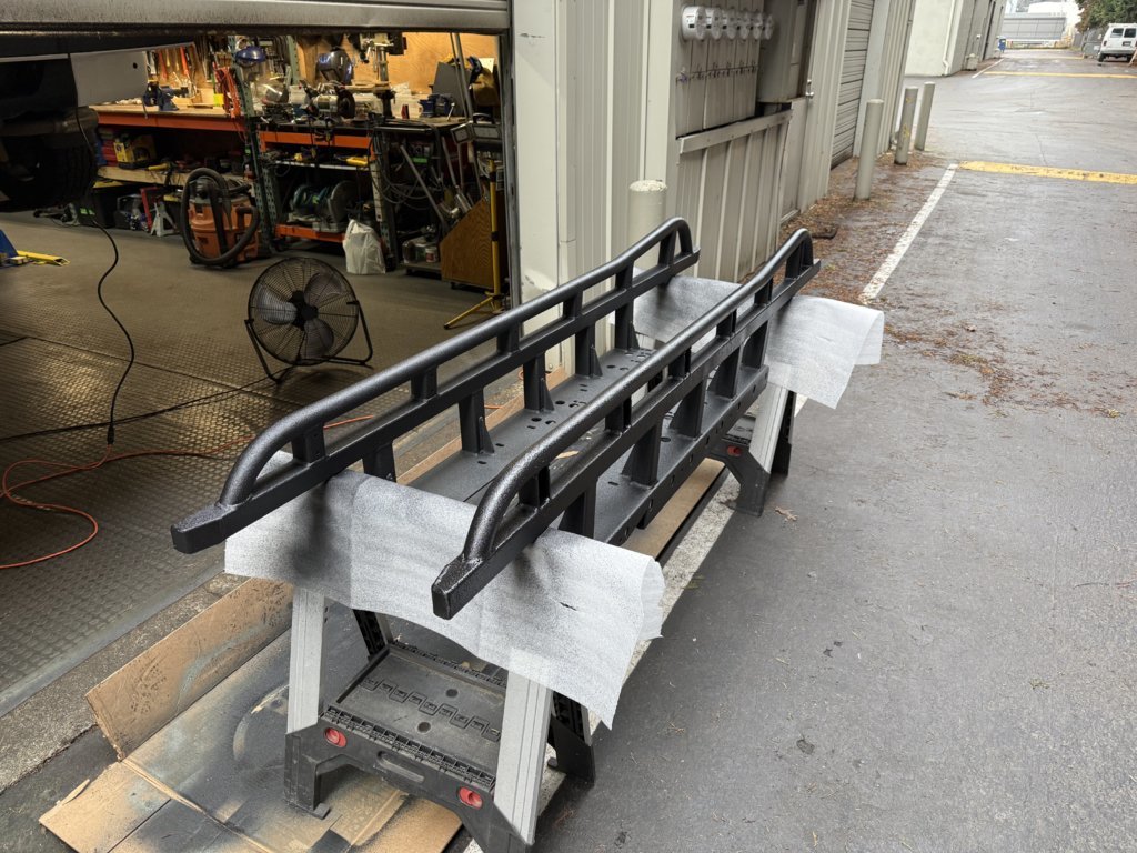

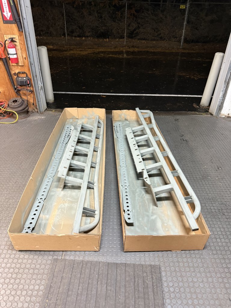

    Protection
    -RCI Gas tank skid
    -RCI rock sliders w/step, Raptor lined
    this was our first time raptor lining and I’d say it went well. Follow the directions, clean, prime and spray away.

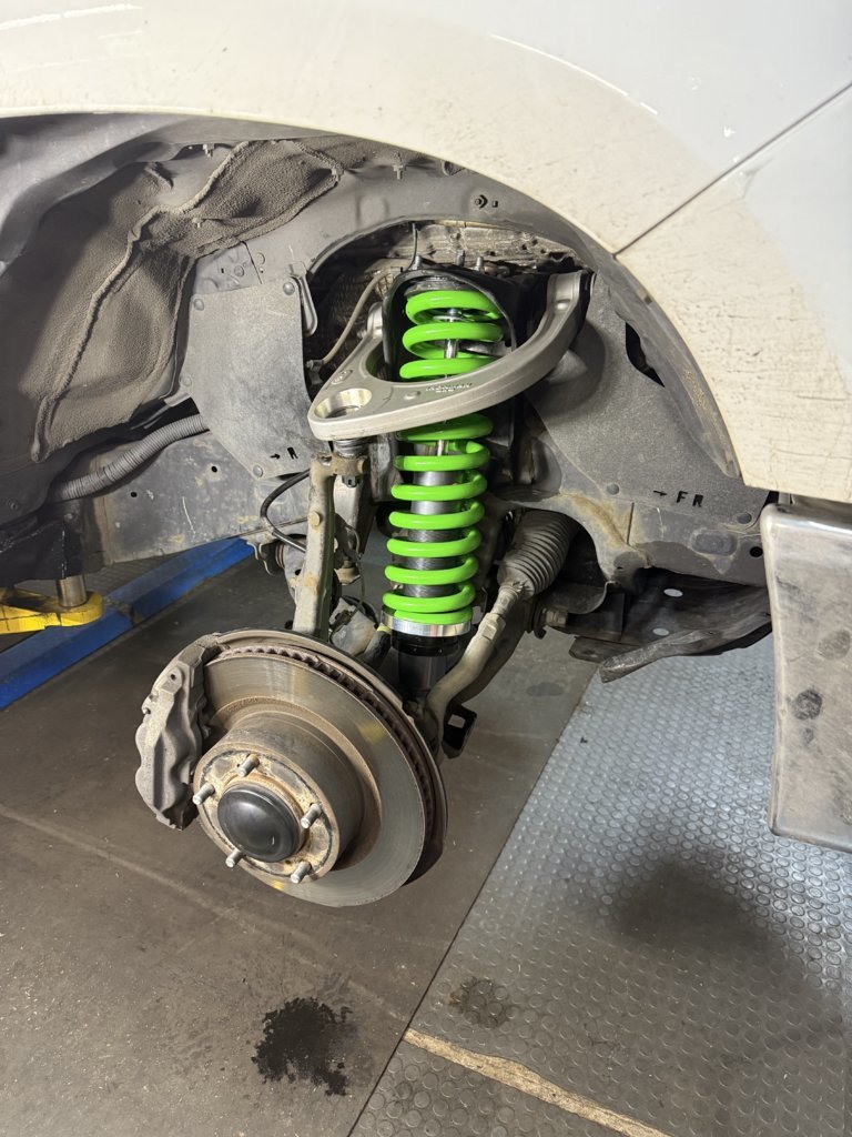

    3/19/25

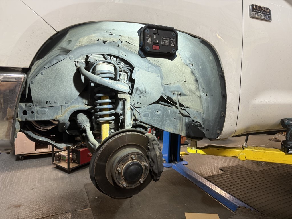

    -SDHQ Extended brake lines
    -Ironman offroad FCP 3.5” lift kit
    -Alcan Spring U-bolt flip kit
    To be honest I’d love the truck to sit about and inch lower than this kit put it but that’s a future project. Very excited to find this Alcan U-bolt flip kit. Thanks to Lifestyle Overland for that.
    Lucid Tundra, JMGmanAZ and BillyB like this.

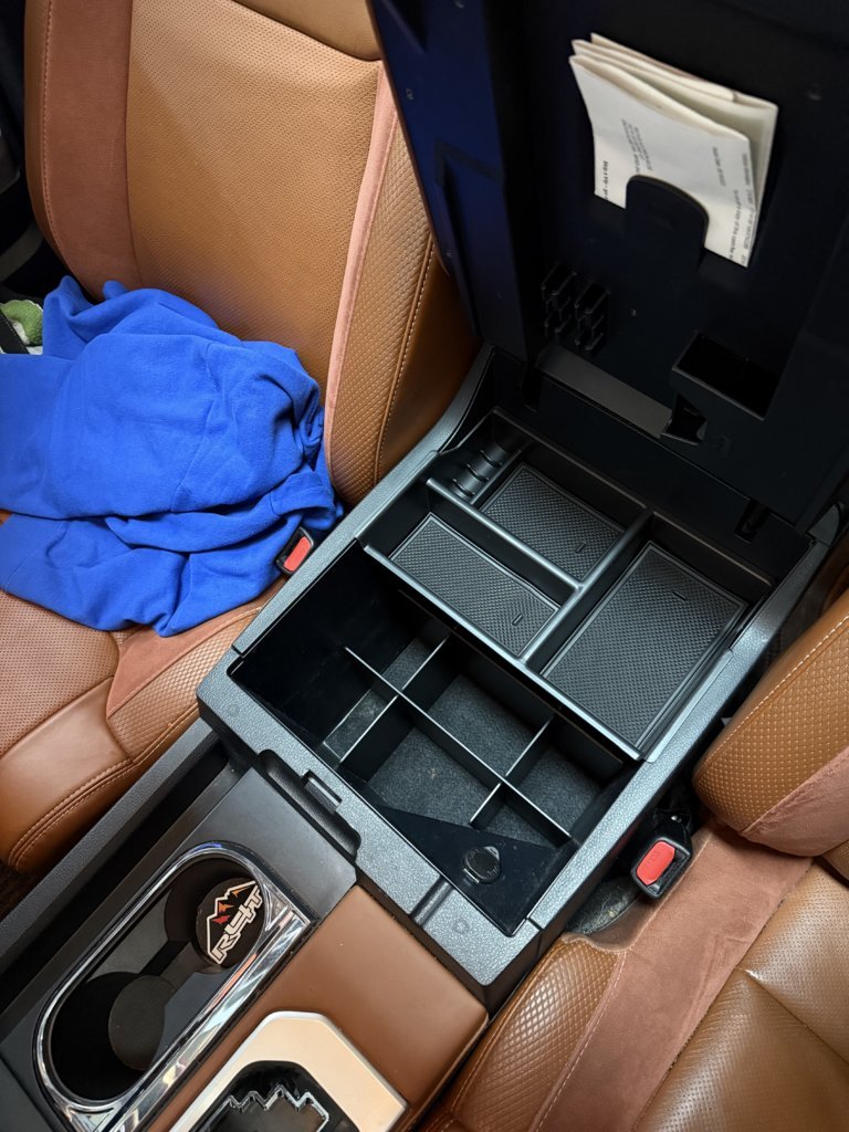

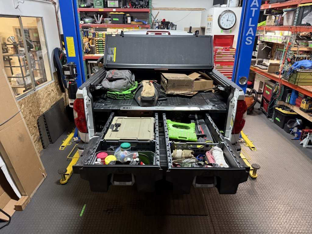

    More storage: My wife is equally excited to see how this works out for us. We talked with a bunch of Decked owners and watched a lot of YouTubes about the install/removal. We still want the use of our full (small) bed and we're conident that we can pull this out in less than an hour when we need. That's acceptable to us

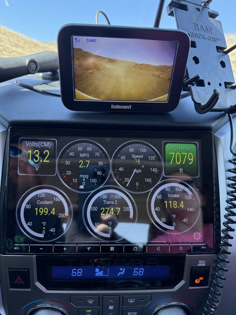

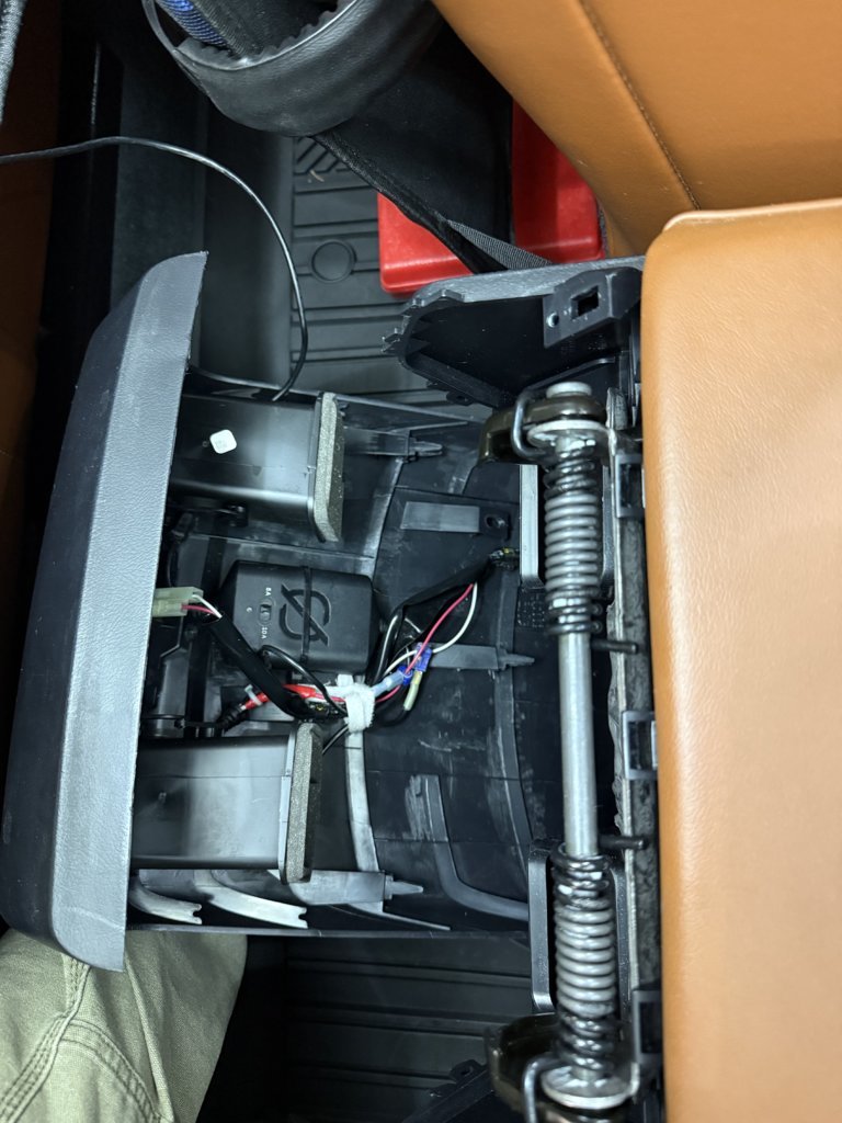

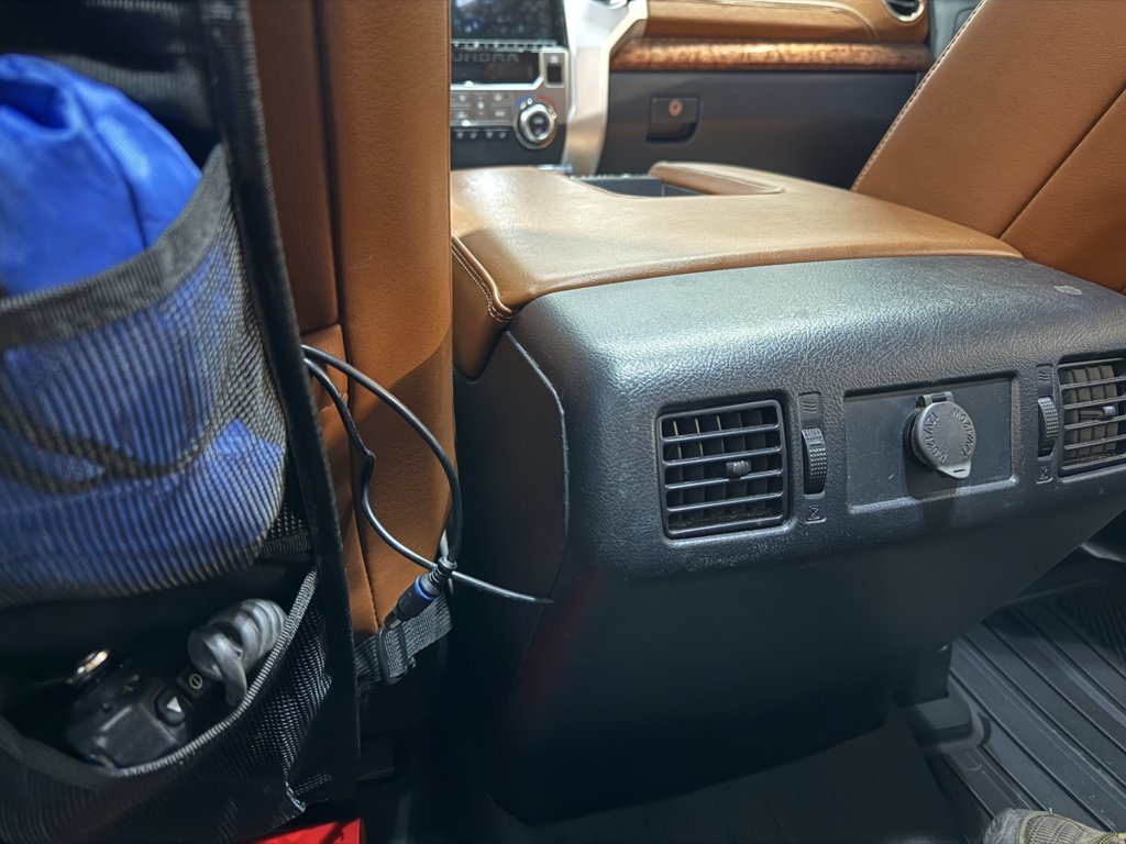

    5/9/25 Update:
    Missing a bunch on install pictures but that's alright because we had a mad dash to finish things up before a big Death Valley/Mojave Desert/Black Rock Desert trip
    Installed a Rago Dashboard mounting plate to hold phones/GPS phone/Trailer camera screen and such. We're still making tweaks on the organization of it but it works well enough. Also got my Torque Pro App working to watch all our numbers.
    *Transmission temp fun fact: When the trans torque converter temp reaches 300 degrees the Tundra dash shows a warning display that your "transmission temp too high, pull over" or something like that. We were climbing a rocky pass trail in 4-high and should have been in 4-low. Also added a trans cooler to my todo list.
    We had an IceCo 60L fridge in the back plugged into our GoalZero Yeti 1500 for our trip so I hard wired in the charger for ease.

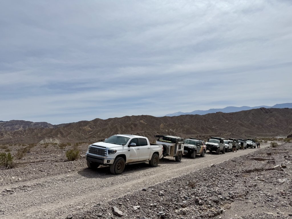

    Finally getting it dirty and seeing if everything holds together.
    Camping at the Saline Valley hot springs after driving Steele Pass to enter Death Valley NP
    One of our favorite camps in the Mojave National Preserve.
    We had eight trucks on this trip from Seattle down.
    Leaving north east out of Furnace Creek DV on the Echo canyon trail.
    The Black Rock Desert Playa, where Burning Man is held on our way to Soldier Meadows Hot Springs.
