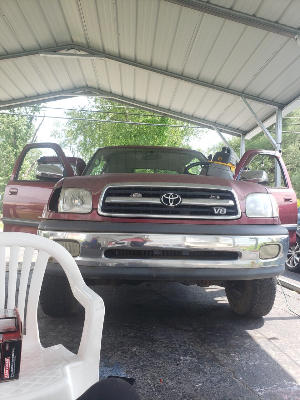

    Lovingly dropped in my driveway by my father in law last year. It sat untouched until two weeks ago when I put a battery in it and started it. It ran for roughly 90 seconds and fell on its face. Started the trouble shooting process by replacing the fuel filter and adding some gas treatment to the tank. Still nothing, it wasn't until I removed the filter again and noticed that the fluid coming out of the input side of the filter wasn't just gas, it had an oil gas like feel but was mixed with a lot of water. Dropped the tank and found my issue, the fuel pump assembly gasket had deterioated and was allowing water that made its way from between the cab and bed to drain directly into the tank. After draining roughly 10 gallons of water and what looked like 2 or 3 gallons of gas, remember this truck was dropped in my driveway. The fuel pump and assembly has been replaced and another filter. I have added two bottles of heet to help with any other water still in the fuel system.
    The truck now starts and idles but definitely has a miss. I will be ordering a full set of coils and plugs to see if this fixes the miss. Then I will begin the task of going through it with a fine tooth comb. This truck will be rejuvenated and become my daily driver. I will add to this thread as I complete more work, along with more pictures as I get her cleaned up and ready to hit the road again.
