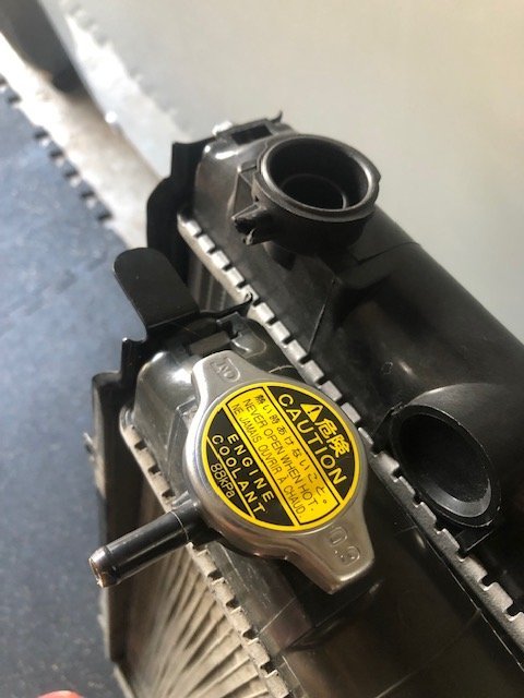

    A couple updates on the old truck. First is I rolled over 200k this morning.

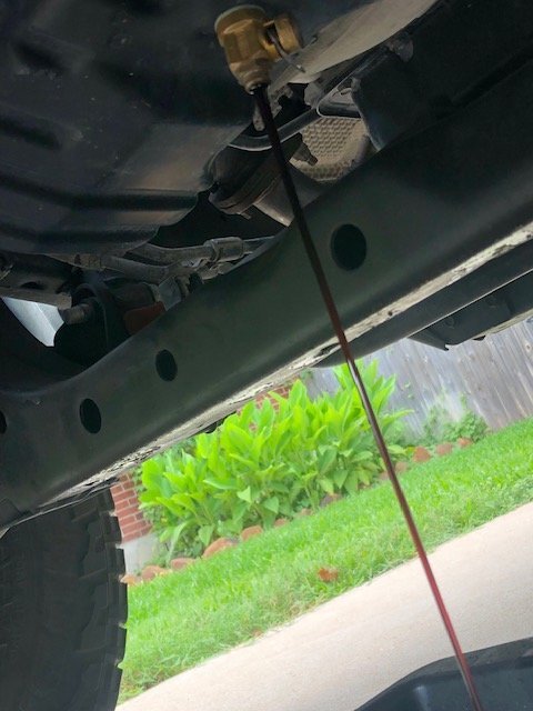

    Second is I have put 500 miles on my new gears and I did the break in oil change this afternoon. I finally landed on 4.56 with a Truetrac. I love how it drives. Gained some torques on the low end and the Truetrac is super capable. I went out to a place in Lago Vista to try out the Truetrac and there were a few places I was concerned about but the Detroit just plowed on through.
    Gotta jack up on the axle to get all that old oil out.
    Few tiny metal shavings but nothing to be worrisome about.
    For a life update, I got accepted to a little school in Longview called Letourneau. Looks like I am going to go learn how to be an engineer. That means I need to get a few things squared away on the pickup before I go. Top priority is replacing the radiator. Denso discontinued the radiator for 4.0L :( so I am looking at the Mishimoto plastic tank.
    https://www.mishimoto.com/2000-2006-toyota-tundra-replacement-radiator.html
    I would replace all radiator hoses, water pump and thermostat and all that good stuff at the same time. I was also considering doing the Hayden 679 axillary trans cooler and Derale 13011 thermostat and not connecting the trans to the radiator to eliminate any possibility of pink milkshakes.
    Anyway, y'all stay warm.

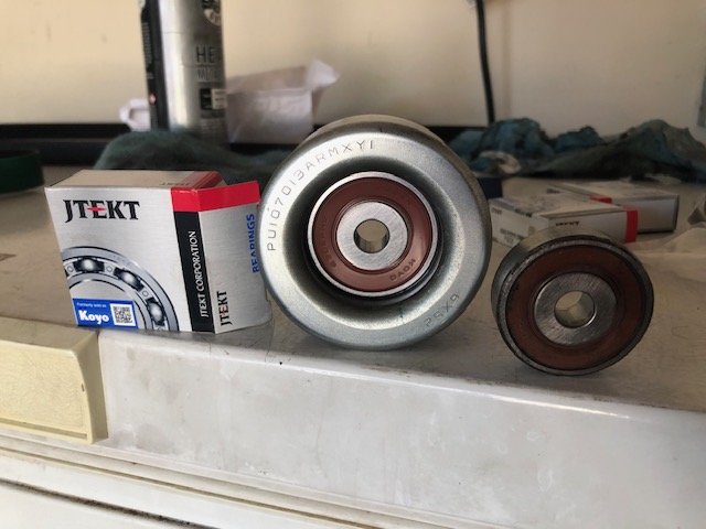

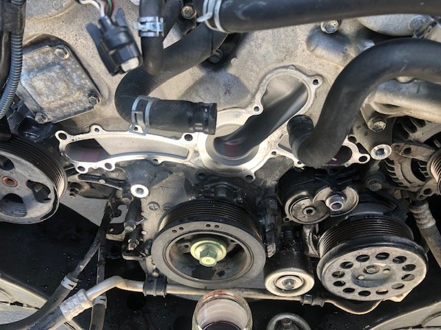

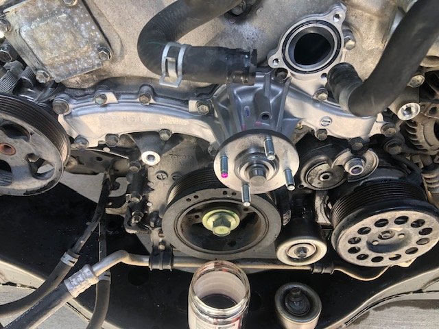

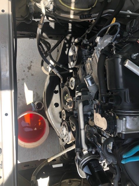

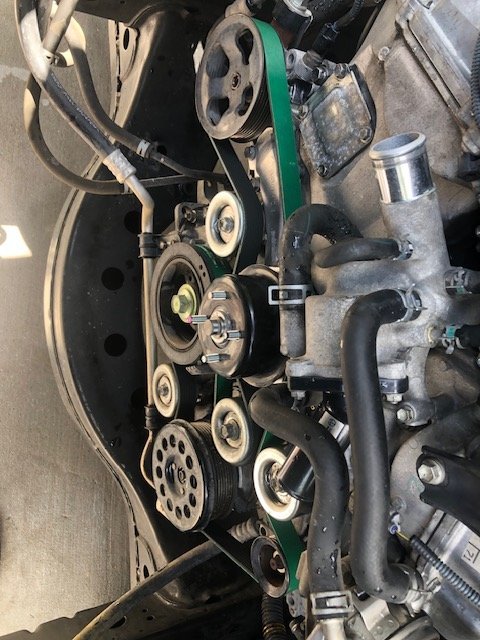

    This weekend I did Aisin waterpump, thermostat, and fan clutch. I pressed new bearings into the old idler pulleys for the serp belt and got an HD green belt from Gates. I also did an oil change (6 months and 1800 miles). I had a new Mishimoto radiator and I found out too late that the coolant reservoir nipple had broken off so I am stuck for a few days until I can get a replacement.
