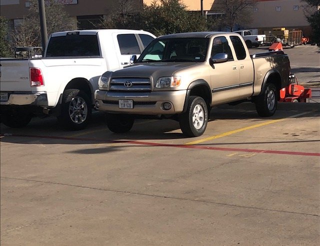

    I got the tires and wheels mounted the other day. I went with the odd size of 245/75/17 which translates to 31.5". The old tires were 255/75/16 so I gained 1.5" of tire. Gunmetal 4runner TRD Pro wheels wrapped with Goodyear All Terrain Adventure with kevlar. So far the ride is better the old and crappy highway terrains that were installed. Handling and noise is good for an AT tire. I saw minimal if any performance drops. I am pleased especially considering I got them for $138 a tire (without a special) from Discount Tire.
    Waiting at Discount.
    66423432373__C6655EB7-7828-4635-90EC-398DBBAFA83F.jpg FE395271-C3A3-420A-B0FA-C2E00B7B32DC.jpg
    I will post up more pics next time I get it out!
