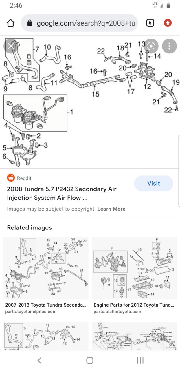

    Do you know the parts that make up the whole Secondary Air Injection System. Is there two pumps for the 5.7L?

    Yes two, one for each bank
