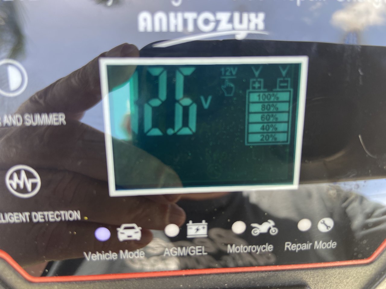

  30. Jun 24, 2023 at 9:57 AM
    #60
    JINKSTER17
    JINKSTER17 [OP] New Member
    Apr 22, 2023
    #95846
    32
    William
    2019 Super White TRD Crewmax Limited
    So here we are about 2 months into it and I finally took a moment to hook my smart charger up to check things out and as I suspected?…I didn’t even need to plug it in.
    I suspected that I wouldn’t need to plug it in because the needle on my dash voltmeter pretty much stays at a touch over 14 volts and despite the fact that I have a 20L AstroAI freezer/fridge (I leave plugged in and comes on every time I start the truck) my X27 battery is fully charged without charging it up once a month.
    My most sincere thanks to those of you who walked me through wiring up my own fuse protected diode. IMG_5961.jpg IMG_5960.jpg
