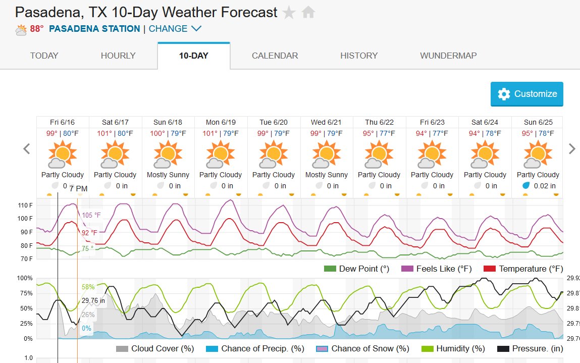

  10. Jun 16, 2023 at 3:09 PM
    #40
    Mad Max
    Mad Max New Member
    Oct 6, 2020
    #53237
    670
    Max
    2021 Tundra Limited
    Did some testing on my Tundra 96f today 58% humidity. No matter what I did I could not get vent temp below 43-44F, the compressor would cycle off, same as my F250. Cab temperature (bright sun) was 78F and felt colder than that, fan speed was mid-way. I had zero issues being comfortable. 4 people in car with black interior and graphite color. When first stared AC vent was blowing 52F with 100? in car. So if you are below 40f I have no clue what's going on as the compressor should be cycling off to prevent the evaporator from freezing. I can get my Lexus to blow 35F out the vents, 4 runner same 44F then compressor cycles off. 2001 Lexus doesn't cycle its has a variable displacement compressor which is the best AC I ever had in anything. Oh I know its 21 years old and 210K miles and better technology than my 2021 Tundra.......
