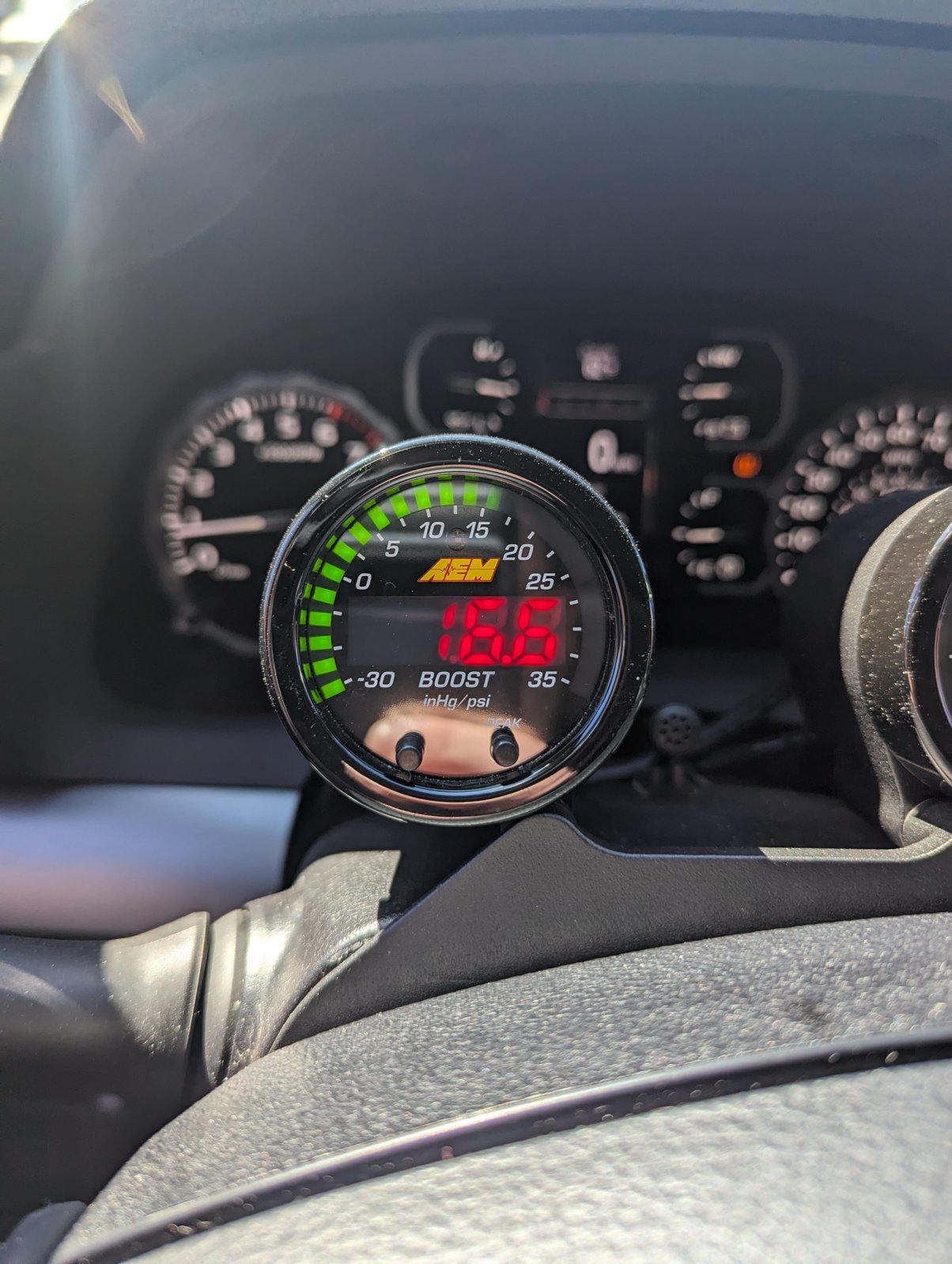

    PXL_20240329_183827104.jpg She makes boost.

    You mean a lotta boost.

    HELLA LOT OF BOOOOOOOOOST.......
    16.6 PSI, damn, even some Civics don't make that number on the regular....

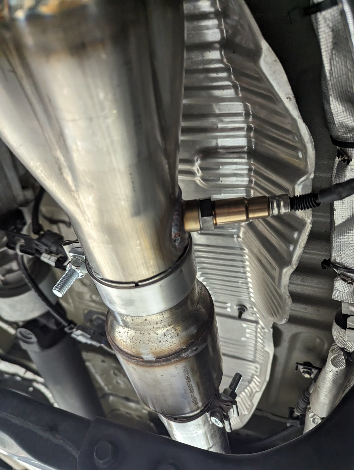

  14. Mar 29, 2024 at 11:55 AM
    #374
    Fastlane47
    Fastlane47 [OP] New Member
    Feb 1, 2021
    #58478
    606
    Maryland
    2018 Platinum
    22x12 Weld wheels, TRD Lowering kit, TRD Rear sway bar, Honey D Fenders, Corsa side exhaust with black tips, Magnuson supercharger, pedal commander. Lux hard cover, TRD PRO Grill, Kicker 10in Subwoofer, Viper remote start, paint match mirrors and door handles, LED tail lamps, G10 rhino lined running boards. 3m on front fenders, hood, roof and rear fenders. Stop Tech Big Brake Kit front and rear.
    I put mine on the driver side, just on the other side of the first O2 sensor .PXL_20240304_140201821.jpg
