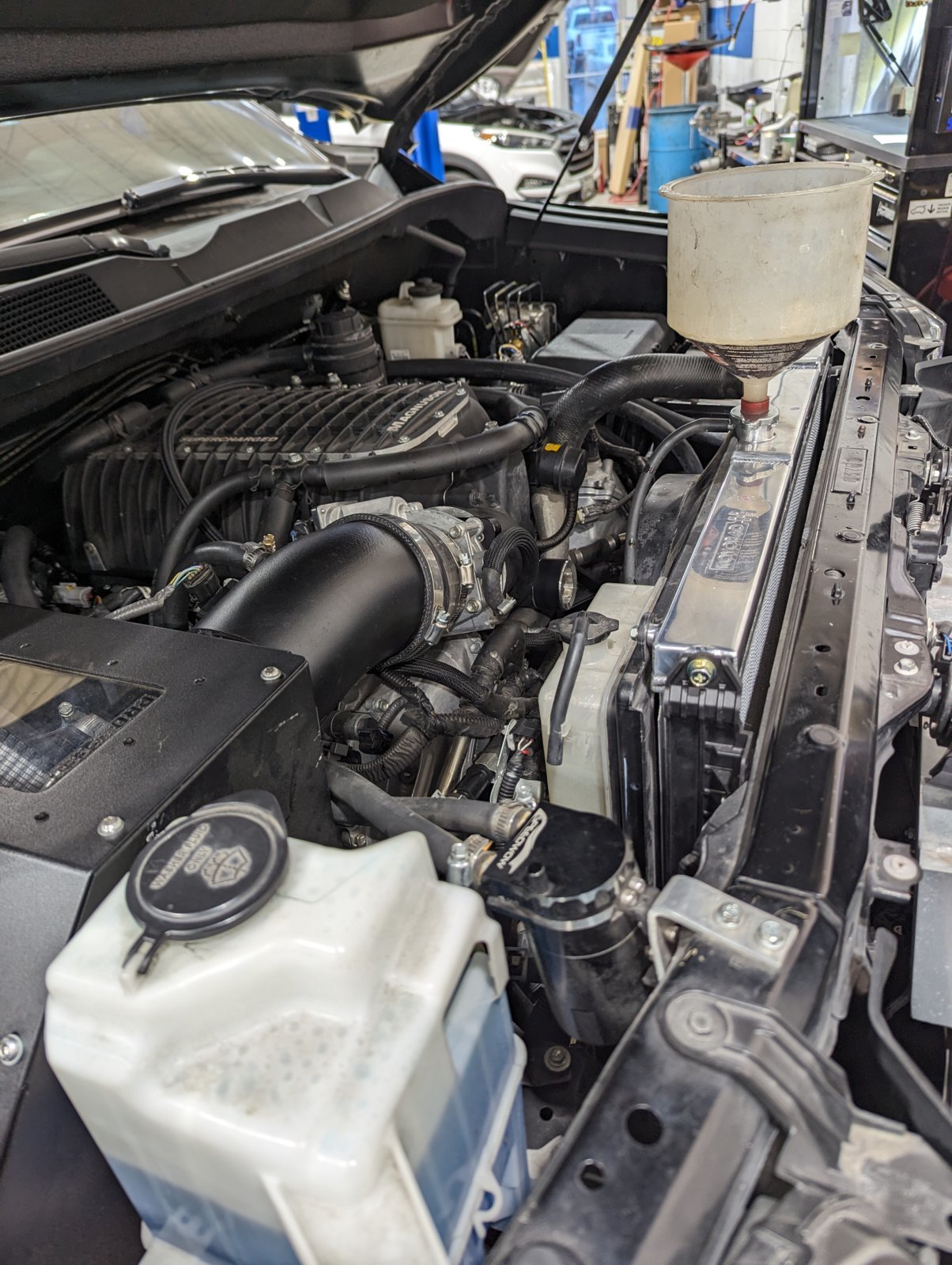

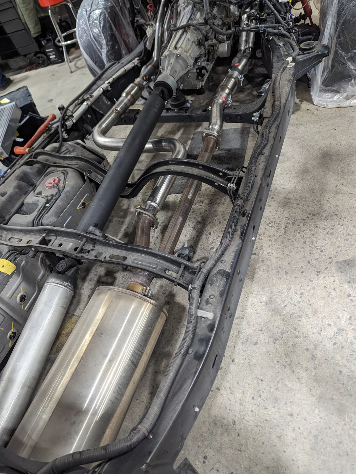

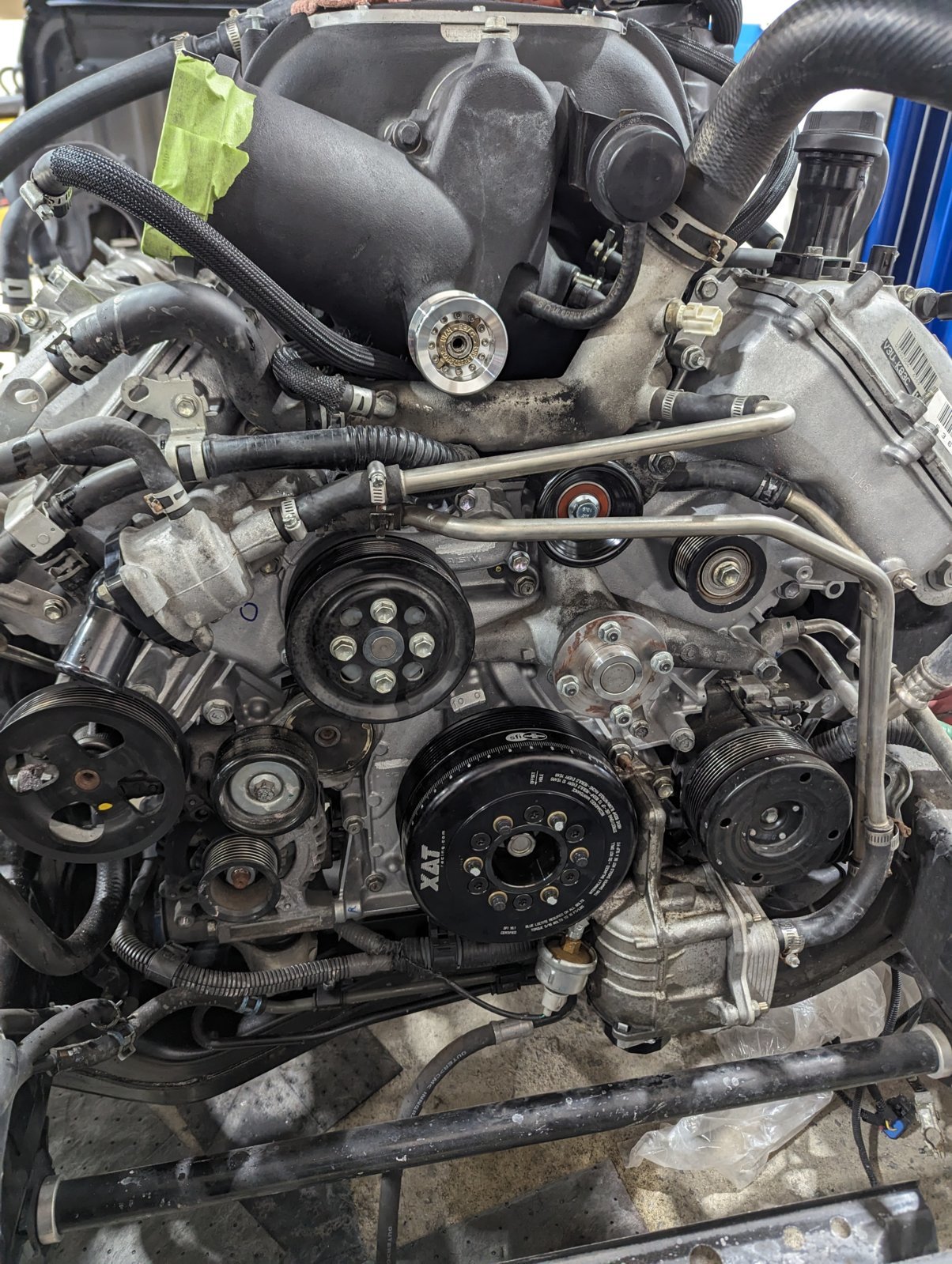

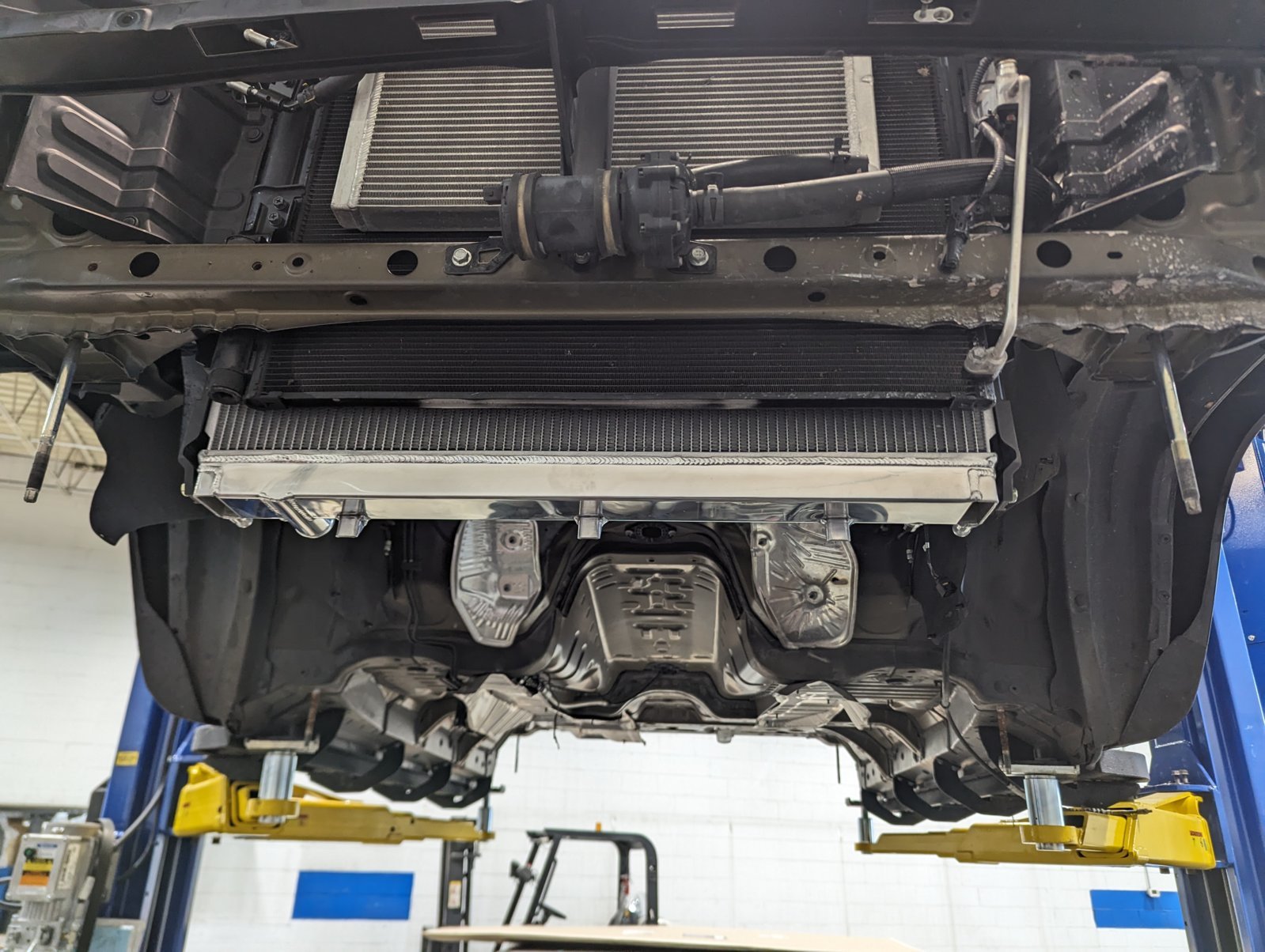

  5. Feb 19, 2024 at 9:54 AM
    #335
    Fastlane47
    Fastlane47 [OP] New Member
    Feb 1, 2021
    #58478
    616
    Maryland
    2018 Platinum
    22x12 Weld wheels, TRD Lowering kit, TRD Rear sway bar, Honey D Fenders, Corsa side exhaust with black tips, Magnuson supercharger, pedal commander. Lux hard cover, TRD PRO Grill, Kicker 10in Subwoofer, Viper remote start, paint match mirrors and door handles, LED tail lamps, G10 rhino lined running boards. 3m on front fenders, hood, roof and rear fenders. Stop Tech Big Brake Kit front and rear.
    PXL_20240220_160920545.jpg PXL_20240220_181808781.jpg Coming together. PXL_20240219_175336844.jpg
    I'm also glad I have a shinny radiator that you can't see, lol.

  6. Feb 19, 2024 at 12:19 PM
    #336
    reywcms
    reywcms New Member
    Dec 20, 2021
    #72040
    7,496
    Rey
    North Plains,Oregon
    2017 Tundra Platnium
    Too many mods to come
    Damn! I can’t wait to see the results

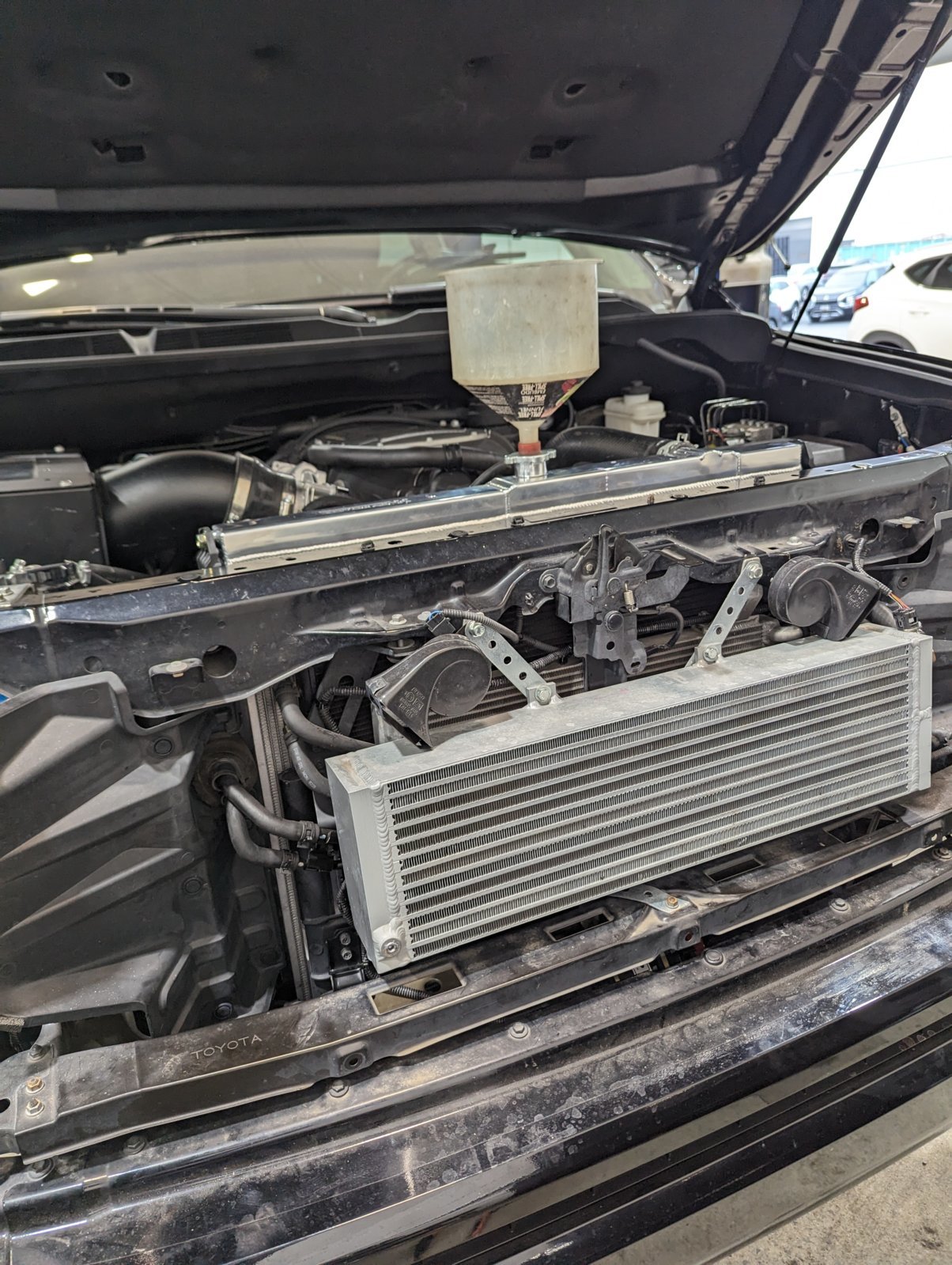

    Man, I'm jealous, what I wouldn't give for a day with a lift. You redoing your fuel lines, or just putting fire sleeve on them? Looking great!
    M3Tundra-JK and Fastlane47[OP] like this.
  11. Feb 22, 2024 at 3:16 PM
    #341
    Fastlane47
    Feb 1, 2021
    #58478
    616
    Maryland
    2018 Platinum
    The fuel lines are new, Prospeed fuel system.

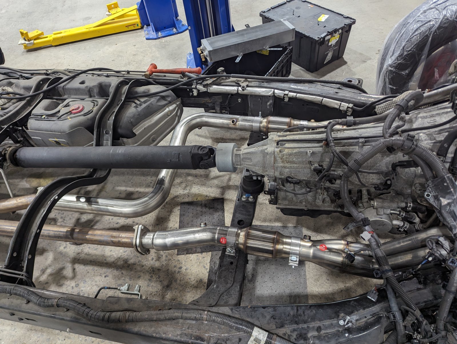

    Here is a full run down of this stage of the build.
    Built short block from XAT with ARP main studs.
    Ported and polished heads, installed BC valve springs and ARP head studs.
    Upgrade oil pump from XAT.
    XAT dampener with bigger crank pulley.
    @snivilous 2.0 supercharger pulley.
    Power Trax LSD.
    Stainless works long tune header's with high flow cats.
    Koyo Radiator.
    Misimoto Thermostat.
    ZZP high flow heat exchanger pump.
    Fingers crossed, the truck should be running tomorrow, just need to measure for a belt and put the body back on.

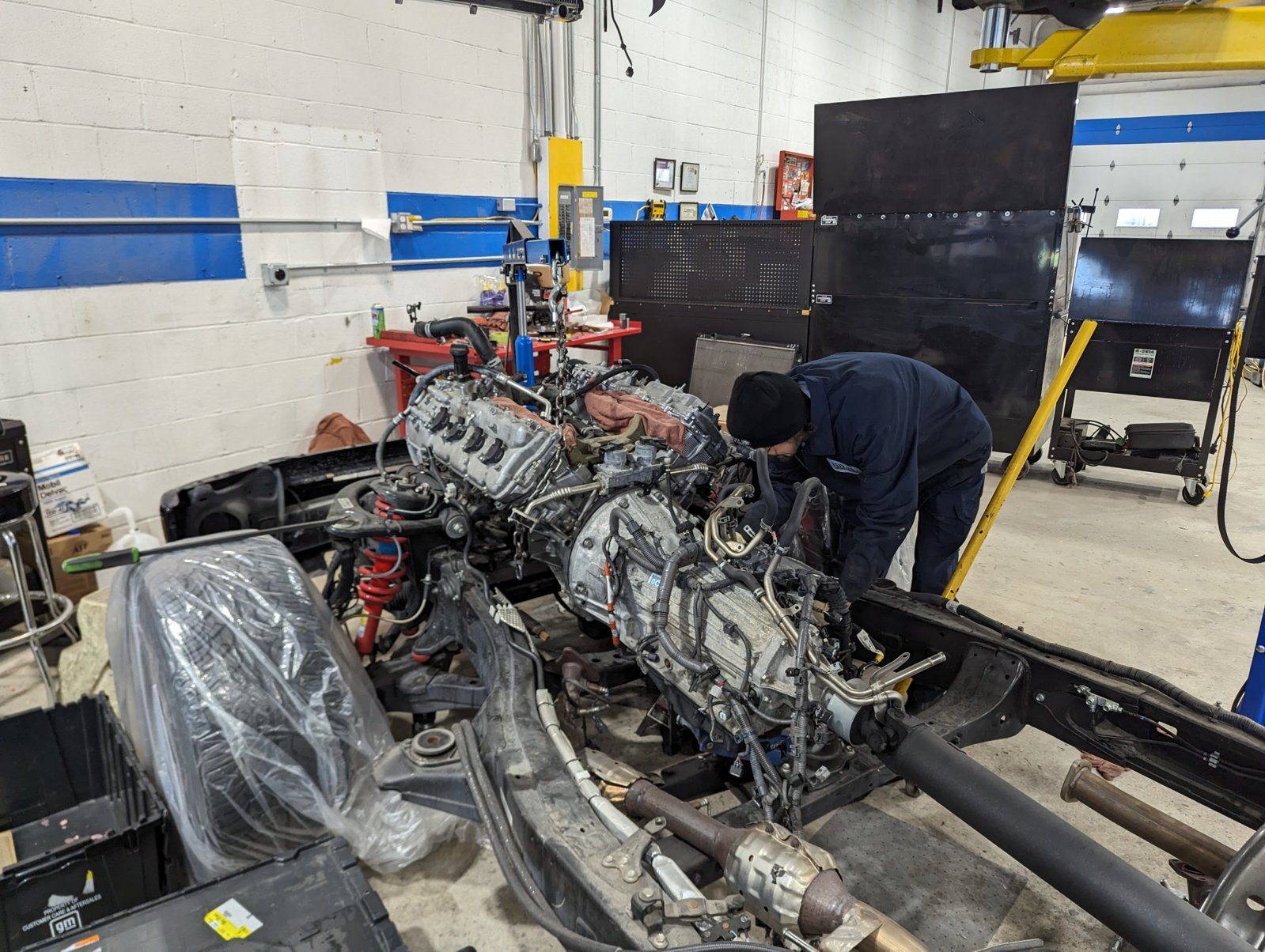

  14. Mar 1, 2024 at 5:00 PM
    #344
    Fastlane47
    Feb 1, 2021
    #58478
    616
    Maryland
    2018 Platinum
    One project coming to a completion, another project arrives.PXL_20240301_111921291.jpg PXL_20240301_112100831.jpg it's a 2018 AMG E63 Edition One. I think I'll start with a tune and an intake.

  16. Mar 6, 2024 at 8:58 AM
    #346
    Fastlane47
    Feb 1, 2021
    #58478
    616
    Maryland
    2018 Platinum

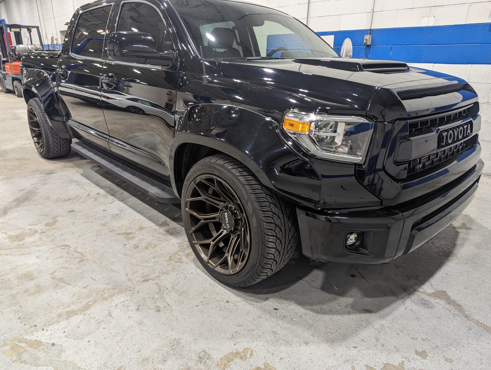

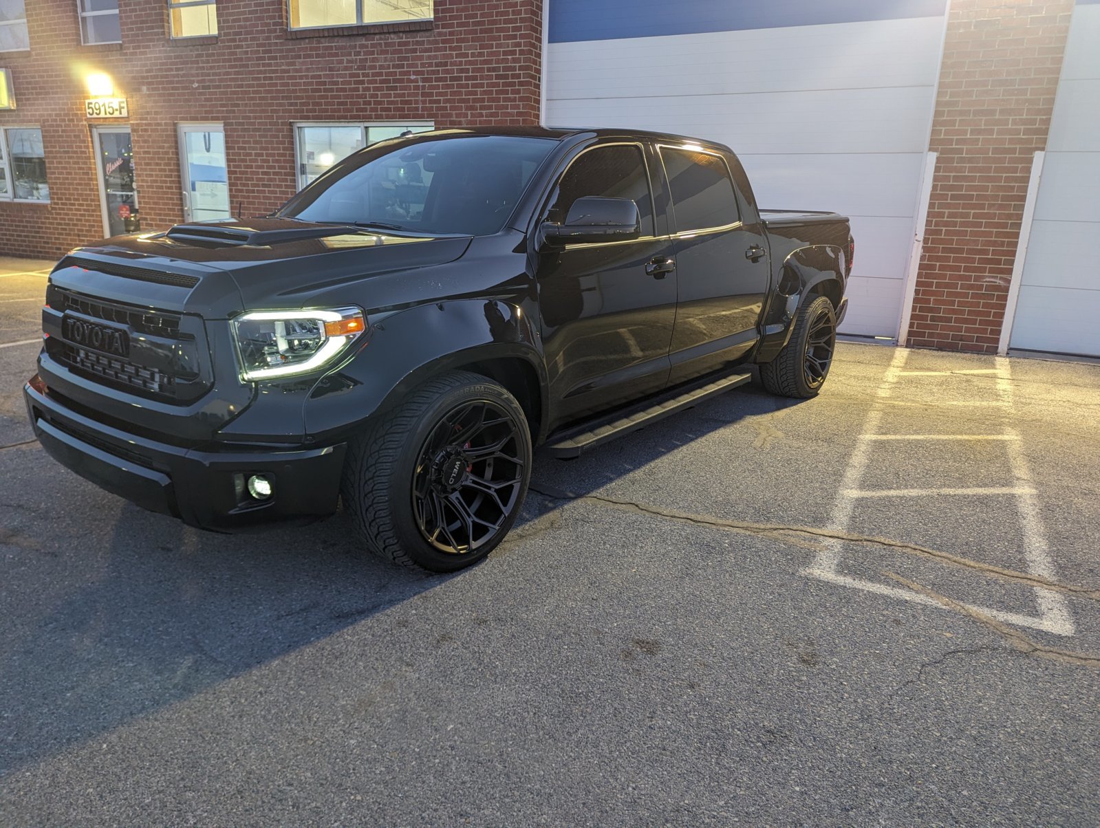

    I don’t know how I have managed to miss thread but damn. DAMN!
    That’s one hell of a build you have going on there.
    Fastlane47[OP] likes this.

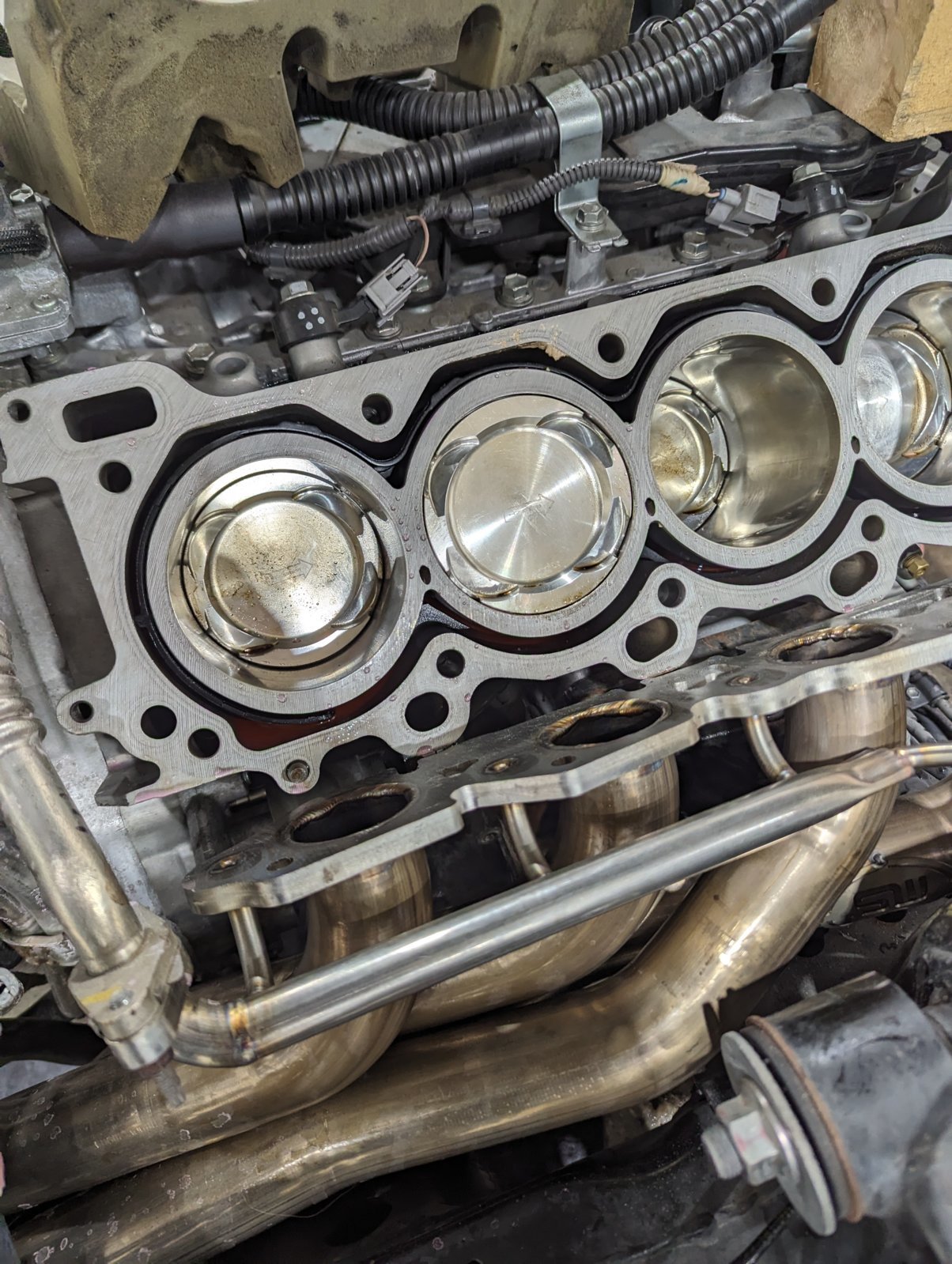

    Well, I spoke too soon. After letting the engine warm up we found coolant weeping on the outside of the heads. A pressure test confirmed it, not getting into the cylinders, just on the outside. Today we are removing the valve covers and re-tightening the head bolts to spec. Hopefully that's it. The block was resurfaced and so were the heads, so I know they are true and flat.

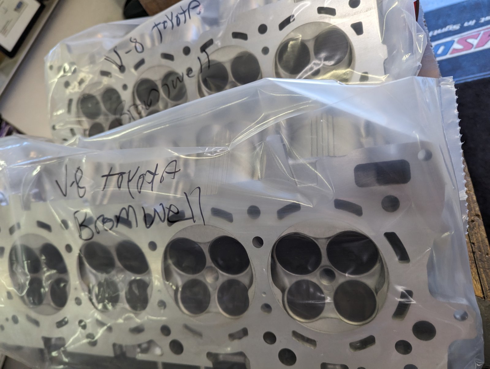

    Just in case, we are removing the heads and replacing the head gaskets and using a high temp sealant.

    All back together, we will do a final check Monday.

    Did you find the cause of the leak?

    So a few things I noticed, but in the end maybe it was the gaskets themselves. The block has vertical style groves in it from the way it was cleaned, I don't think that had and effect because we razor edged everything to make sure it was flat. The heads and the block and they are both flat, so the groves I don't think did anything. Second was that the head studs backed off to 90ft pds, we set them too 100 ft pds, and the truck only had two heat cycles, for a total of 45mins of running. Third, we didn't use any copper sealant on the first set of head gaskets, this new set we did. So fingers crossed, we are all good.

    If you zoom in you can see the groves. Again, I don't think it had anything to do with the leak.

    That block finish “appears” to be, well, very rough. Like, appropriate for an old cast iron block with a composite gasket type of finish. Kind of difficult to say with a single pic. MLS gaskets require a fairly nice finish… if you have further issues, look close at that.

    I thought the same thing, but the engine builder said it's normal, and when we checked it with a razor edge, it was flat.
