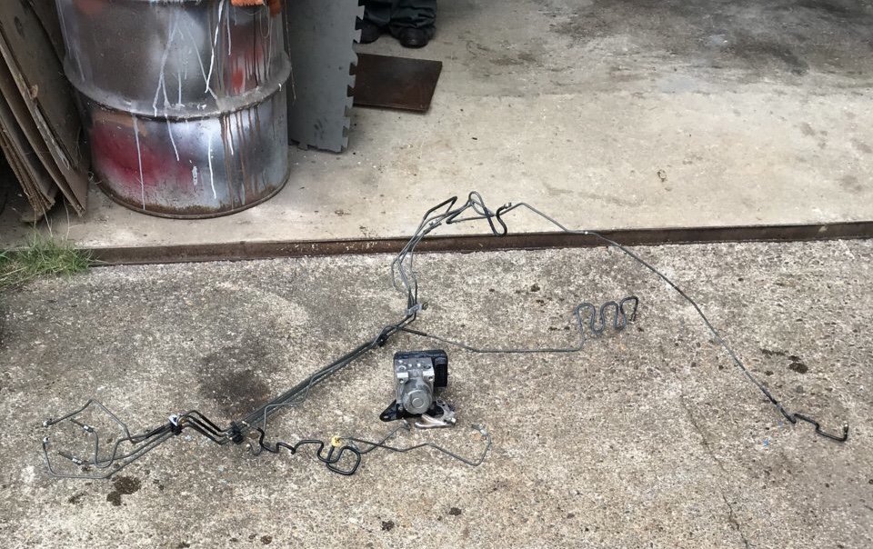

    As an update, i removed the ABS system from my 2004 AC. Since i also has a wrecked 2000 AC non-ABS parts truck, i performed a fairly clean conversion. I swapped over all the front hard lines off of the 2000 non-ABS truck over to the 2004. The hard lines have a threaded connection underneath the truck kinda near the rear of the front door. It was pretty simple to swap the hard lines since both had the factory bends in them. It would take a while lot longer, but it wouldn’t be too difficult to make and bend your own hard lines if you had to (i’ve plumbed completely new brake lines on a couple other vehicles that i own so i do have all the tools and experience though).
    On my 2004 AC ABS truck the speedometer gets the reading from the rear axle...from the ABS tone rings that are pressed onto the axle shafts so be exact.
    The front ABS wheel sensors don’t have anything to do with the speedometer. You can leave them in place or remove them (and the wires). But if you remove the sensors, you would have to go back and plug the sensor hole.
    The speedometer gets its signal from the ABS pump that’s located under the hood (the large silver and black box). So you MUST keep that plugged in, BUT you can remove the large silver aluminum pump that’s attached to the black plastic module. If you decide to separate the pump it will create a fairly amount of usable space in that area. You could mount a second battery or an air compressor in that same spot.
    I’ve been driving my 2004 tundra without ABS for about the past four months. I’ve been driving around in the snow and ice without any more or less issues than any other vehicle that doesn’t have ABS. The way the AC truck is balanced, it brakes in slippery conditions WAY better than any long bed single cab truck that i’ve owned (because of weight transfer). I’ve also towed LOTS of firewood while towing a trailer with LOTS of wood. No issues without having ABS there either.
    Obviously ABS is a safety benefit for 99% of drivers out there. It’s up to the end user to decide if it’s right for themselves. Also keep in mind that i also have removed the entire ABS systems from multiple KTM 990 Adventure bikes that i’ve owned. I also have a 2005 Scion xB that i HAVE left the ABS system in place, but i have installed a bypass switch that shuts off both the ABS and traction control. I live in an area where there’s ice, snow, lots of gravel roads, and my xB literally would try to self crash itself into a ditch with the traction control activated.

  13. Mar 5, 2024 at 11:54 AM
    #133
    whodatschrome
    whodatschrome New Member
    Sep 13, 2023
    #103882
    1,803
    North of North Plains, Oregon
    lots of dents
    To update my comment, i had to plug the black plastic portion of the ABS module back into my wire harness. The back half of the module (the large silver aluminum block) can be removed and left out of the vehicle though.
