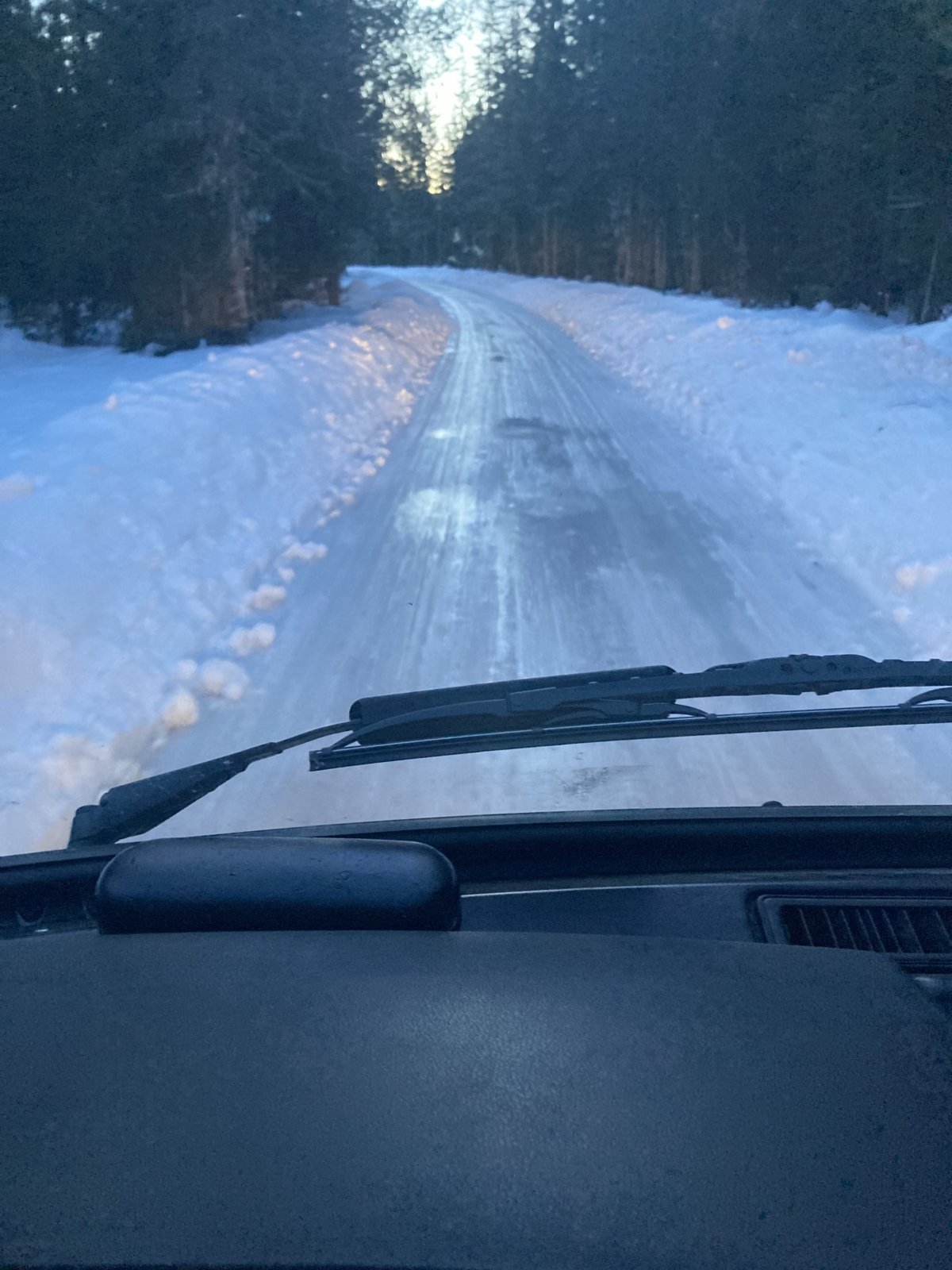

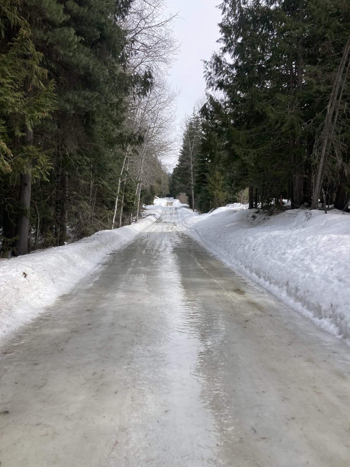

    jimf909
    jimf909 Battery almost dead...
    Jan 18, 2021
    #57786
    393
    Washington or Idaho
    '03 Tundra SR5 AC 4.7 TRD w/LSD
    Dead stock with oem 16" starfish wheels. We'll see how long that lasts. :) Topper of unknown origin.
    This is an interesting thread. I drive the 1 1/2 mile ice-road below daily in the winter (I can't leave or get home w/out driving it) and often test braking along the way and I've never experienced the problems described with my Tundra's abs (I'm not saying others haven't!). I'll try extra hard this coming winter.
