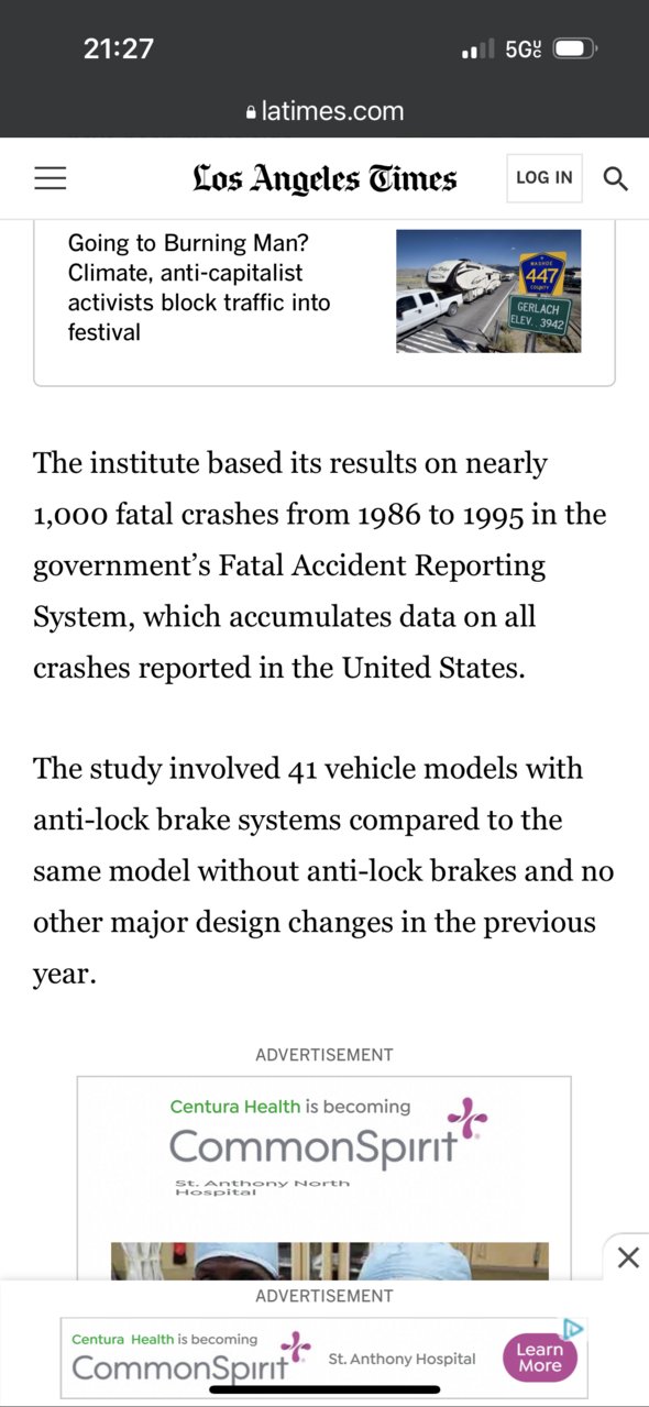

    So I took the bait. I opened up the LAtimes article.....
    1986-1995 study is a bit outdated.

    Except did you miss the embedded links above? Whatever the original intent behind ABS, the very bodies charged with administering such tech have figured out, it's not as safe as intended.
