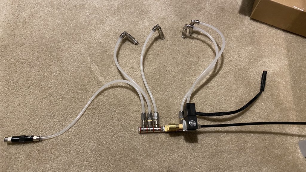

    I had the torqbyte version of this...fully tunable based off RPM and boost, rather than the standalone boost controller units. I preferred that setup simply because I didnt want the system coming on prior to being at a certain RPM and load range. Big turbo....took a while to spool.
    Snow Performance Stg 4 Boost Cooler Platinum Water Injection Kit
    Personal recommendation, which is contrary to the other controllers; I ran the pump at 100% duty cycle all the time (most pumps have an internal bypass which works fine...just replace the head every so often), and PWM the fast acting valve (aquamist valve).

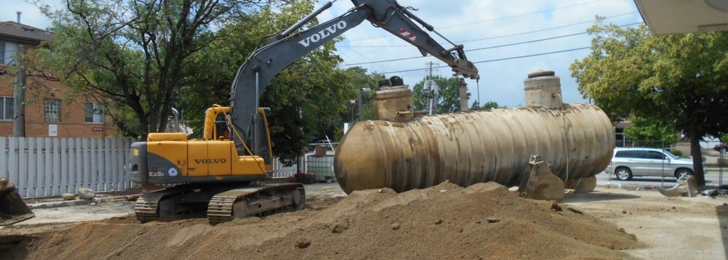

    top tier fuel and also station maintenance is very important before you get to octane.
    shitty stations with not the correct maintenance are to be avoided. slow pumps are indication of vapor leaks or clogged filters
    gasoline is very dirty with a lot of sediment in it, we remove UST systems all the time, you have to shovel out 55 gallon drums worth of shit in every tank. Here is one I was on years ago, just a little guy though, 6-8K

    :-o IT'S A VOLVO!!!11

    lol, yup
    they make some awesome excavators

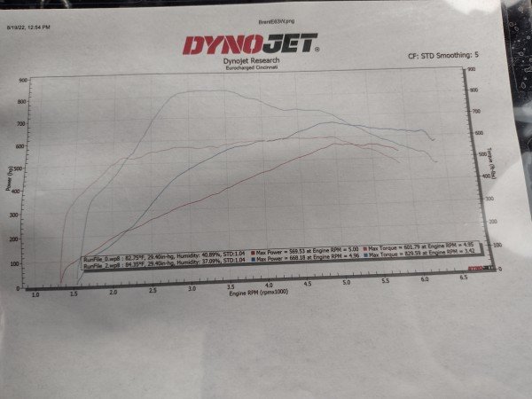

    Cool - I am going to chat with the folks who tuned the Merc's I had to see if they'd consider developing a tune and use my rig as test case... we did that for my C63 track car... and they did the E63 wagon.
    The E63 was incredible in how it took E40 with larger injectors and in intake and some minor other tweaks....
