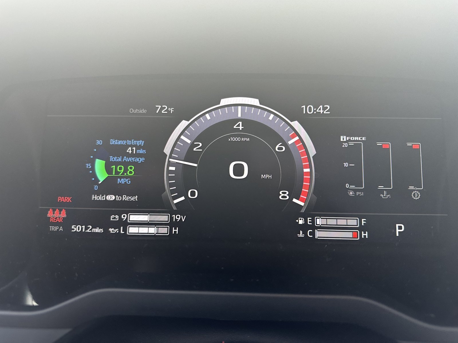

    I just did a trip to my sons college 470 miles each way. I drove like I always do on the highway 65-85 mph with no regard to fuel milage. I got 19.8 on ride there using premium (93) octane, and I got 19.3 using (87) octane on way home. If it helps I think on way home I was driving a little faster. Either way I was happy with that milage. On the down side, last weekend I did the same trip in my wife’s V8 Armada and got 19.1 there and 18.9 on ride home.

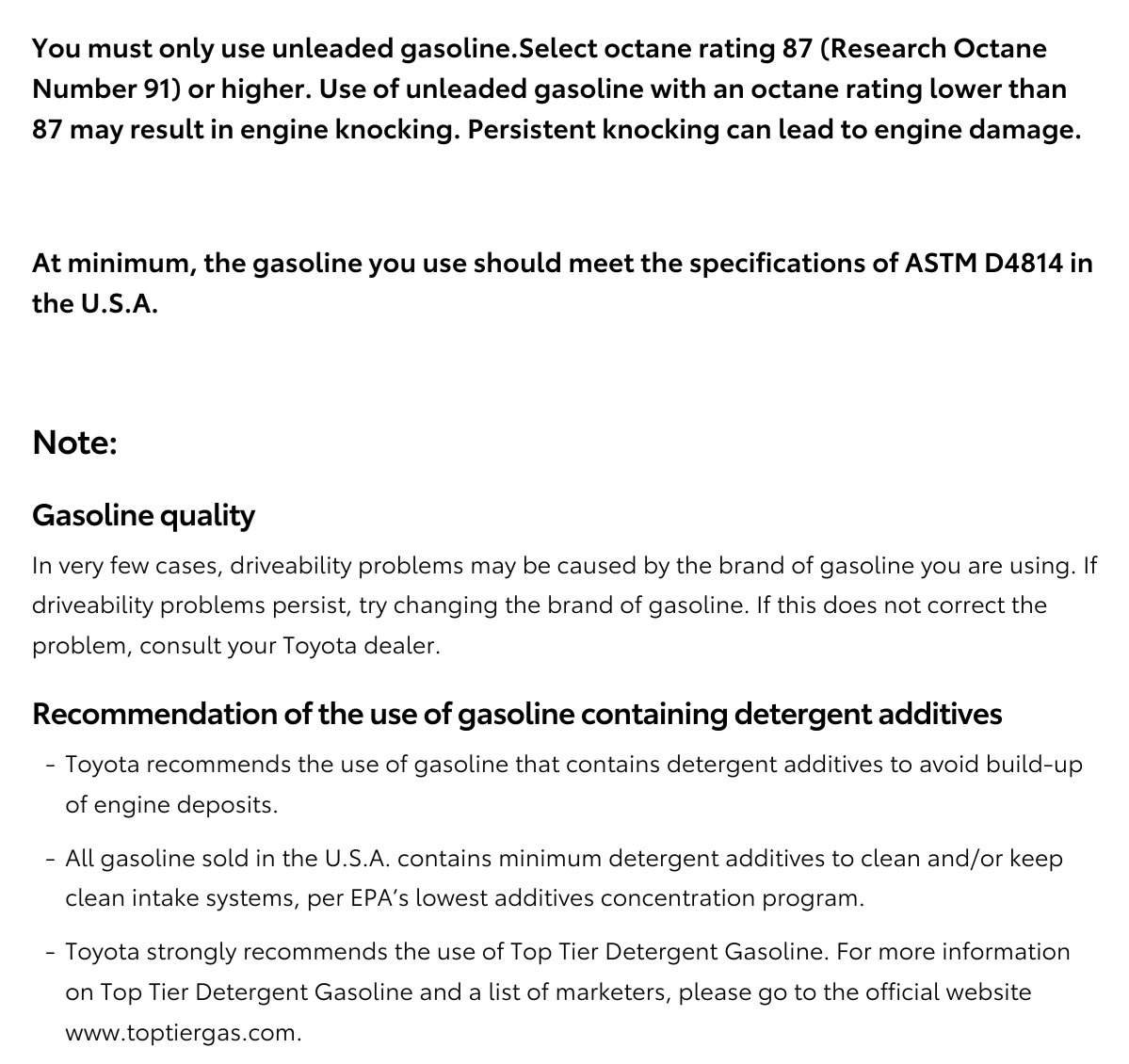

    According to the manual, the truck can take 87 and above, and a TopTier brand is recommended.
    https://www.toptiergas.com/fuel-stations/

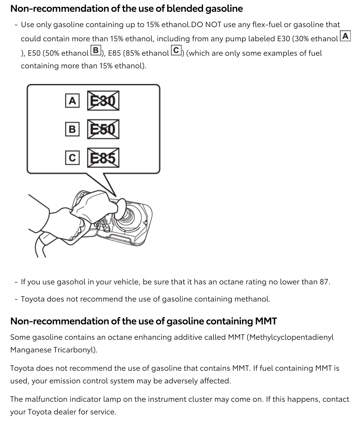

    The manual says it's important that ethanol stays below 15% (E15 or lower). The tundra is not designed to use FlexFuel.
    Alcohol can react with and corrode Aluminum at high temperatures, and the engine is largely made of aluminum.
    This is a technical report discussing it (not by Toyota)
    https://www.diva-portal.org/smash/get/diva2:720728/FULLTEXT01.pdf
