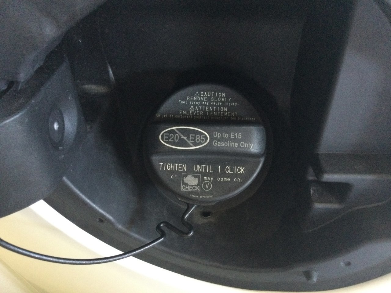

  20. Apr 25, 2023 at 3:54 PM
    #50
    Eagleye
    Eagleye New Member
    Aug 7, 2022
    #81680
    96
    22 SR5 4x4
    Rear seat cover, bed mat
    Pic of 22 Tundra Gas Cap
