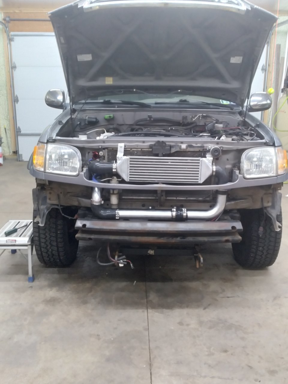

    I don't know about 40psi, I have a set of 12 hole injectors in it and have managed to keep it together for the last 4-5k miles at around 7-8 psi but I'm looking into getting a set of dirty deeds injectors and bigger fuel pump in the next check or two so far the weak link was the transmission on 2nd gear pretty much rounded it completely off Haha, besides that it runs like a scalded a** ape!!!
    But id surely say she has already come a long way since her near death experience.
    .tundra.jpg 301498808_8609926992366919_1299141890237129317_n.jpg 296380098_8503191383040481_7571170832949235714_n.jpg
