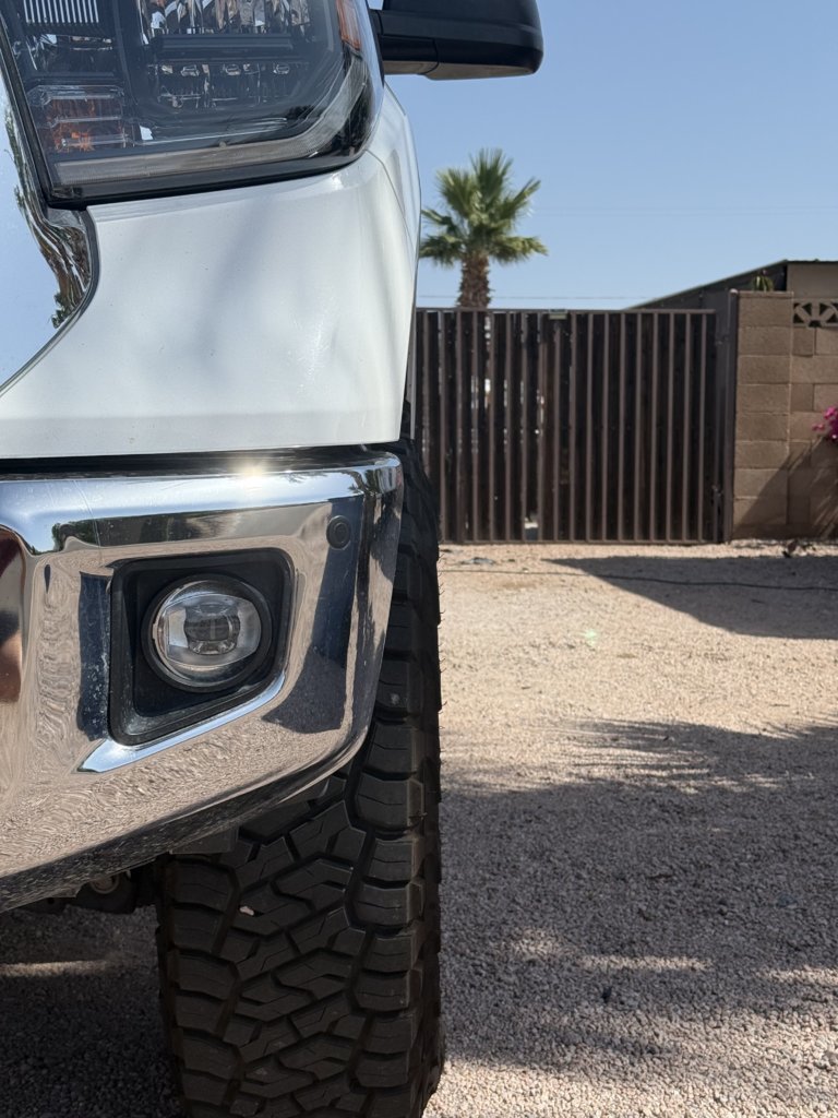

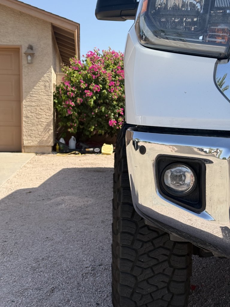

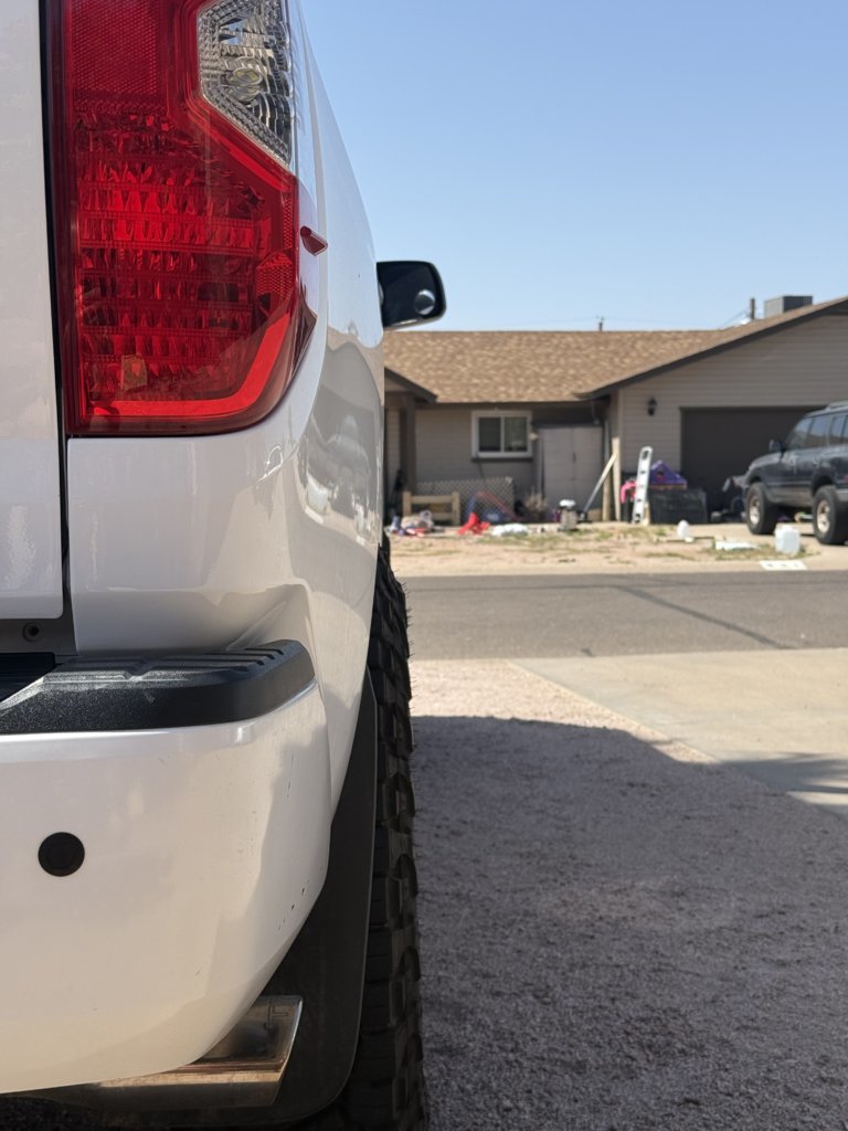

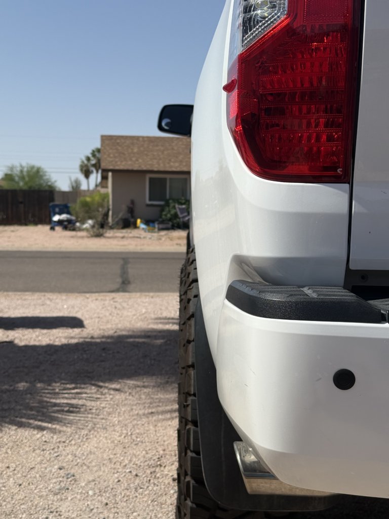

    Do you have a side shot pic to show poke? Did you do CB shims in the rear?
    No coachbuilder shackles in the rear.

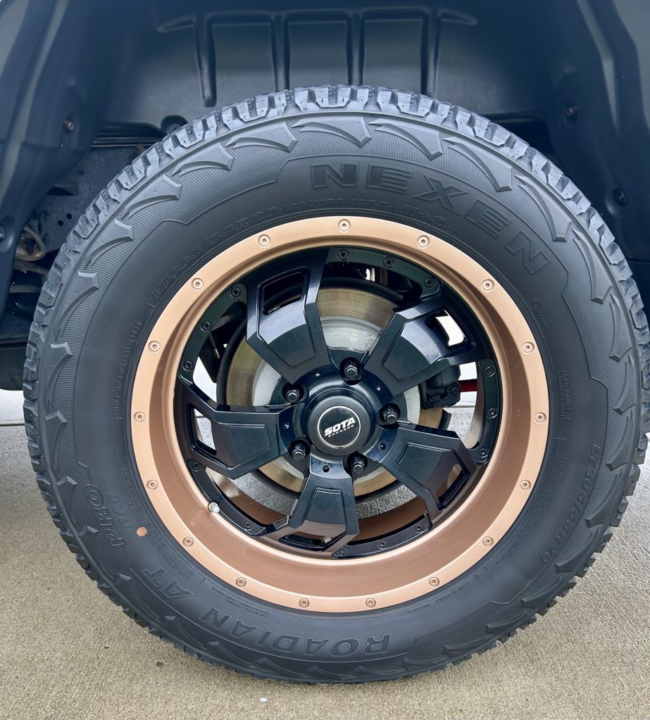

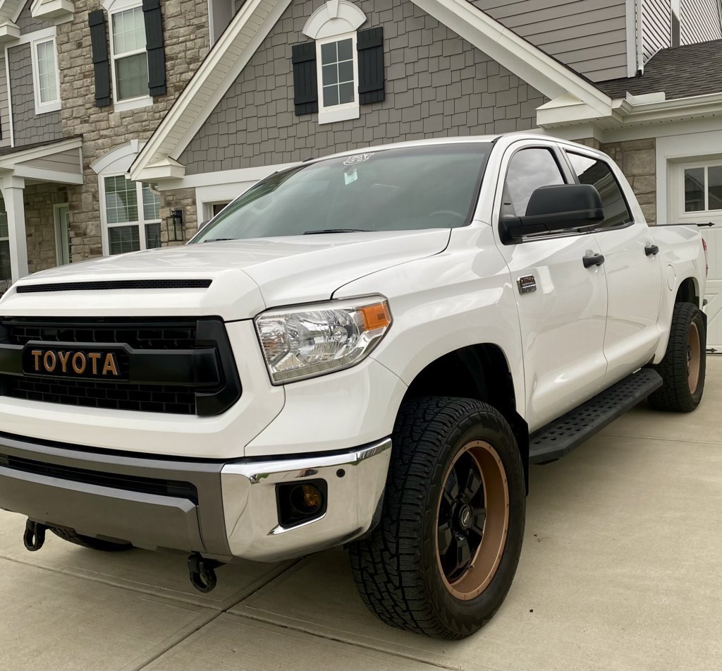

    Have had this setup for 3+ years and it is still going strong.
    Wheels are 20x12 custom powder coated to match the bronze of the 1794 badging with black centers.

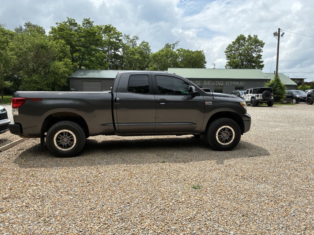

    2012 Rock Warrior. 6112 at 1.3" in the front, and 5100 at stock in the back.

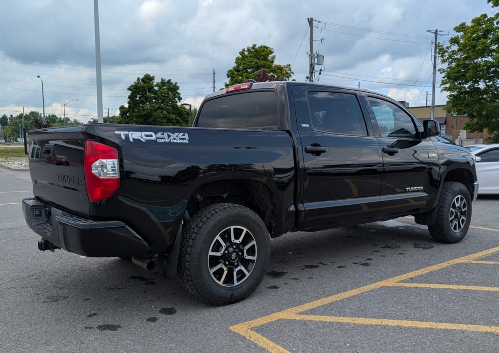

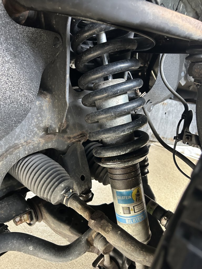

    Well, it took about the same time for the front shocks and upper control arms install as it did the rear 2" Coach Builder shackles.
    Drilled them leaf bushings out and sawzall the sleeves after 6 hours of a rust wall haha :canada:
    Two weekends all in while watching my 3 toddler boys in 98% humidity @ 104F. Water tables, kiddy pool, water guns, bikes and handing me tools I don't need and searching for the ones I did. :D
    Night and day ride difference as everyone has mentioned. My 2021 feels great minus the rear stock off road shocks. My wife might kick me out if I pull the trigger on rear 5100s as I've talked up the air bags and running boards for awhile now haha, never mind thinking of selling 275s for 295/70r18!
    Thanks all for the great info and a new hobby, cheers.
    275/70r18 Toyo AT3, 1.5" hub-centric spacers,
    Bilstein 6112 @1.9", two .5"CB shims driver, one passenger,
    2" CB Shackles, FLYCLE "cheap" upper control arms - Not bad!,
    stock trd off road rear bilstein shocks
