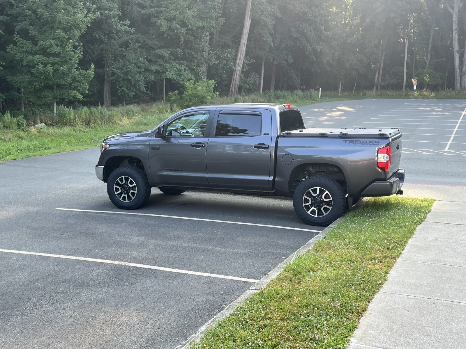

    After searching through the forums for almost a year (also just saving), here's my new set up! 6112 set at 2.5" and 5100s in the rear. The front sits a bit high but I will be getting rear shackles later this summer so I'm not too worried. 285/75/17 with 0 offset wheels, had to remove the front mudflap and liner.

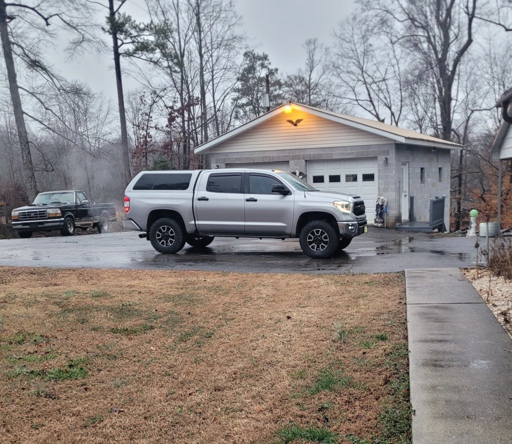

    Got the lift. 6112 top setting. 2 CB Shims
    Driver, 1 passenger. 5160 rear. Currently have 2” block as a place holder before a shop can install the CB+3 shackles. They didn’t have the right press for the bushings. Zone off road control arms. New 285/70/18 Toyo ATIII’s. 1.25” bora spacers. Wish I went larger, but saved some weight and didn’t want to mess with BMC. New rims in the future. Thank you @memario1214 and @Coachbuilder1 for answering my 1 million questions.

    1,016
    Man that looks fantastic! Great work.
    do you have hub to fender measurements by chance?

    Haven’t taken my post lift measurements. I’ll get to it this weekend. Thanks!

    Just measured. My post measurements were in a flatter area of my driveway. The pre were in a weird spot. Measured from bottom of the plastic hub cover. The tape sat their easily. About 1.5” to 1 5/8” from center of hub. Full tank of gas.
    Pre lift:
    FD:23
    FP:23 1/16
    RD: 25 1/2
    RP: 24 5/8
    Post lift:
    FD: 26 5/8
    FP: 26 5/8
    RD:27 5/8
    RP: 27 1/8
    So got the 3”+ in front. Should settle I hope. Shackles will knock a 1/4” off the back. Want to keep the rake. Rear passenger is a bit higher. Overall, happy with how even it is left to right. Debating keeping the blocks to not lose the 1/4” in the rear. But I’ve heard the CB shackle rides so much smoother. If anyone wants to chime in, I’m all ears.

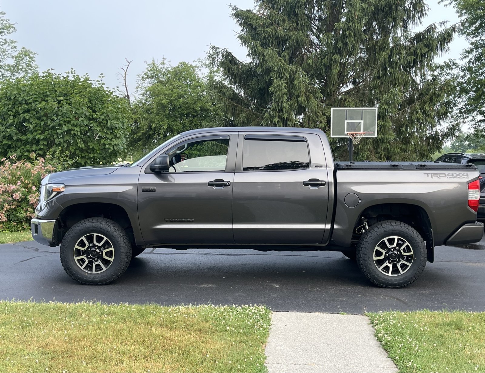

    Just installed my 6112 today, setting 2 (1.2") and a CB shim on the driver side. I know everything will settle but right now its nose high and I wanted to keep a slight rake, I know its going to settle some but on my short test drive all of the safety sense warning lights came on. I wondering if should set them at setting 1 (0.75') before I go get an alignment?

    How are you nose high? What type of truck (year, cab size, 2 wheel or 4 wheel drive) have you done anything to the back?
    Is this just visual or did you measure the front and rear? I just don't understand how you are high if you install things correctly and the front was at 1.2. I did mine at 1.9 with a driver side shim and it was pretty level.
    For the sensors, try disconnecting the battery for a few minutes. Otherwise, they should go away once you get an alignment.

    2019 Crewmax 4x4, haven’t measured yet. The truck douse have 150k miles i’m hoping the rear springs are not worn out! The rear is factory besides 5160 shocks!

    I don't have other advice. I'm a 2018 Crewman 4x4 and the 1.9 made me level. I added RAS in the rear to get back rake and to get its benefits.
    @memario1214 any idea how setting the 6112 at 1.2 made him nose high?

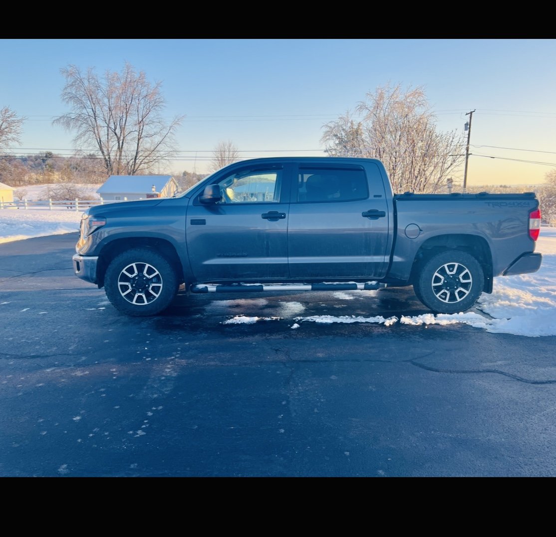

    Just for a bit more reference.
    Front 6112 at 1.3" lift
    Rear 5160 at stock ride height
    285/75-R17 Falken A/T4W on Rock Warrior wheels
    Biff's R, Oey12, equin and 5 others like this.

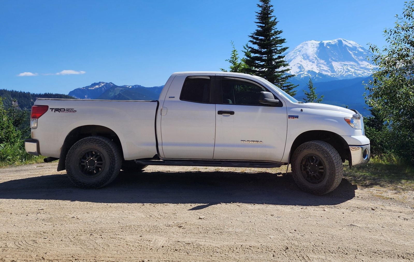

    Looks a lot like my Profile picture location :thumbsup: I'm at at 1.3" also

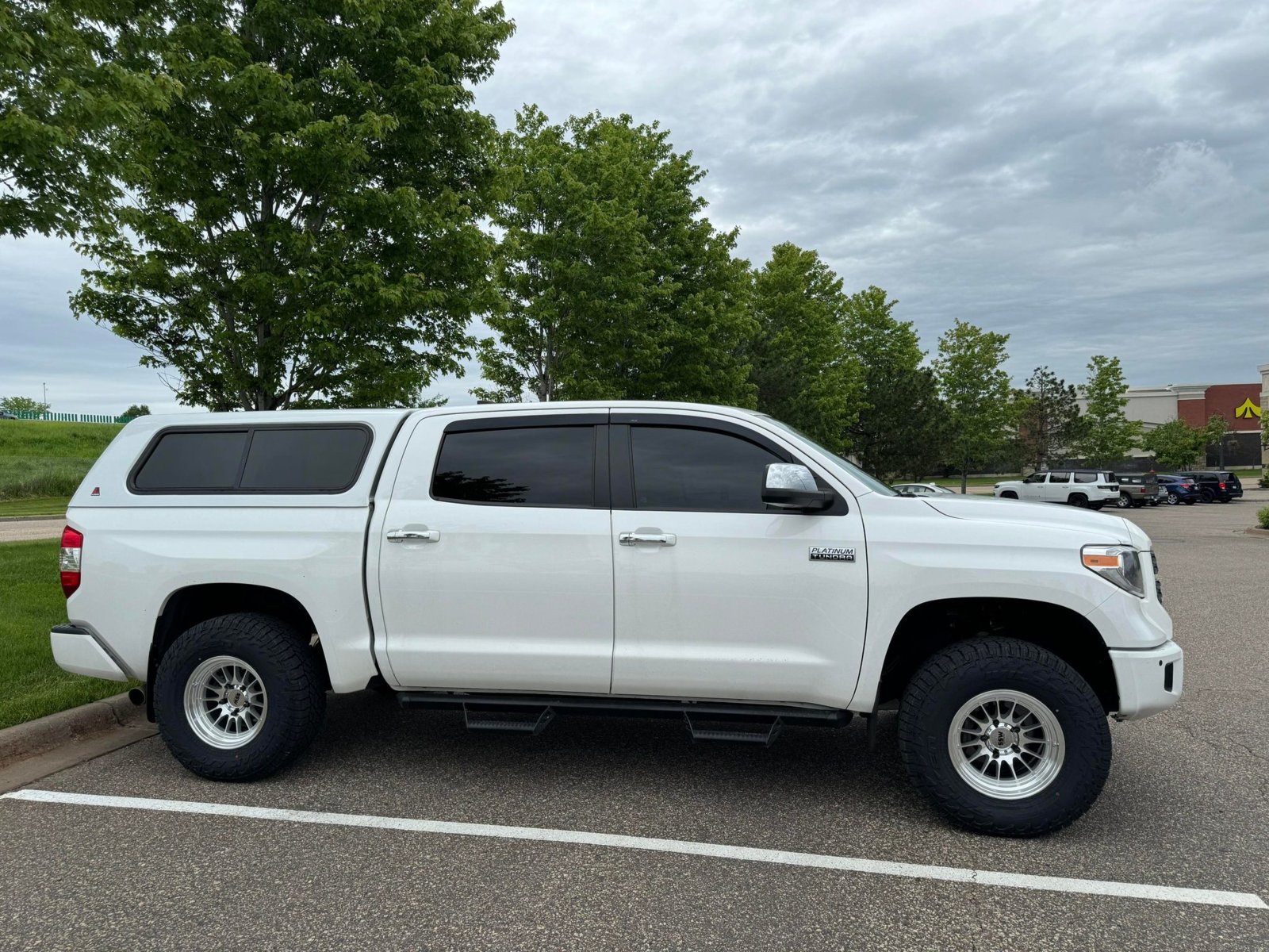

    2.5 Platinum OEM+
    6112 front on highest setting, no shims, camburg ucas
    5160 rear, deaver u748 & total chaos shackles
    method 703 (+35, 17"), toyo at3 35x11.5
    Mfanatic22, pvmike, equin and 7 others like this.

    Looks fantastic, I'm about to install very similar lift at 3rd notch. How much weight do you have in the bed with that camper?
  17. Nov 30, 2024 at 10:19 PM
    #2357
    rheosibal
    rheosibal New Member
    Mar 17, 2022
    #75949
    30
    2.5 Platinum OEM+
    Thanks!
    In the top photo, bed weight is likely around 1000 pounds = GFC Camper (~300lbs), Decked Drawers (~200lbs, empty), all the gear for 4 weeks of travel (~500lbs)
    In the bottom photo, bed weight is likely around 600 pounds = GFC, Decked, weekend's worth of gear
    The GFC and Decked Drawers live on the truck full time and the Deavers work great with variable weight. Minor differences in height and ride quality between fully loaded and completely empty.
