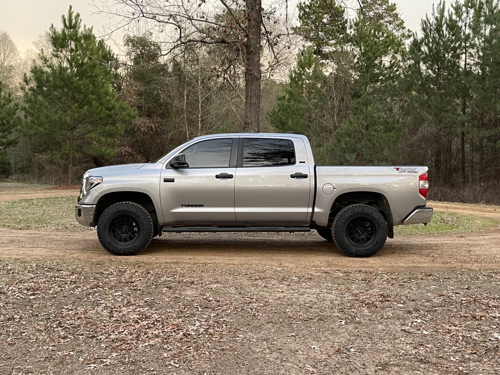

    When I initially had the 6112's installed at 1.9" I was running 275/70r18, I've replaced those with 295/70r18. No rubbing and no cutting required just had to take off the little flaps on the front bumper. Rear is factory height with 5160's.

    That's the beauty of positive offset! It'll sometimes allow you to squeak a slightly larger tire in places it might not otherwise fit. Still have good clearance at the UCA?

    It's very close but there's just enough clearance to work.

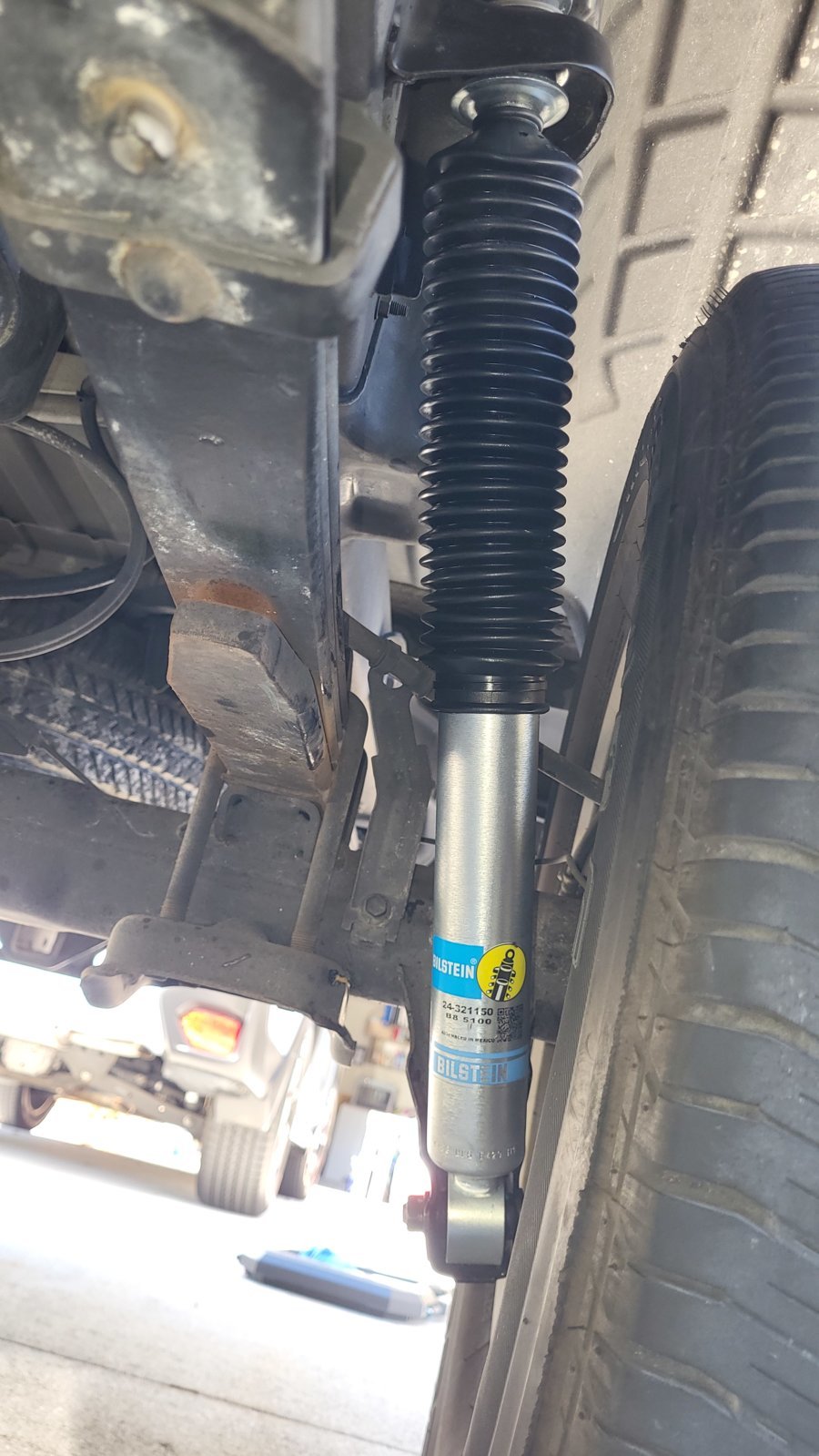

    2021 Tundra SR5 with Bilstein 6112 top setting, no shims. Rear has 5100 and shackles set on 1”. Method 703 +35 with Goodyear Duratrac RT 285/75R17. Thanks to Jeff at Excel Suspension. Really loving this setup so far and definitely rides better than stock!

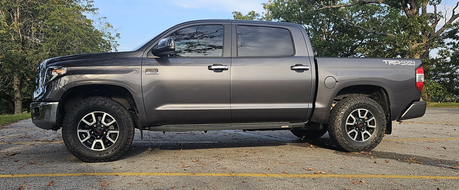

    6112/5160. 2/1 cb shim set up.
    Icon rxt option 2. Haven’t driven it yet so no settling but it should drop a bit.
    Rack/Decked so 280 bed weight currently.
    I failed to measure pre install. Anyone have a stock trd pro fox set up they could run some measurements on?

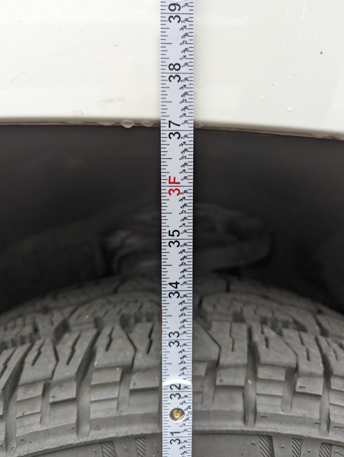

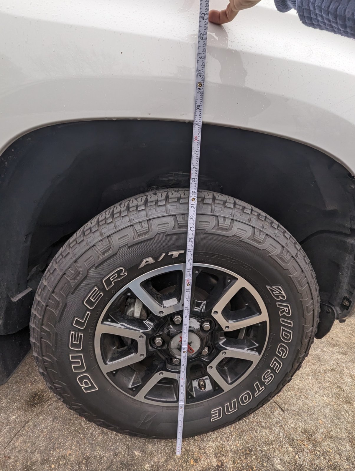

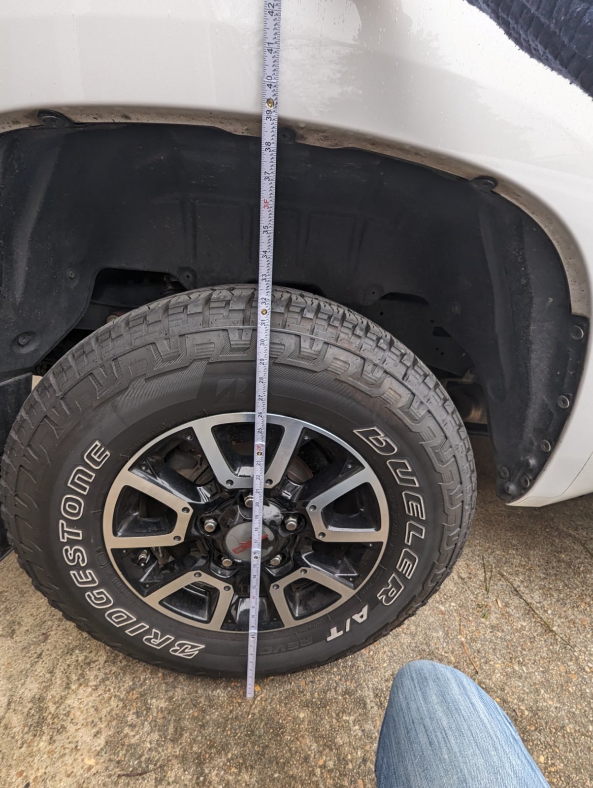

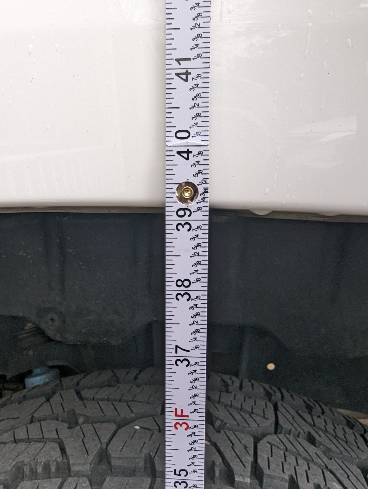

    I took some measurements before my stock replacement on a Crew Cab SR5
    PXL_20240116_165053425.jpg PXL_20240116_165100266.jpg PXL_20240116_165122799.jpg PXL_20240116_165129898.jpg

    thanks guys. I ended up at 40.5” in the front and 42.5” in the rear. On 275/70/18s
