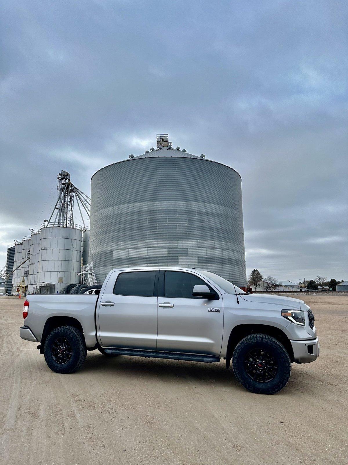

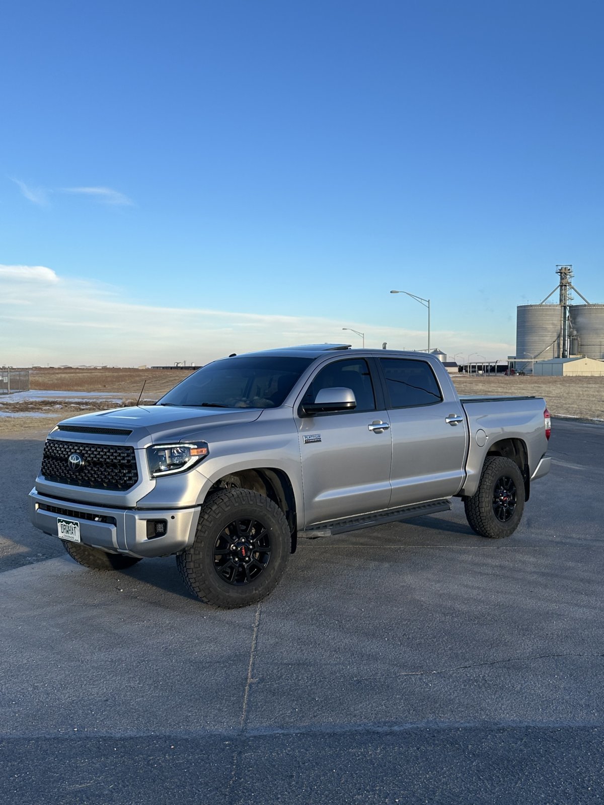

    @Skaufma0 The ride is considerably improved. It feels much smoother over bumpy asphalt and washboard dirt roads. It also feels less rigid than the stock Platinum suspension, better absorption and more cushioned feel without feeling sloppy. Handling feels as controlled as stock as well and it isn't sluggish at all on the 285x75's.
    @radon222 Thanks! I wanted to include all of my specs in one post, I spent too many hours searching the forum for what fits and what doesn't given lift, offset ect. Tons of good info on here though if you're willing to search for it. I actually have the small 26 gal tank (and I hate it), my rig had no driver side lean even with a full tank so I decided no shims for me.

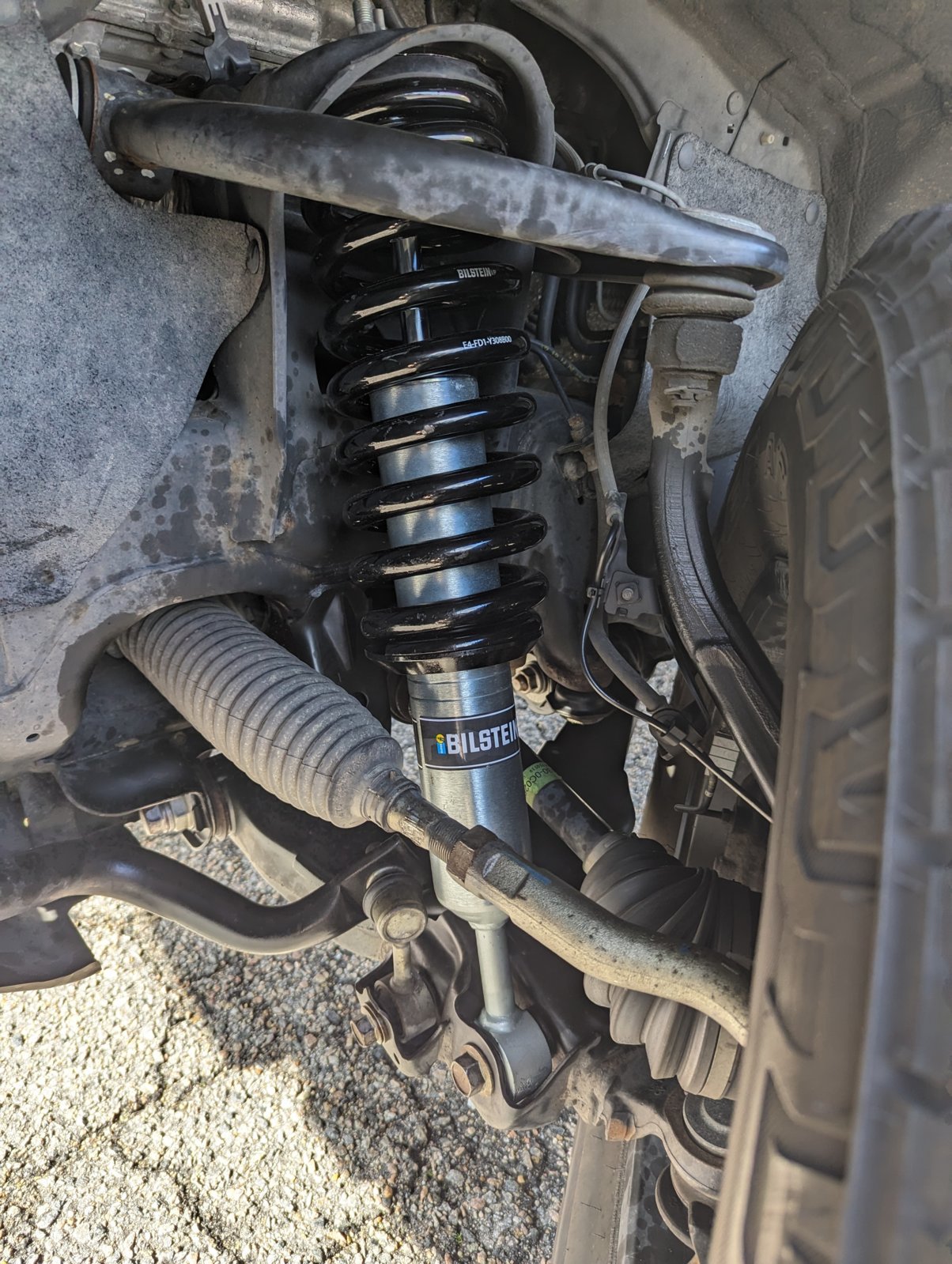

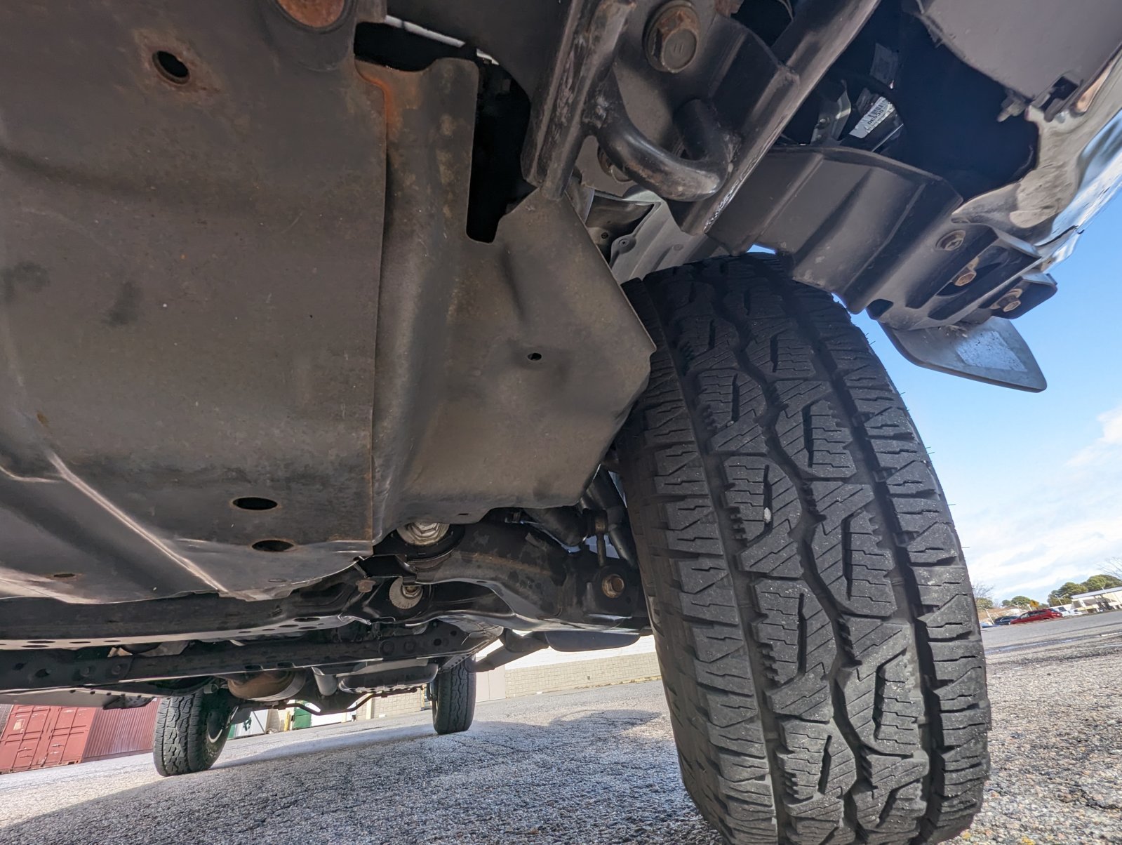

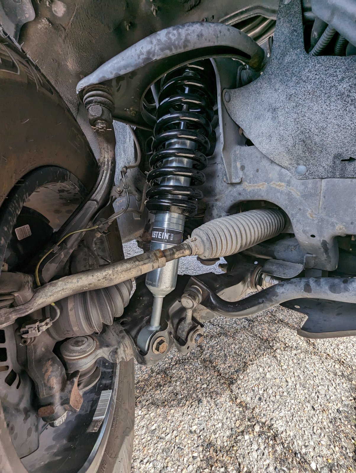

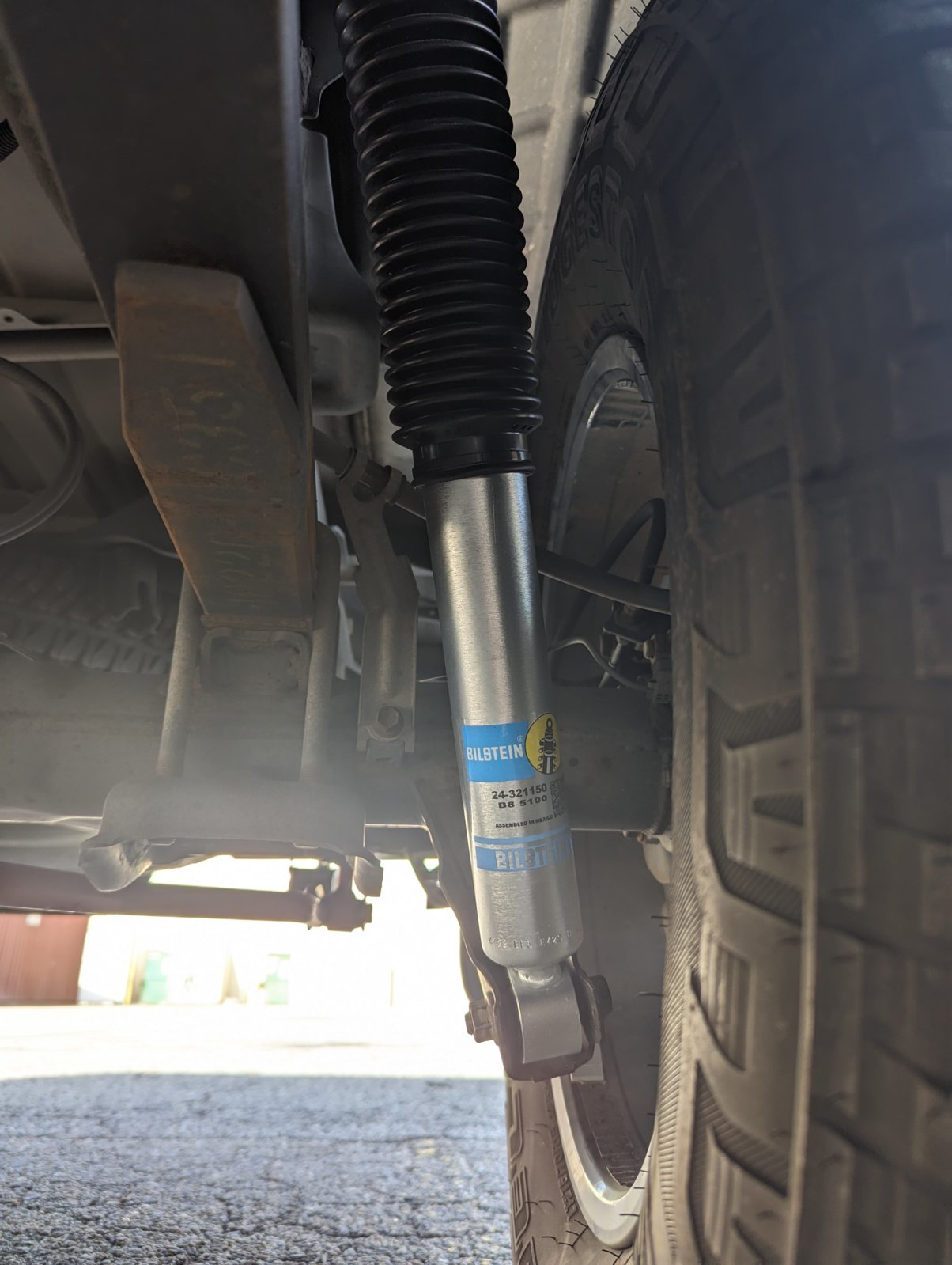

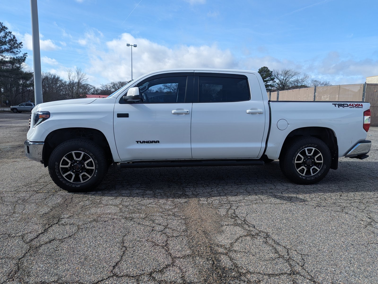

    After going back and forth for years and reading non-stop reviews (You guys are AWESOME), I finally was able to find a set of 6112 with the 5100 from ShocksSurplus.com during the Christmas season when they ran a small sale on the set. In comparison to not being able to find it on Amazon, I had them set the setting to #3, 1.9", and left the rear at stock height. From the look of it, it just leveled out the truck to make it sit even without a rake. This works for me due to the access to the bed and not having to get a ladder to get up there... LOL. I did have to put in a truck bed step to get up there.
    I went with the 5100 due to the lifetime warranty in comparison to the 5160 with only 90 days (I think). I figured I don't get to go off-road as often, so this would work best for my city/highway driving. I had my nephew put them on and do all the work; he works for Honda (not everyone is perfect), so he was able to use the shop to get it done.
    Issues: I had gone to Firestone to get it aligned (bought the lifetime alignment a while back) and to see what the noise of metal grinding is when I turn all the way left or right. They got it done, and it was off quite a bit, but they said the rub is coming from the skid plate. I had tried to turn the wheel both ways and do not see anything touching from the fender skirt or the metal skid plate under, but when I drive it slowly, it starts to grind. I wanted to find out from you guys if this really is the skid plate and if it needs to be cut, how much should I cut, and where?
    Overall: The ride is better than my stock shocks, and it takes on these stupid "speed bumps" on the VA roads like a champ. Roads are complete garbage here in the 757, and for some reason, they fix them only to be worse or deteriorate in a matter of months. Don't get me started on the Personal Property Tax and the shitty roads in VA. The ride is stiffer but not rough and feels more controlled and reactive to the steering wheel.
    My setup: 6112s @ 1.9, 5100 Rear @ Stock height, Stock UCA, Bridgestone DUELER A/T Revo 3 Sized 275/70R18.
    Attaching some pics below. PXL_20240126_161635725.jpg PXL_20240126_161726302.jpg PXL_20240126_161824016.jpg PXL_20240126_161839904.jpg PXL_20240126_161941370.jpg

    Rubbing the skid plate is pretty common and I think most just bend it out of the way.

    I never thought of just bending it out, thanks. I will see how far back it has to bend, maybe get the wife to help with the wheel and measure the gap needed.

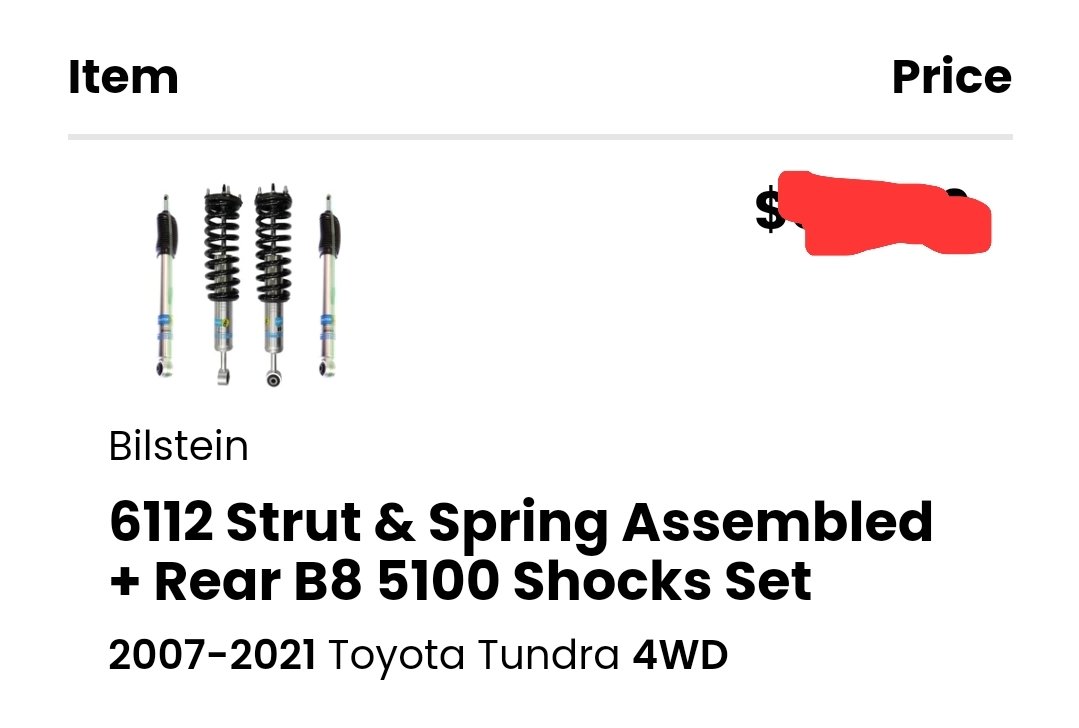

    Sooo am I good to go with this kit and a 275 70 18 on a 18x9 with an 18 offset???
    2018 SR5 Crewmax 4X4
    I'm ready to pull the trigger and don't want to mess it up. Are there any other parts that you would recommend??

    How high are you going in the front? I’m assuming you’re leaving the rear stock height? With those wheels offset and 275 size tire you may have slight rubbing at full lock, maybe.

    Get a hold of @memario1214 . He owns Hotshot Offroad and is a member here. He can take care of you.

    I am going to get them with the #3 setting which is 1.9"

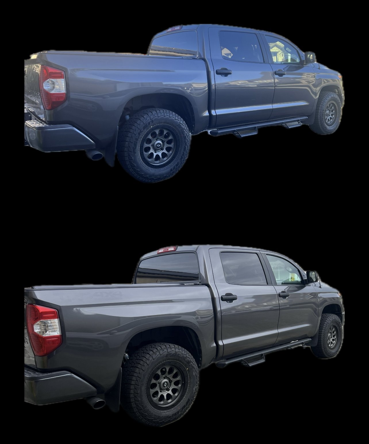

    Finally installed my set up. I went with 1.9 in front with stock height in the back. 275/70/18 wild peaks. Tires look too small now

    What size wheels and offset are you running?

    im running 18s +25 offset

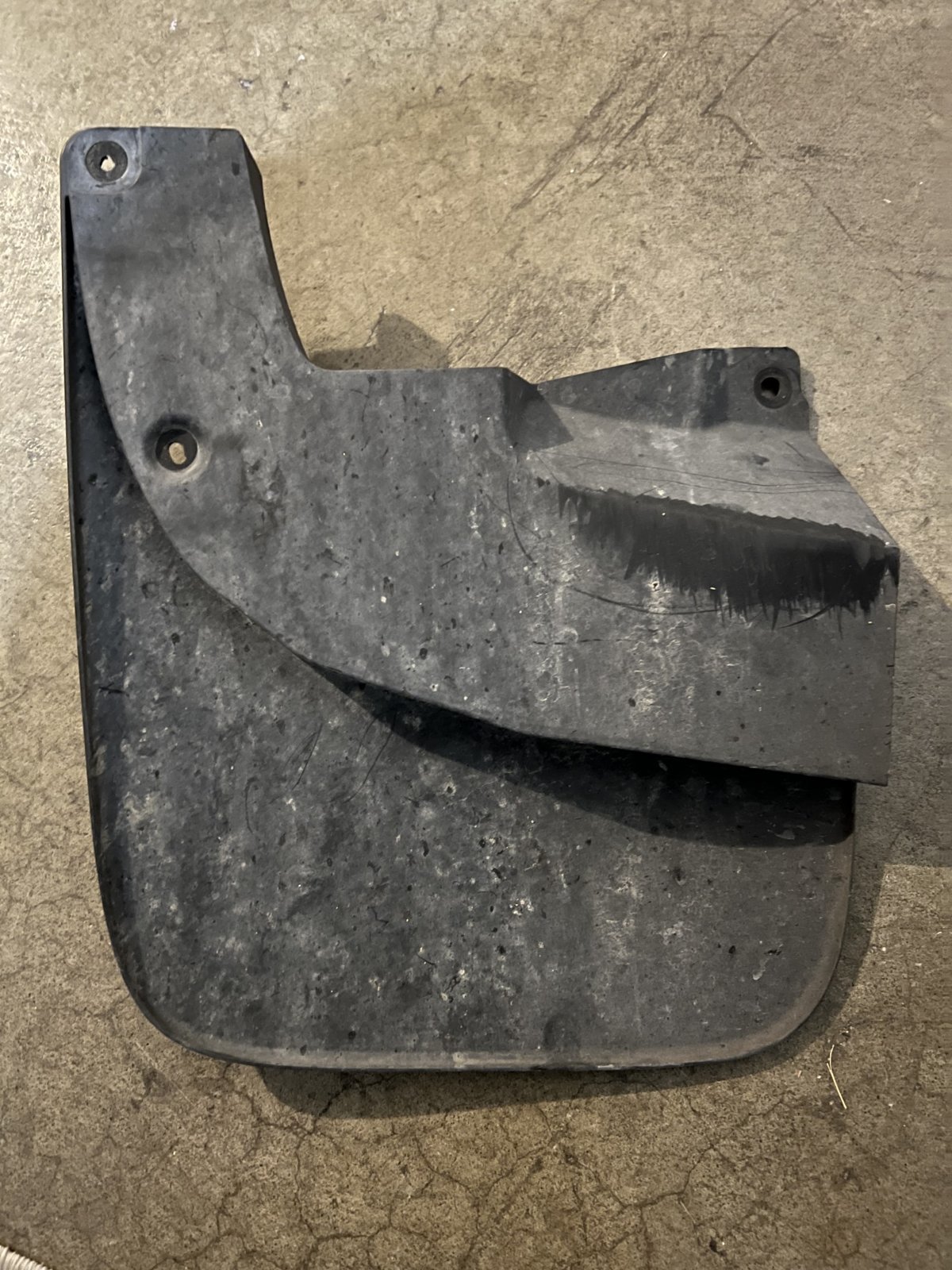

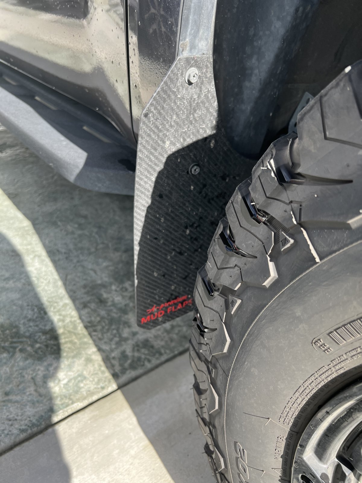

    I ran 275/70-18 with 15 offset, that factory mud flap hump is sticking so far out there’s no way around it, either cut it out, remove it or just get a new universal mud flaps that are flat.
    Just need to spend some time to make a bracket and buy some body panels plastic clips to make it work.

    Found my stock mud flap, you could still see the rub marks

    If you haven't pulled the trigger yet we have those guys over here at Hotshot Offroad, and are happy to price match as well as assemble. What I would probably recommend as well is a small carrier bearing drop as well to eliminate stop/go driveline vibrations. We could get you one of those for like $20.
