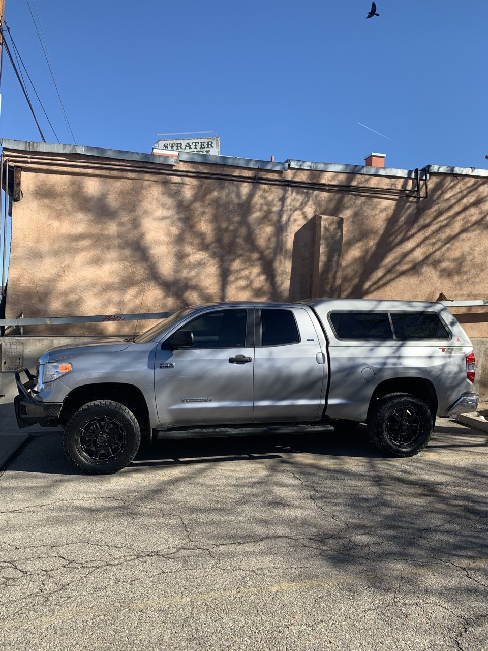

    I did 1.9 for a few reasons.
    I did a 2in shackle in the back and wanted to keep a slight rake for the TSS sensors.
    Also, I hear that the ride can be rougher at 2.5.

    So after reading 56 pages here I am a little surprised I don’t believe I saw anyone using full replacement leaf packs in conjunction with 6112?
    Well maybe I’ve done this all wrong but here is what is sitting in my garage currently to be installed:
    6112/5160(can’t decide between 1.9 or 2.5)
    OME full leaf packs(2.5” of lift est)
    JBA UCA’s
    I bought this truck a few weeks ago and it already had an old man emu lift. After some research I found it has their heavy duty front springs and a 1.5” block in the back making for a stiff and clunky ride. Also it’s crazy tall!
    OME 613 and 1.5” block measurements:
    DF: 25.5
    PF: 26
    DR: 25.25
    PR: 25.5
    Help! Do I set the new 6112’s at 1.9 or 2.5 coming from apx 4” of lift!? Like I said the new leaf packs should bring the rear up an inch from where it is.
    GreatWhiteGax, pvn.beluga and equin like this.

    You might want to double check the 5160s will work with 2.5” of rear lift. I thought they were good for up to 1” to 1.5” of rear lift, but I could be wrong about that.
    Anyway, nice silver double cab!

    Ah shoot you are right, I honestly didn’t even think about it! Well I can reuse the OME shocks that are on it and at the most they have 50k miles on them as that’s what the truck has. Thanks! I want to keep it looking nearly as nice as it does but ride and off-road articulation is more important to me than looks.
    equin[QUOTED] likes this.

    You might want to call Bilstein and ask if they have another 5160 or even a 5100 application for another vehicle that might fit for 2.5” of lift if you want to keep all corners of the same make, but the OMEs sound like they’ll work.

    I’ve got 2.125-2.25 rear with 5100s and they don’t top out.
    They did with 3.25
    equin likes this.

    That’s really good to know they work with 2-2 1/4” lift cause I will be using it off-road a fair amount. Thanks everyone, I will give the 5160’s a chance and see how it goes. Will post back when I get the 6112’s and leaf packs on. Thinking 1.9” front for comfort and suspension travel but most likely change my mind 10 times
