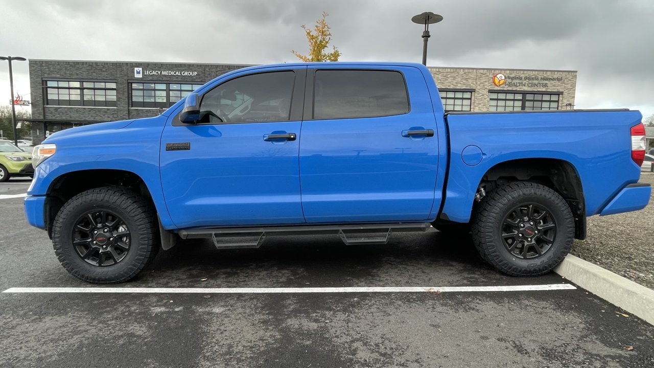

    Got my 285/70R18 Nitto EXO Grappler AWTs installed today!
    Bilstein 6112s up front set at 1.9”
    Bilstein 5160s in the back
    Toytec adjustable shackles in the back set at 1.5”
    No rubbing so far today driving around town, but it’s a tight fit!

    Ever so slightly more noise up to 45 mph. Not really any more noticeable tire noise at highway speeds compared to 45 mph. More planted feeling in the throttle response due to the heavier tires, but I like that more planted feeling. The stock tires felt a bit squirrelly. Sidewall profile is more square which is felt a bit in turns, but these are brand new with 40 miles on them and that edge may round some with use. We’ll see how I feel about them over time.
    Most importantly, truck looks better with them AND has much better traction and load rating!

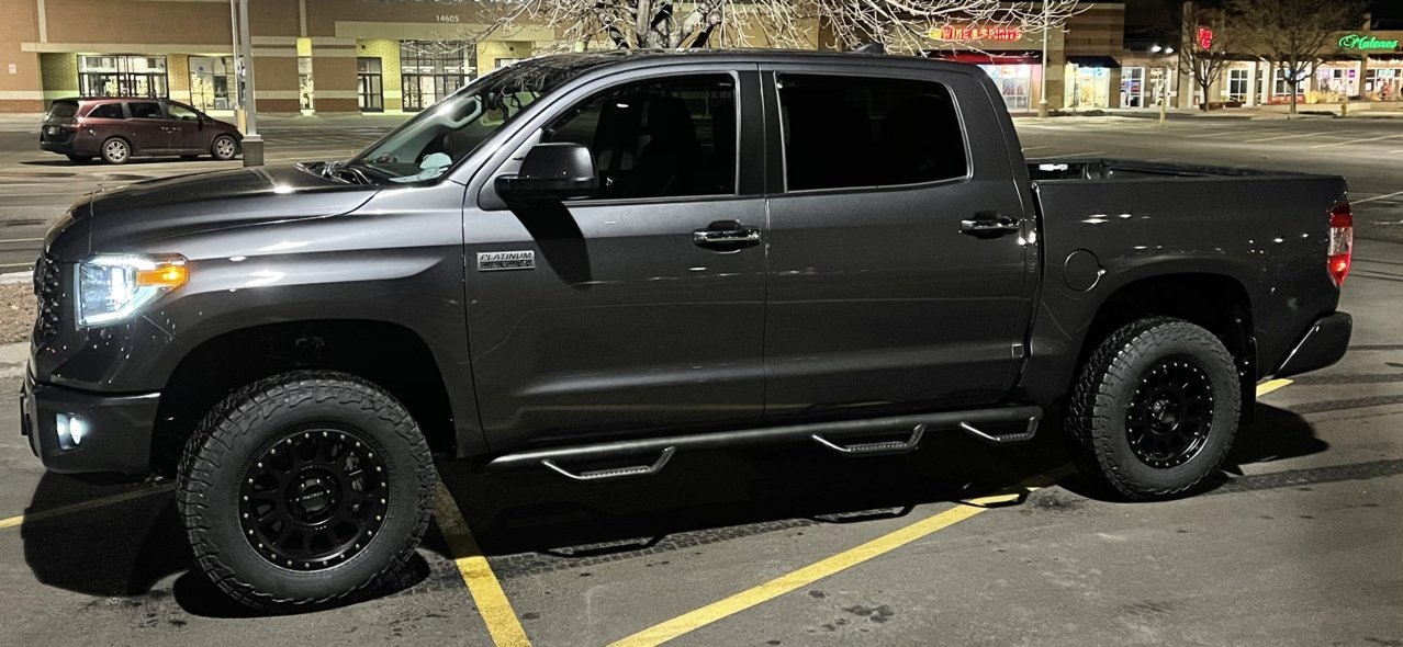

    No, sorry, I made a type. 275/70/18.

    Wow. Sorry for the typo. These are actually 275/70/18. NOT 285s. My b. All came out great.

    No worries man. The 275/70/18 doesnt look too small with your setup. Do you have any daytime pics?

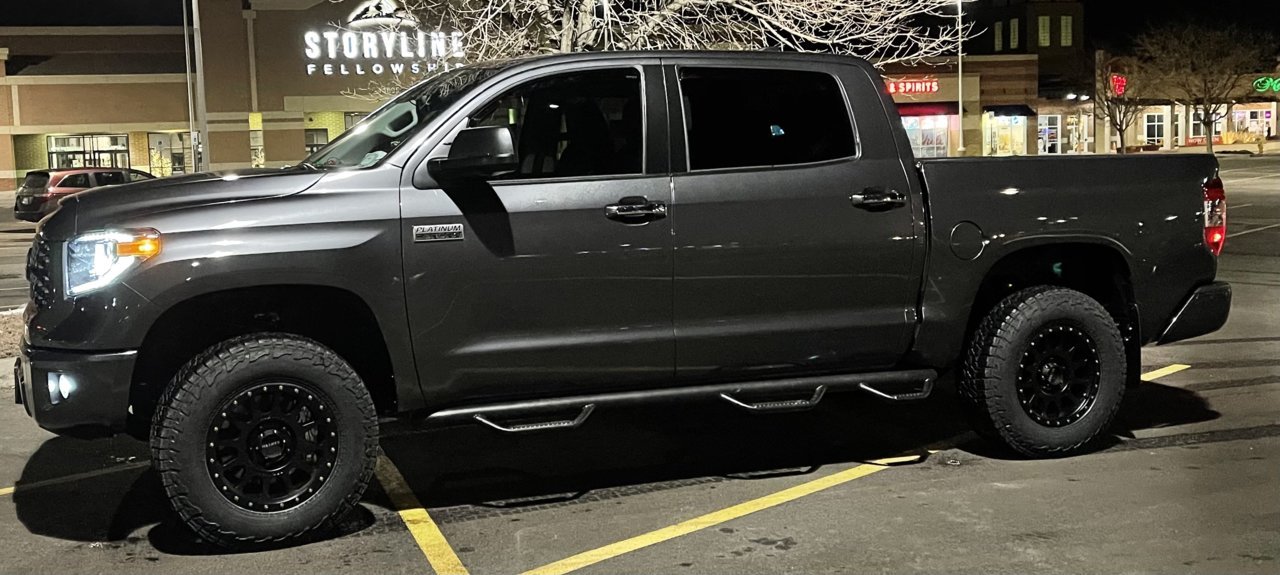

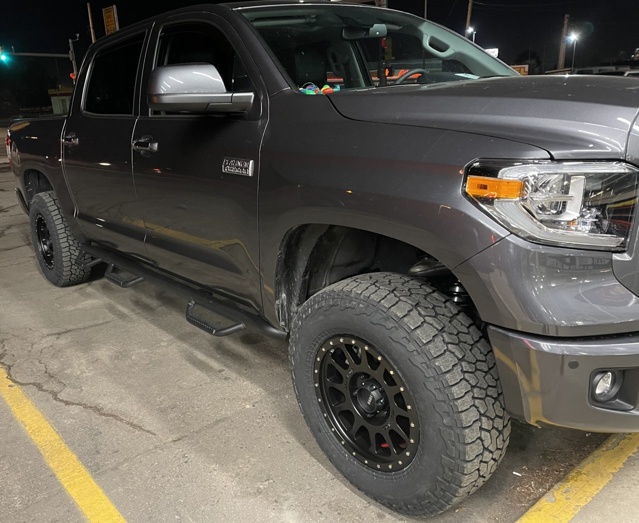

    Some more pics of the final product. Thanks again to everyone on this thread.

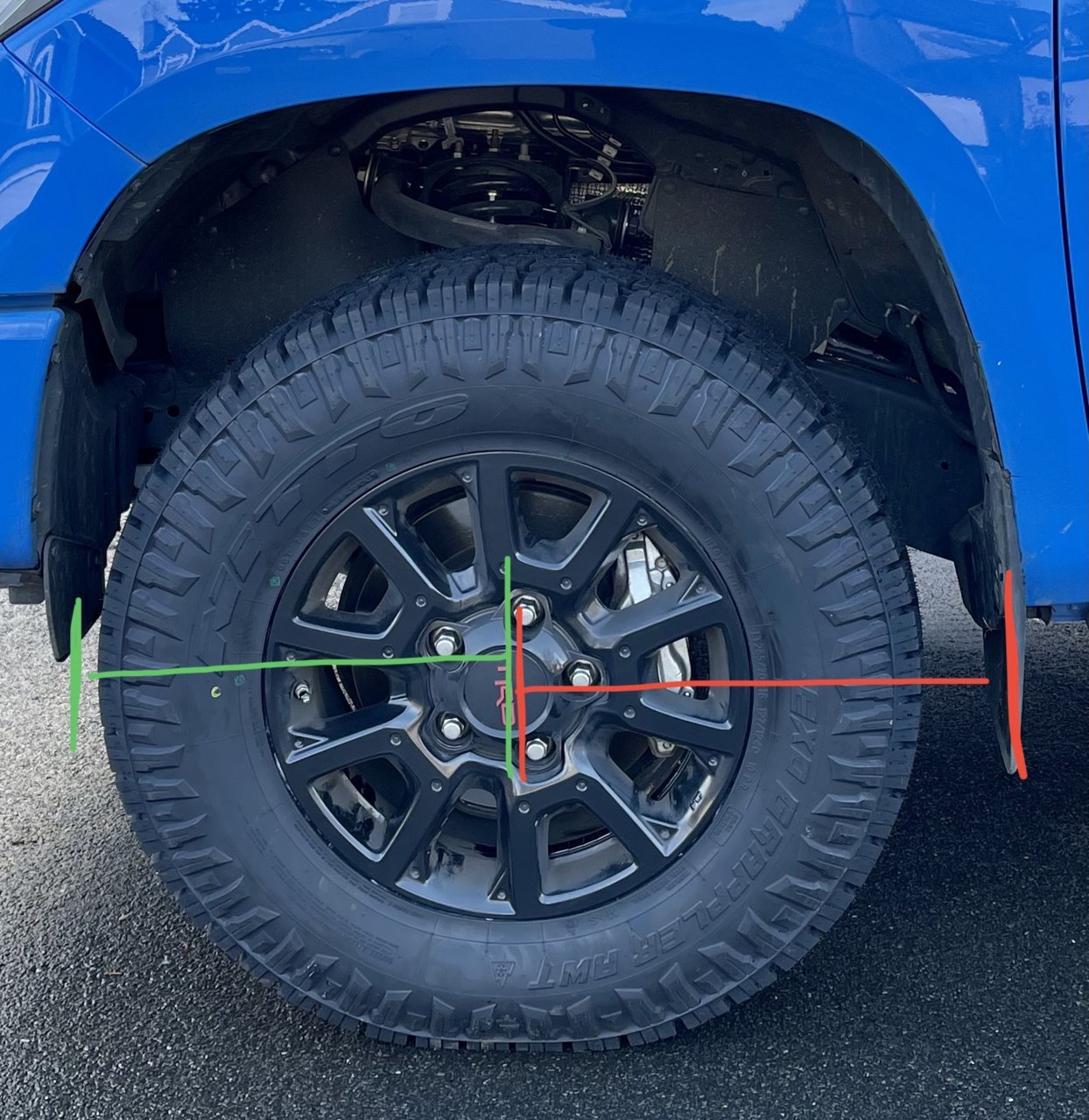

    Center to front fender (green) = 18.75”
    Center to back fender (red) = 20.125”

    Looks like you have a tiny bit of rake. Have you measured? I have a topper and well and debating the +2/+3

    Par k on level flat ground, Center of hub to fender. Check all four corners and compare.

    In this scenario the front tire is the limiting factor. The rear has more clearance and does not steer. I measured front left and front right to get an average for my post above.

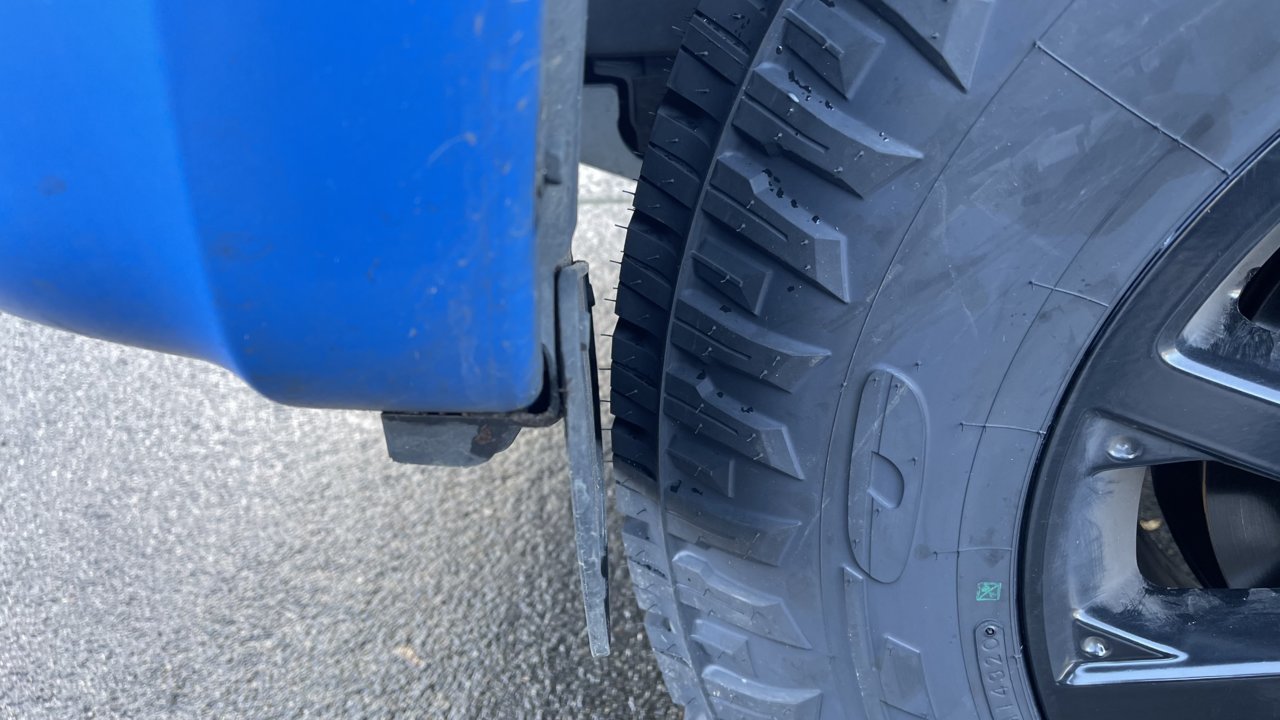

    The clearance to the front fenders with the small mud flaps is tight when steering.
    I figure I can always remove the small mud flaps in front of the front tires if I see any signs of rubbing. Those flaps are fairly thick, so removal will give at least another 1/4-1/2” of clearance. I also currently do not have any shims on either driver or passenger side, so I could add some CB shims to bring both sides up a bit if needed.
    So far no rubbing issues, but I will continue to keep my eyes/ears peeled.
