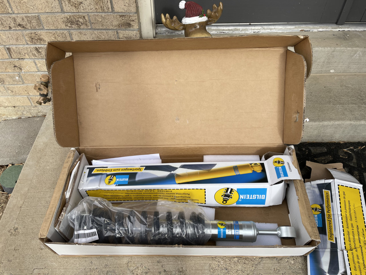

    Flowmaster 40 series muffler Headache rack/tonneau cover Bilstein 6112 at top notch Bilstein 5160 Coachbuilder +2 shackle Rear diff breather relocate Coachbuilder bumper shims Lower control arm skid trim Oedro bolt on sliders Raceline injector 18” wheels 35x12.5x18 toyo RT
    What are you switching to?

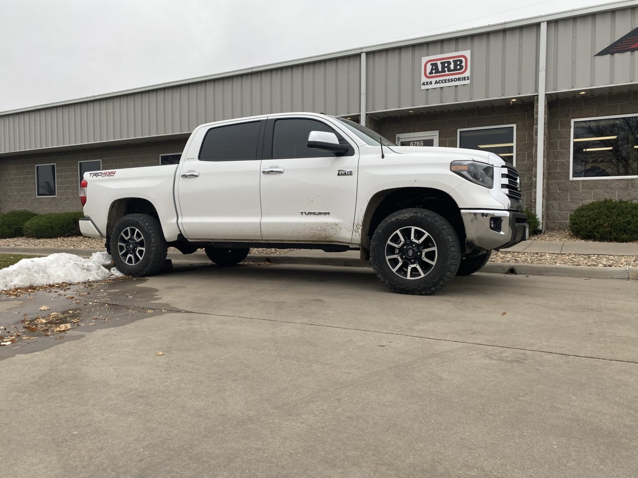

    I talked with Dave at Coachbuilder today and he recommended +2 for 1”rake with 1.9 setting with 2 shims driver one pass for my dc with a topper.

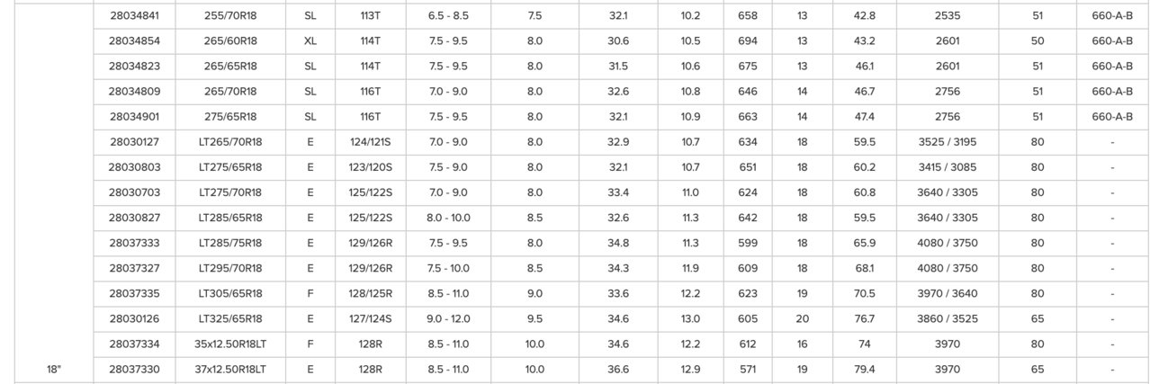

    falken came out with a 285/70/18?

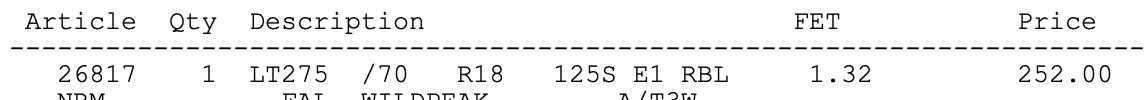

    yes. I got it from Discount Tire, although it's not listed on their website. It was a bit more spendy than a standard size too. The tire is listed on Falkens website though. Still E rated (good or bad) 6lbs lighter than 285/75/18.

    I was just looking and don’t see it listed on their site.

    okay well damn I've been wanting this size but was limited to only the ridge grapplers. What’s the price per tire if you don’t mind.

    This is my exact set up and he is 100% correct. I have exactly 1” rake and love the look - the slight rake helps avoid squatting when hauling and with a topper.

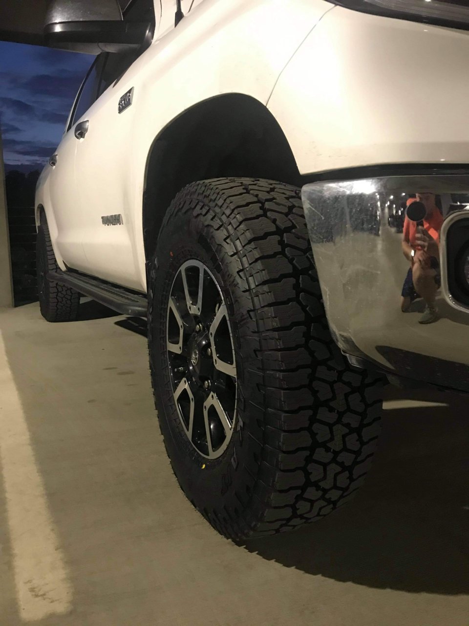

    You have any pics you don’t mind posting? And what wheel/tire set up you went with. Thanks.

    TRD Pro OEM alloy wheels and Falken 275/70R18...

    That my friend looks perfect!! Thanks.
    I’m torn on what tire size to go with though. Wish there was more than one AT option for 285/70.
