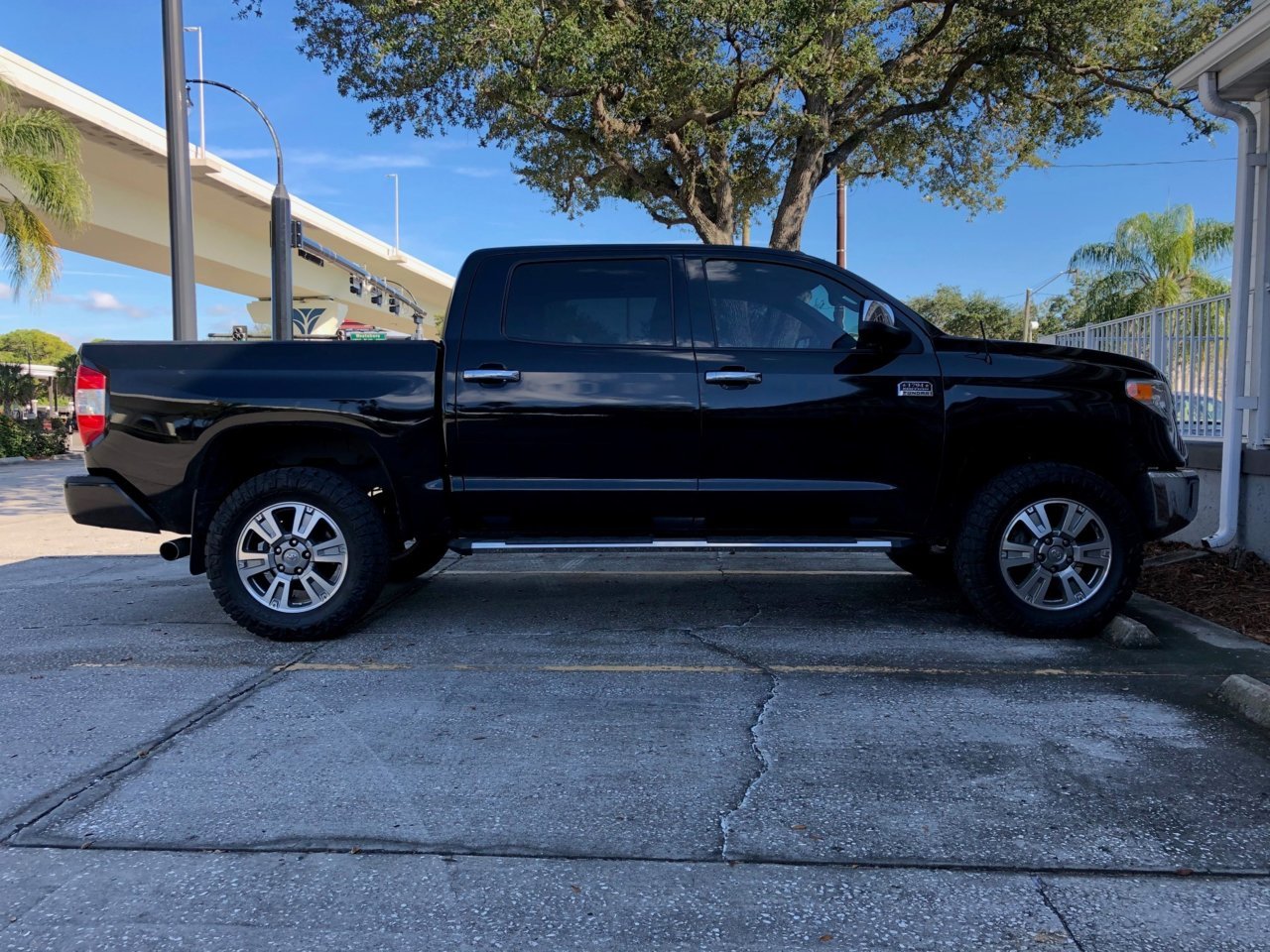

    2020 Crew with 6112 set at 1.9, 1 CB shim on passenger and 2 shims on drivers. I had a front end alignment and the 6112 have been on the truck for a month.
    The passenger side is .5” higher than the driver side. Should I remove the shim on the passenger side?

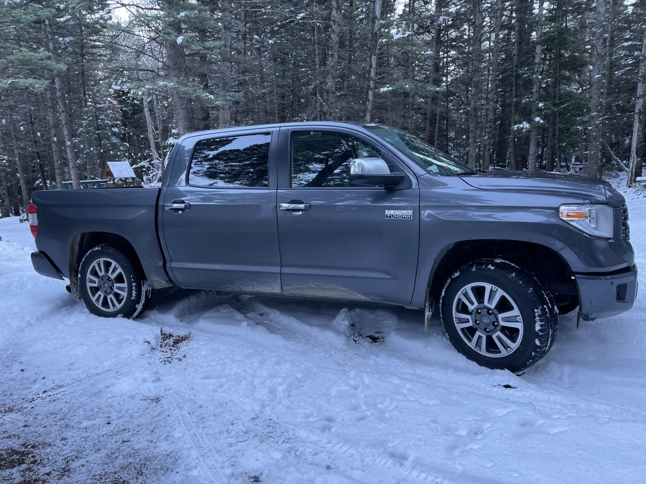

    I am scheduled to get 6112s/5160s set to 1.9in installed in 7 days. I will have a topper and randomly tow a 2500lb pop up.
    Will I have any bro lean issues without any additional equipment. I haven't purchased any shims or shackles and wasn't planning to.
    I would love some feedback. Kinda nervous after reading everyone running CB products.

    I think you’ll be fine. You might be a smidge low in the back depending on tongue weight of the trailer and how much stuff you have in the bed but I bet it will basically look level. You can always add the shackles or some airbags later if it sags.

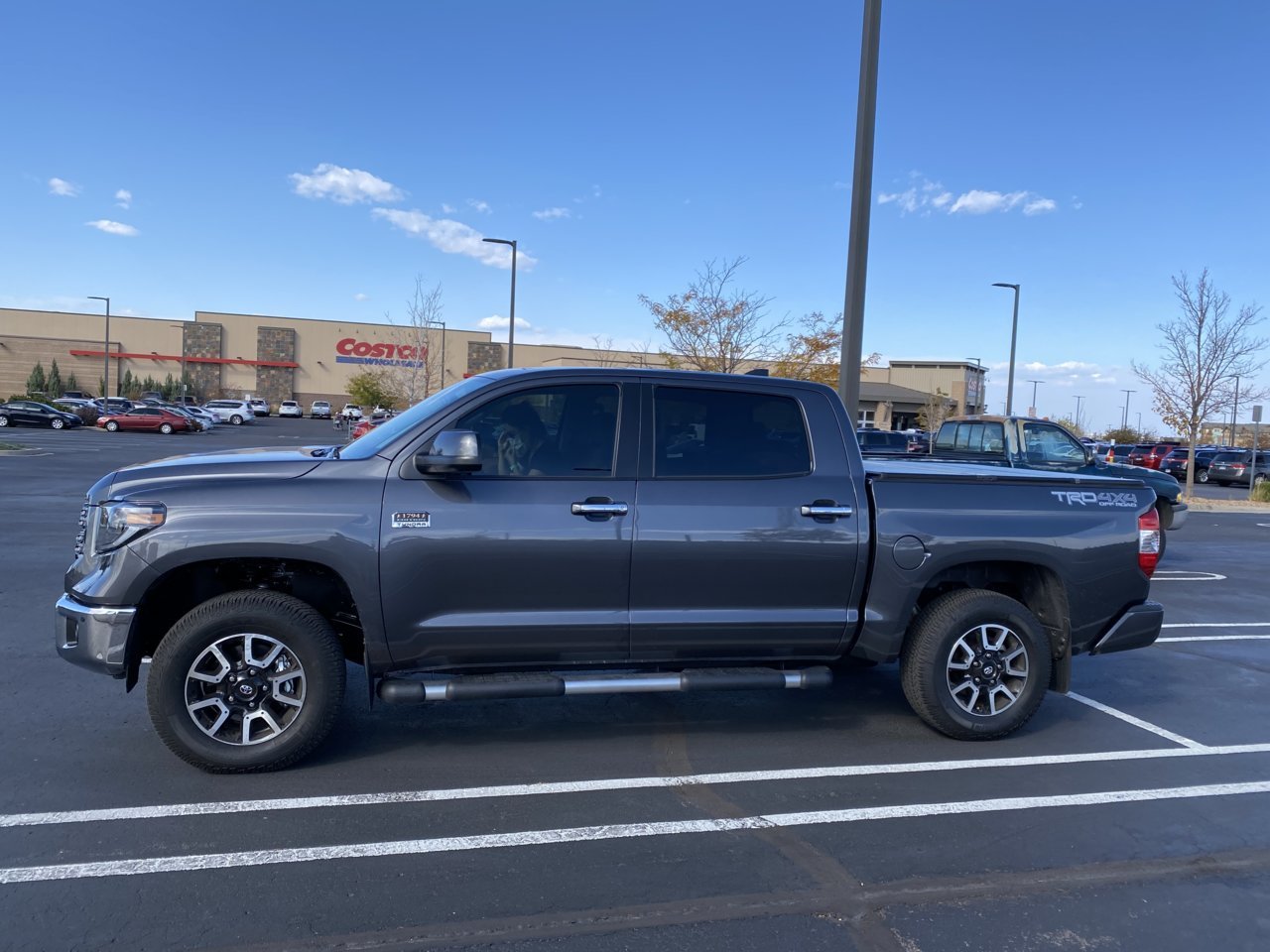

    I went with a full kit from boss offroad and have 8K miles or so with no complaints.
    - 6112's up front (top setting) - two shims on the driver side and 1 on the passenger
    - 5160's in the rear with a 1 1/2 shackle
    - bump stops and diff drop - didnt use the included sway bar relo brackets...
    Running 285/65/20 Ridge Grapplers on stock wheels
    I was tight on clearance to the UCAs so elected to run spidertrax wheel spacers until i go to an 18" wheel with the right offset.
    The ride is great and the truck sits 1/2" higher in the back with no load. Installer had no trouble getting the alignment in spec and I'm very happy with the upgrade.
