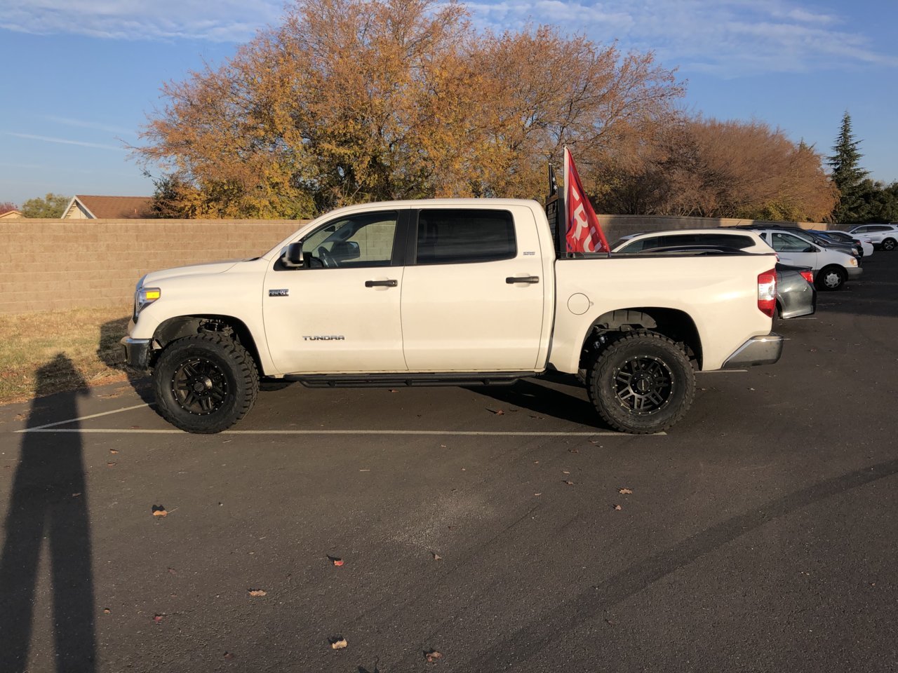

    Flowmaster 40 series muffler Headache rack/tonneau cover Bilstein 6112 at top notch Bilstein 5160 Coachbuilder +2 shackle Rear diff breather relocate Coachbuilder bumper shims Lower control arm skid trim Oedro bolt on sliders Raceline injector 18” wheels 35x12.5x18 toyo RT
    Installed my 6112 at top setting with coachbuilder +2 shackles and bilstein 5160 on Sunday and got my new tires today. Didn’t get the tires I was planning on but when a good deal comes up you can’t pass it up. Got Toyo R/T 35/12.5/18 and they are a great fit and make the truck look like it should.30B3A12A-F1CB-41F1-8BB8-6B2E0A505442.jpg
    Will try to get some better pictures tomorrow in the sunlight. But very happy with the results of lift with 35s

    Definitely need more pics. Looks nice, well done....well except it's a slow color. Gotta have that MGM

    Yes, more pictures are needed. was busy with this Stupid thing called work today that really gets in the way of other stuff... with the exception of funding the other stuff.
    I thought super white was the faster color. It says it’s super in the color.

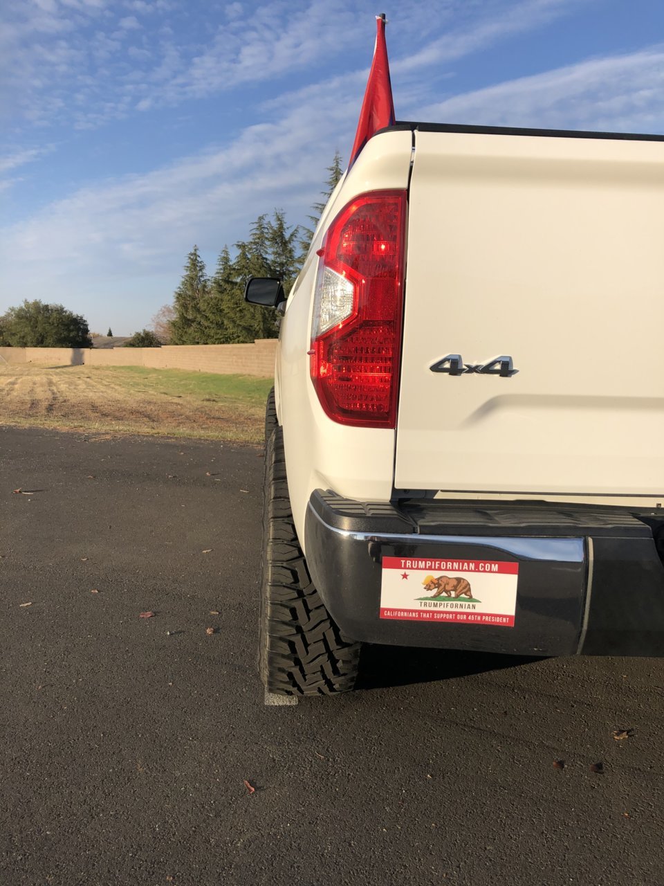

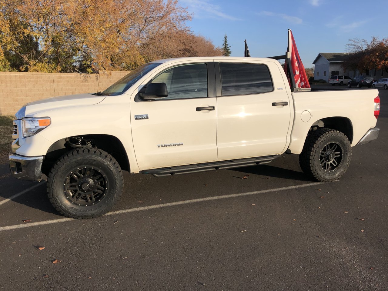

    FA30DB68-6C63-4315-A84D-4A2E9242E68E.jpg 3B885CAC-7513-495C-8B7D-6A401504E314.jpg Here are the pics my tire guy sent me when he finished the install.

    Pretty much solidified my decision between 295/70R18 or 35s. That looks great!
    What about trimming/rubbing??

    When I first picked up my truck it barely rubbed at full lock in reverse. Then had it aligned and now there is something barely rubbing at full lock in drive. Rims are +18 offset and I have the coachbuilder bumper shims
    I did pull my front fender well plastic down before dropping it off so I’ll see if I can fit that back in hopefully tomorrow
