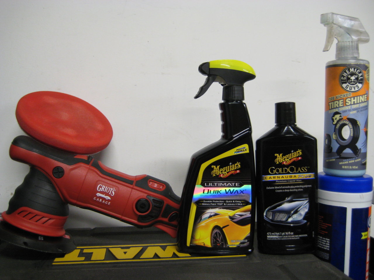

    Washed, waxed, spray waxed, and tire shine.
