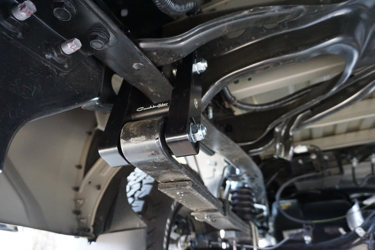

    To remove the stock leaf spring bushings

    or you could half ass pound them out with a 26 mm socket

    Can't I just bolt up the shackle on the existing bushings? Only have 11K on the truck.

    I think there is a difference in material....poly
    Vs. Rubber...not sure but maybe it makes the ride different...someone else can chime in..

    Don't think it's absolutely necessary to replace the bushings. The original are still compatible with aftermarket shackles. I left my original bushings for now since I couldn't get them to budge with the ball joint press. Working fine with Toytec shackles
    I've seen the other method of removing the leafs from the vehicle, heating with a touch and cutting a slit then air hammering them out. That's more than I care to do and will just replace the leafs down the road

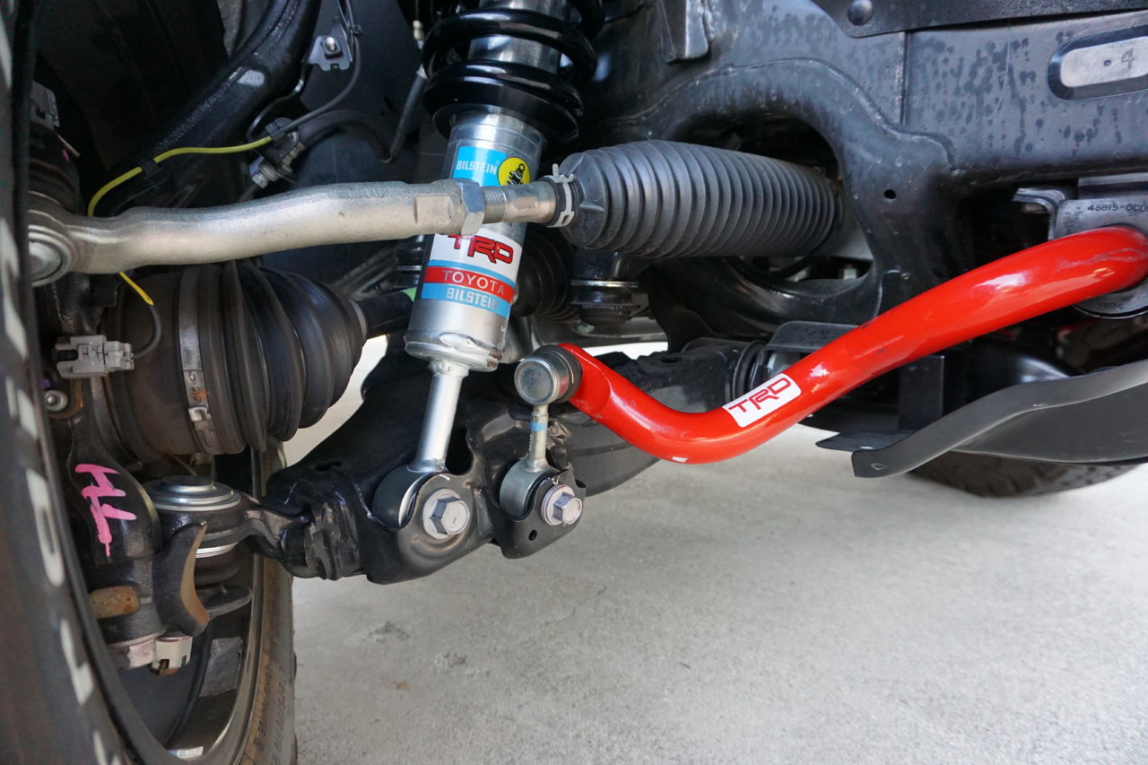

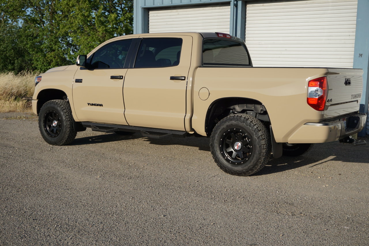

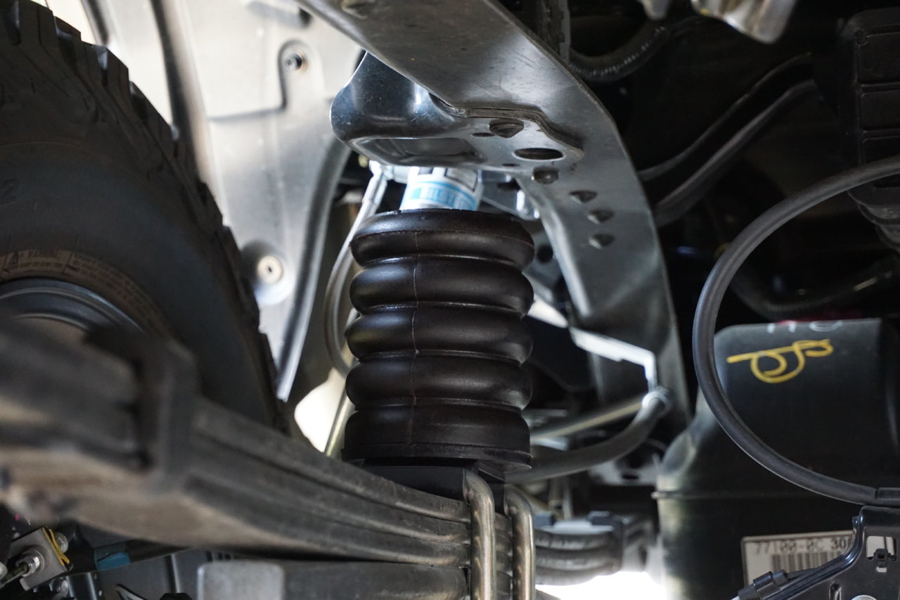

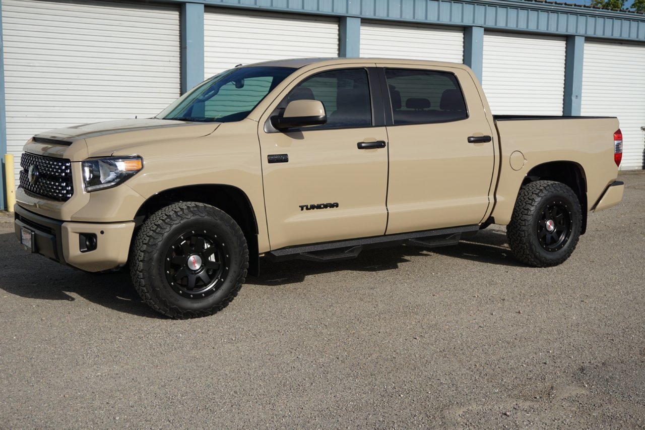

  12. May 6, 2020 at 9:10 PM
    #1062

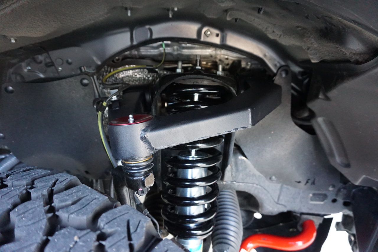

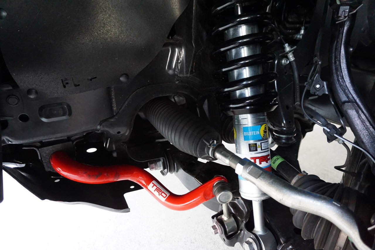

    Quicksand_Tundra
    Quicksand_Tundra New Member
    Apr 21, 2020
    #45332
    201
    Jon
    2019 Quicksand Tundra CM 4x4

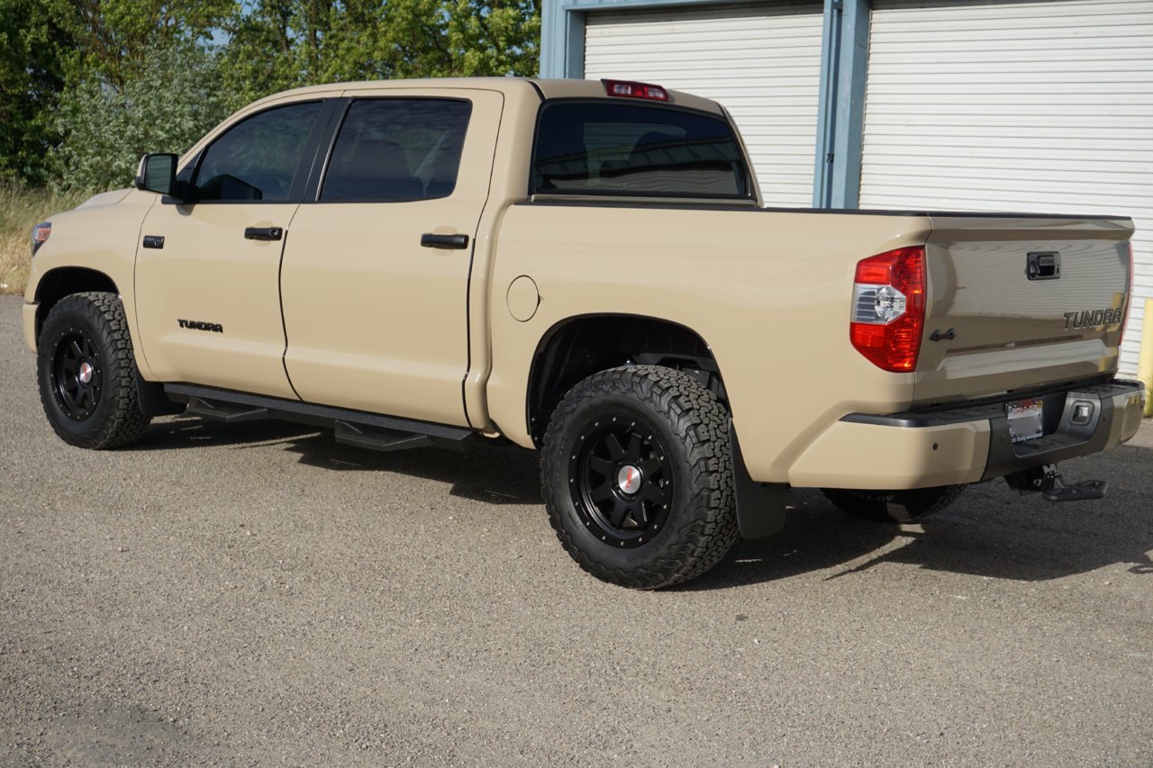

    -Color keyed grill & bumper -Diode Dynamic SAE LED Foglights -Headlight Revolution LED Light upgrade -SCS SR8 18x9 with 295/70/18 Toyo Open Country AT3 -Go Rhino Dominator D6 Steps -TRD OEM Intake & Dual exhaust -Bilstein 6112 front and 5160 in rear -JL Audio C2 6.5" speakers upgrade powered by JL Audio RD 400/4 amp -Pair of AudioFrog GS25 speakers front dash -10” Kicker Hideaway subwoofer under driver seat -All doors covered with Soundskins deadening mat (inside/outside) -Front window tinted at 35% -Paint protection film full front -30” Rigid Industries SAE light bar -Body Mount Chop -Diode Dynamics SS2 (red) setup for brake light & turn signal -Katzskin Custom leather upgrade (Black/Bamboo) -Amber led running lights (Hood bulge) -AJT Design: Black vent rings, steering wheel trim, shift gate trim, emblem overlay -AJT Design: Quicksand door handle cover -Carbon fiber wrap (silver part on door panel) -Air Design tailgate applique (Line-X in smooth gloss finish) -Air Design tailgate spoiler (Line-X in smooth gloss finish) -Smittybilt beaver step (Line-X) -Valhalla Cat Shield (Line-X) -Coachbuilder Shackles kit +2 -Coachbuilder Strut/Coilover shim (0.5" for driver side) -Sumosprings (rear bumpstop) -Meso Custom Led front and rear cab lights -Teton shop shift knob -TRD Seat belt shoulder pad -Husky floor liner front/back -LED courtesy door/step light -LED bed light kit w/ outside switch
    Before
    After: Final measurement Ground to fender- Front Driver= 39.5" Front Passenger= 39.75"
    Before:
    After: Final measurement- Driver Rear= 41.25" Passenger Rear= 41.5"
    The truck is at half tank during this shot.
    Very happy with setup. Ride is more stable, absorbs bumps, and the stance is just the way I like it.
    I ordered a set of 33/12.5/r18 BFG KO2 but were too massive and bulky. (will not clear)
    Decided to cut down to 295/70/r18 Toyo Open Country ATIII (hoping to clear with minimal work)
    TRD Sway bar definitely helps with cornering and keeps the truck stable.
    Beefy shackle by Coachbuilder +2 (1.25" lift)
    Extra support from Sumosprings Bumpstop
    Zone Offroad UCA
    Love how all the red just flows together

    Quicksand_Tundra
    Apr 21, 2020
    #45332
    201
    Jon
    Just about 2". Check out the before and after photos I just posted up. Hope that helps. Thanks.

    Good point. I'm sure there's a ride improvement with the poly bushings but Toytec for instance only recommends using them, doesn't say it's required.
    There's probably a reason why Toyota went with the design they did. And I bet it costs more than a poly bushings, unless they've just been using that same exact part forever.

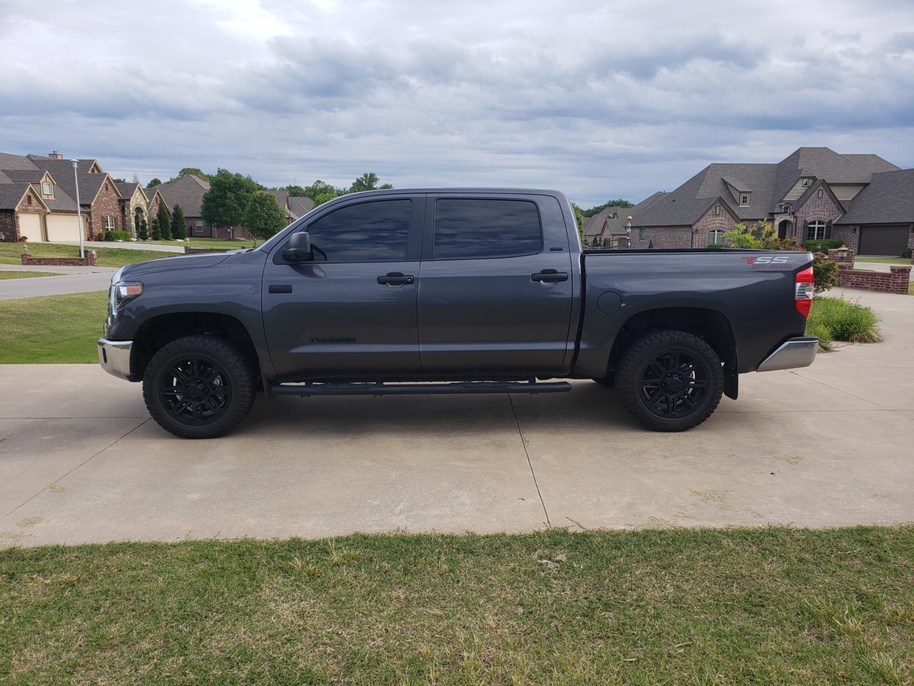

    Lossy, mine seem to be settling from pics above. I do have shackles but am not sure now that it seems to be settling. I will get a new pic for you.

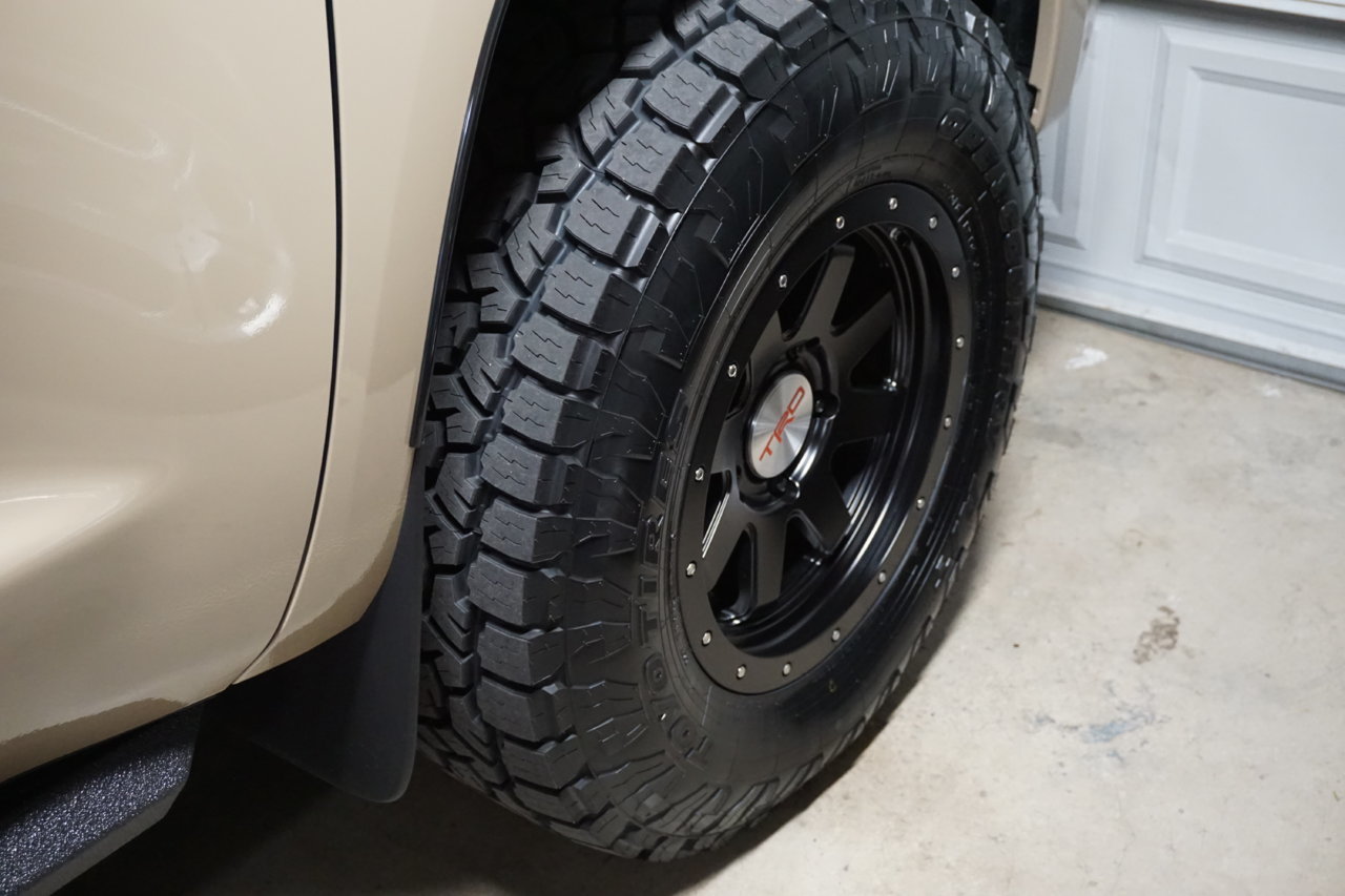

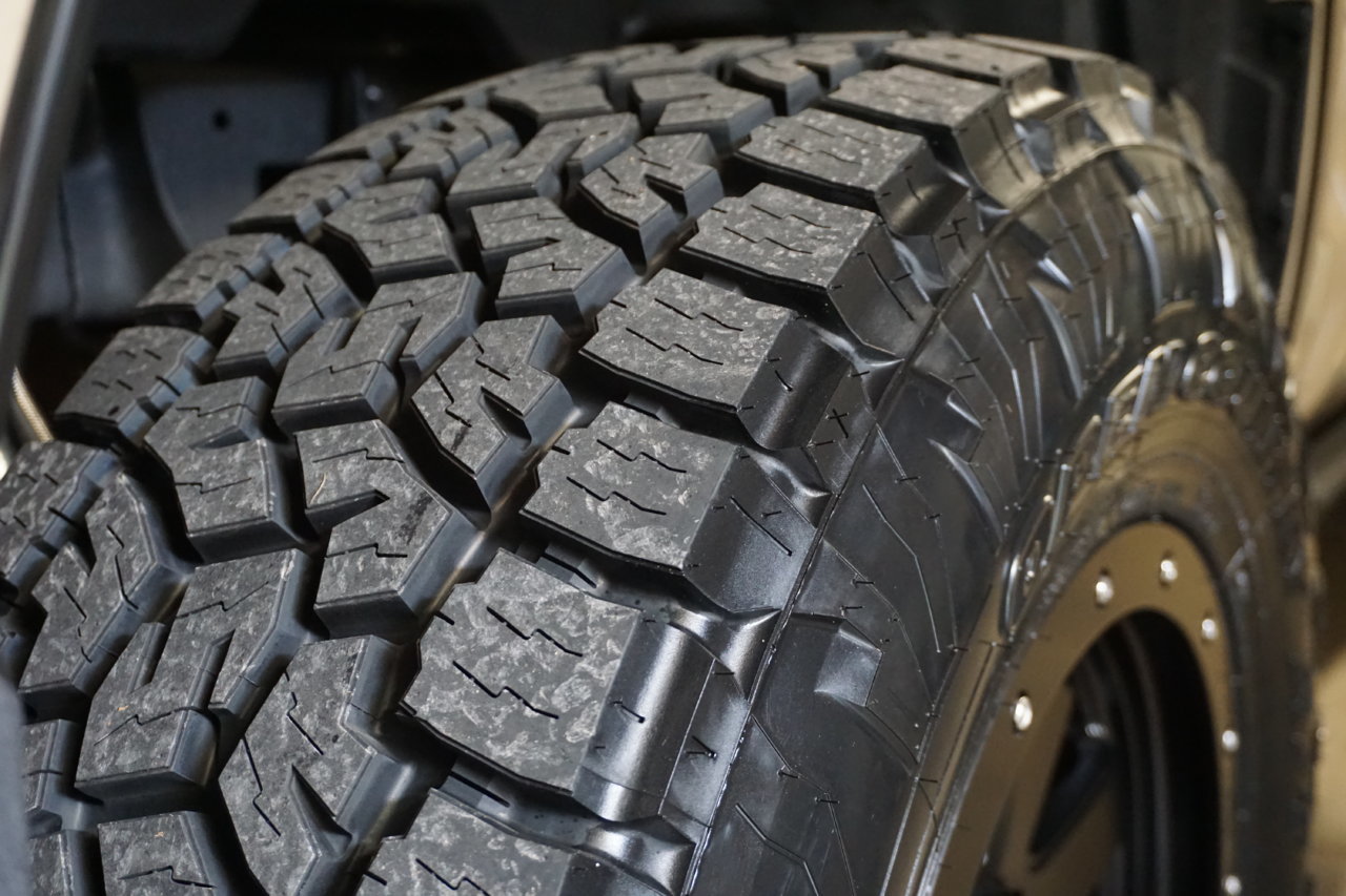

  20. May 20, 2020 at 8:37 AM
    #1070

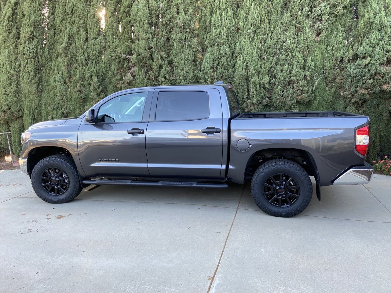

    Quicksand_Tundra
    Apr 21, 2020
    #45332
    201
    Jon

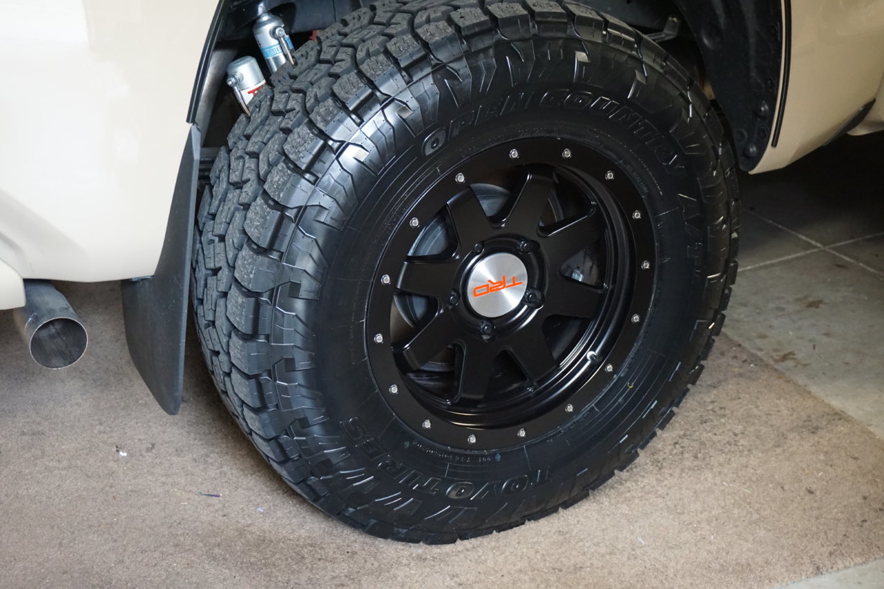

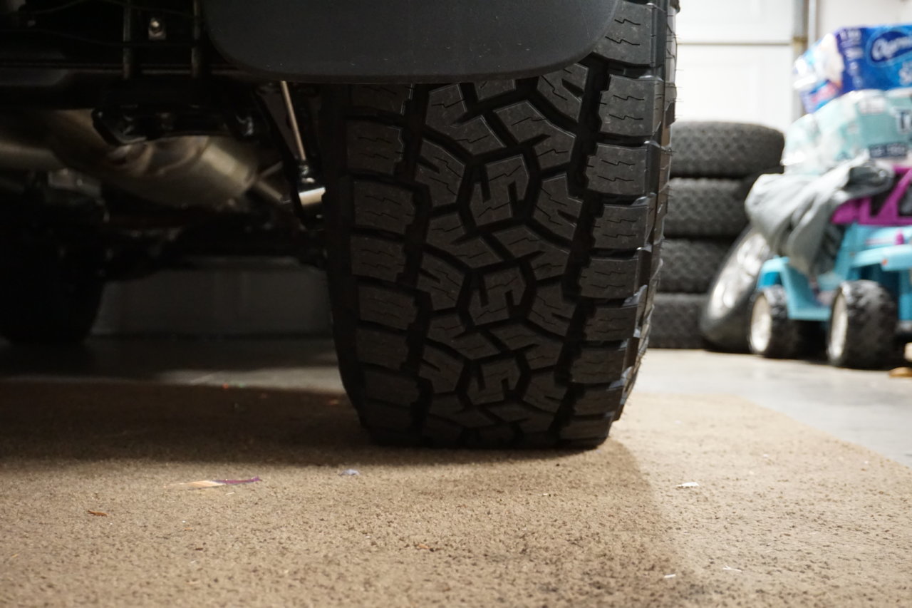

    The new Toyo Open Country ATIII -295/70/r18 (Driver side mud flap has to be trim/does rub on full lock when reversing)
    Only if BFG KO2's were available in this size I would have stayed. <----Come on BFG, make this size and I'll come back!
    More pictures to come. This size gives the truck a better stance IMO.
    What do you guys think of the new Toyo OC ATIII?
    BFG KO2's has a thicker, aggressive side wall compare to the Toyo.

  28. May 27, 2020 at 4:50 AM
    #1078
    TRDOBSESSED
    TRDOBSESSED New Member
    Apr 30, 2020
    #45745
    26
    2017 metallic gray SR5 TRD Offroad
    i'm digging that tire ...and size .....what finagling did you have to do for them to fit ? After market uca's ?

    #1080
    Quicksand_Tundra
    Apr 21, 2020
    #45332
    201
    Jon
    No aftermarket UCA needed. You would have to remove both mud flaps in the front to not rub. But since I wanted to keep my mud flap, I had to trim and cut out the part that stuck out the furthest to the tire. In the end, I still had two screws to hold the mud flap in place. Will post more photos soon. Thx.
