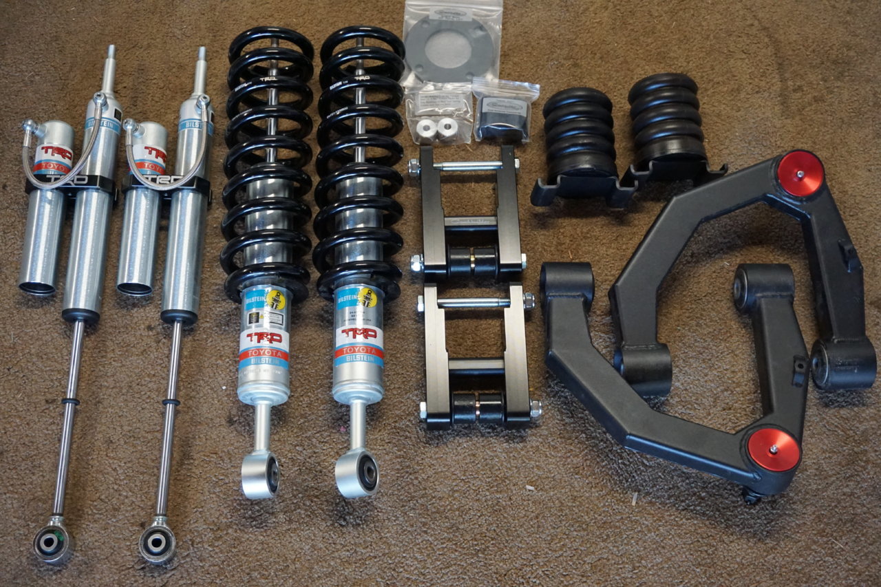

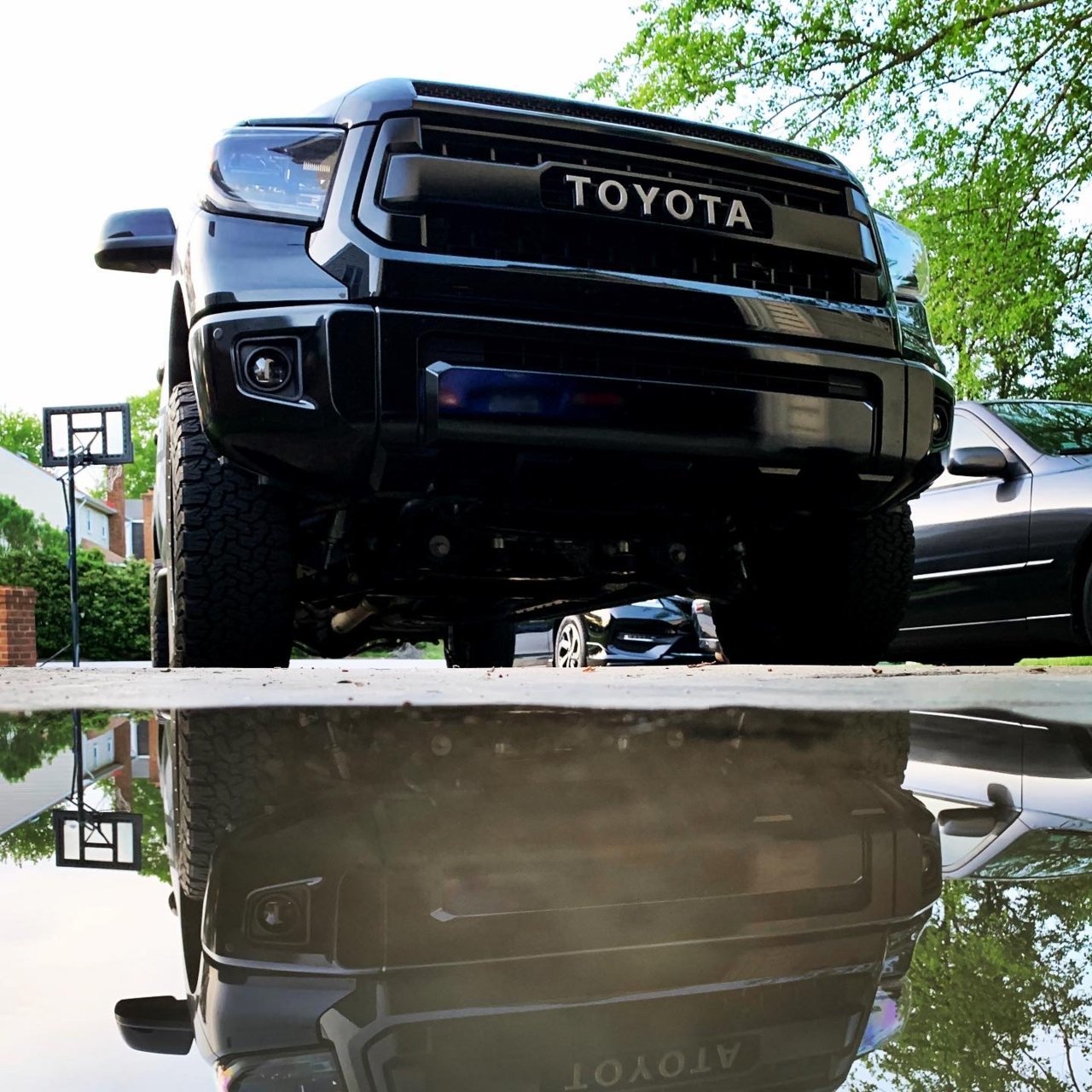

    Yea! All the parts are here.
    This is the stock height of the truck (275/70/r18)
    Will post up before and after.
    Also upgrading tires to 33/12.5/r18 BFG KO2
    Can't wait!
    Tibetan Nomad and CLS2011 like this.

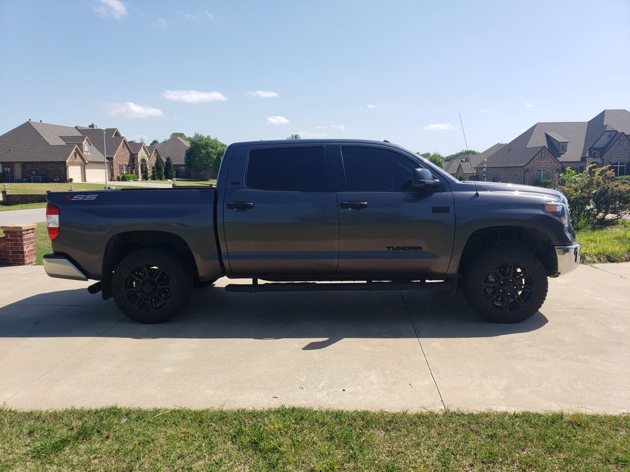

    Need some help. Against my better judgement I am attempting the 6112's myself. I have removed the stock and I assembled the new but can't get it in. I put the tophat bolts through and start a nut on one. The bottom of the strut will not go into the housing in the lower control arm. The body of the strut is hitting the sway bar attachment before I can seat it. Any help is appreciated.
  11. May 1, 2020 at 7:50 PM
    #1031
    soonerman
    soonerman New Member
    May 1, 2020
    #45788
    14
    Greg
    2019 Tundra TSS Off Road
    2019 TSS Off Road if that makes any difference at all.

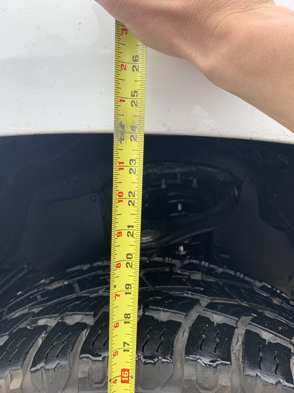

    1.9 No shims. 5100's no lift in rear. 275/55/R20 stock wheels and tires. It is measuring slightly over 3 inches higher in the front now. I am hoping it settles a little if not will add a one inch shackle. Thanks everyone for the tips while I struggled to get it done!
