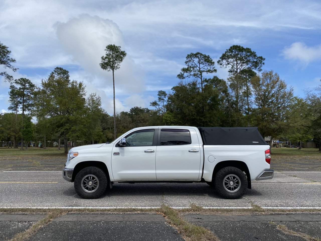

    2018 Cement Crewmax SR5
    Accutuned Fox 2.5 DSC/2.0 rr, SnugTop Rebel, Alpine Amp, OEM LED headlights, LED fogs, Remote Start, RB20 steps, RCI Skids, 10" BA Muffler, 17" Icon Alloy Six Speeds, 15" Tint, Pro-clip mount

    Finally got these on. Specs:
    Front Suspension:
    6112 1.9
    2 CB shims driver
    1 CB shim passenger
    Rear Suspension:
    Stock height in these pics.
    Icon 2.0 going on tomorrow.
    Pro Form 1.5” shackles MAYBE
    Tires:
    305/70/17 Nitto Ridge Grapplers
    Wheels:
    TRD Forged Rock Warrior
    17x8 Et55 (I believe- somebody correct me if I’m wrong)
    Other :
    No rubbing other than a little on the skid plate. I took a pair of crappy vice grips and bent both sides up in under 5 mins in a parking lot. No big deal, at all.
    Coming Soon:
    CB bumper shim kit
    1.25” spidertrax spacers
    Hoping no BMC on this
    Icon 2.0 rear, tomorrow
    Pro Form 1.5” shackles??
    Conclusion:
    Ride is night and day on the bumps. It floats compared to my stock black struts. Less body roll. Less brake dive. The rears are obviously lacking now, even on the street. I had the chance to go down a mild trail and the difference from stock really shows there. But, you can absolutely tell on the street. Again, rears are lacking in comparison and it’s obvious.
    To me, truck looks level. I need to confirm I’m on 1.9” because I was expecting it to be a lot higher in the front than this. That’s why I bought the 1.5” shackles. Driver side still looks lower than passenger and is lower than I’d like.
    More pics and measurements incoming.
