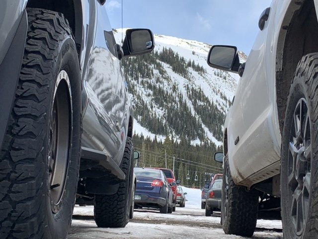

    Now with 285 75 17 (almost 34) on icon alloy six speeds (+25):

    Sweet set up. I have virtually the same thing. I have rubbing on the cab mount on the driver's side. It only happens at a certain degree turn when flexed. You running into any rubbing issues with cab mount?

    To be honest, I haven’t had it setup long enough to turn while flexed! I do rub the mud flap “pad” at almost full lock in reverse, but I will keep any eye out for addition rubbing. FWIW, my tires measure around 33” on the vehicle. I was a little bummed, but I don’t think I could handle more tire without cutting or compromising.

    Yeah, I added bumper shims and trimmed the heck out of the front liner. I went up a mountain trail last week and it confirmed what I thought happened on the road once in a while with the cab rub. And yes, it is a full wheel well at 1.9. But I am thinking with a cab mount chop, 34-35 would be doable. That decision is a ways off from me as I just got these tires in December, 3300 miles on them. But I am getting the cmc ASAP which opens up future options.

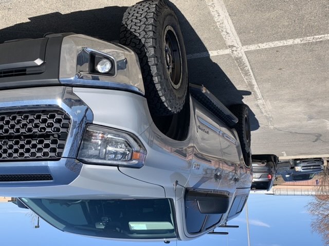

    I just installed all my gear seen below including the 6112's at the top setting. I've seen many of you talk about the 6112's "settle in" and losing some height over time. I'm hoping that happens because I personally don't like how much lift I have after installing them. If they don't settle in I can always opt to change the ride height down to the 1.9 slot but we'll see. Thoughts?image-20200306_122837.jpg IMG_20200218_184820.jpg

    It's funny you are saying that because I didnt like mine either at top setting but more so the ride feeling so today if we have time I am dropping it to the 1.9 setting

    That's probably what I'm going to be doing here real soon as well. Somehow the front end of my truck is now 5" higher than stock (36.5" completely stock to 41.5" ground to fender). When I do the math, the truck should only be ~40¼" between the 6112s maxed out and larger tires (295/70/18 which are 33.3" in diameter). I ordered the 6112s preassembled so I believe they're put together properly. I'm still scratching my head a little. These are not going to settle that much so I'll be looking to drop down to the 1.9 slot.

    They are 34.3

    That's the quoted manufacturer size but they're not even close to that. Tires are usually ~1" smaller in diameter when they're installed and under load. Go find the thread about the Cooper AT3 XLT tires and you'll find lots of conversation about it. Look up what your tires are "supposed" to be and then go measure them. I bet they're smaller than you expect. IMG_20200124_160517.jpg
