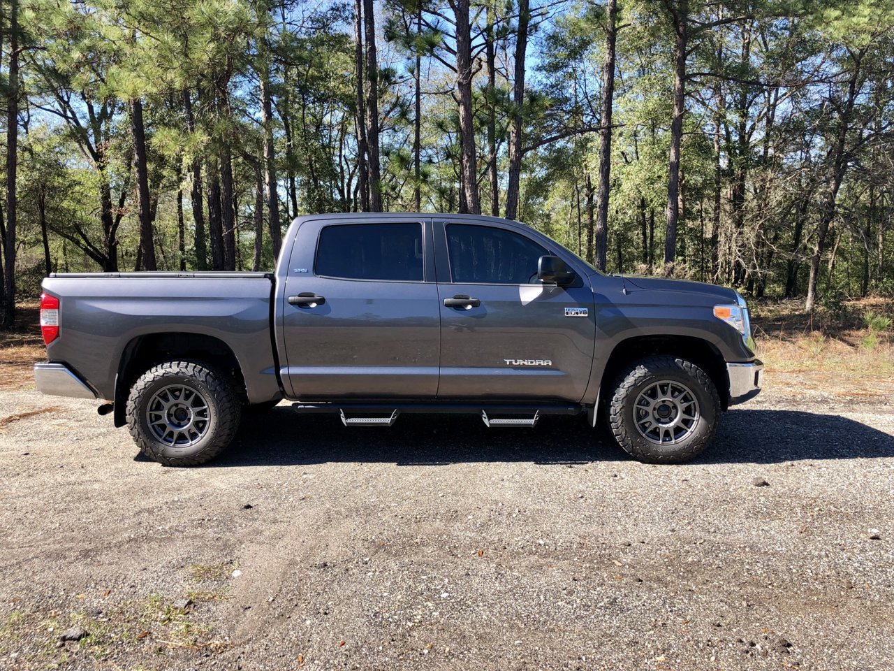

    What does anyone know about these? My shop seems quite confident in them.

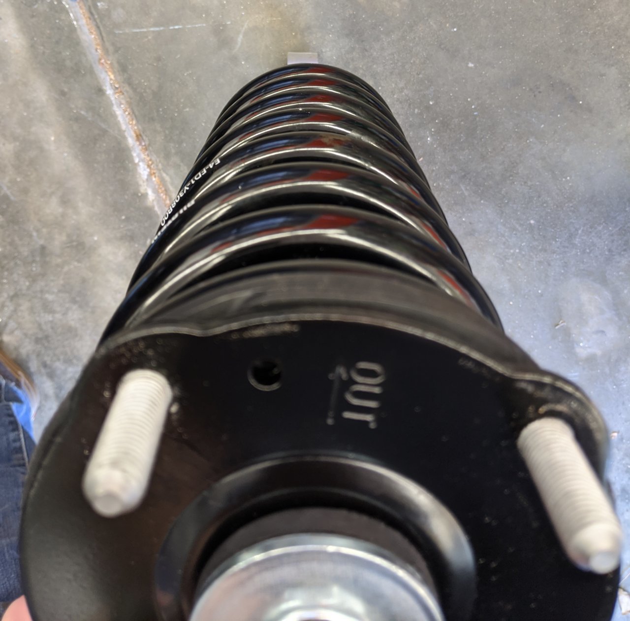

    Need some help, in the middle of installing 6112 at 1.3 setting.
    Starting on the driver's side. I got the new 6112 shock in and everything bolted back up. I used a jack under the lower control arm to help reconnect the upper control arm. Truck is supported on Jack stands though.
    Once everything was bolted back up I started to lower the jack from the lower control arm to put the wheel back on and finish up that side, but it looks like the whole assembly is trying to droop way too far to the ground. So I stopped and jacked it back up a little
    It came down so far I wouldn't be able to install the wheel without jacking the whole truck higher. Didn't think this would be the case since o ly 1.3 inch lift.
    So am I missing something? I really feel like something will get damaged if I take all the pressure off from the jack holding up the lower control arm
    The only thing I can think of is I had to loosen one of the cam bolts to get the new shock in place but I tightened that back up (maybe just not enough)?
    I guess the two things concerning me is how low the hub looks like it's going when I take the jack down and also how far down the UCA is starting to droop.
    BTW, I referenced this video since it was my first time doing this https://m.youtube.com/watch?v=iH7FQUjmu20
    Might be a little different since it involves unbolting the UCA

    I just went to install the passenger side shock but it wasn't going in the LCA slot. I notice the arrow on the top hat is not in line with the shock body. It's off by several degrees.
    I'm guessing I need a spring compressor to fix this. I bought these pre assembled from Boss so I don't have one.
    Any thoughts?

    You should be able to install the top and with a large crew driver or metal bar align the bottom of the shock body. Essentially rotating the lower portion. You may be able to do the same before installing it but you’ll have more leverage and know exactly how you need to align it.

    Glad to hear that thanks! I'll give that a go tonight. I was wondering if I can just turn the lower portion till it's straight but didn't want to break anything

    Was able to align the shock no problem. Got it done and took a short drive. I'll measure where I'm at soon but looking to see where it settles.
    All in all, the install is a little annoying but definitely would take 2-3 hrs max of I had to do it again. I posted the video I kind of followed but for me I think the key was to loosen the forward cam bolt so the LCA can drop enough to get the shock out and new one in. The video didn't say anything about that.
    There's definitely a few steps where you could really mess something up, mainly cross threading bolts. So of you are used to wrenching in general it's no problem. Just take your time on the first go.
