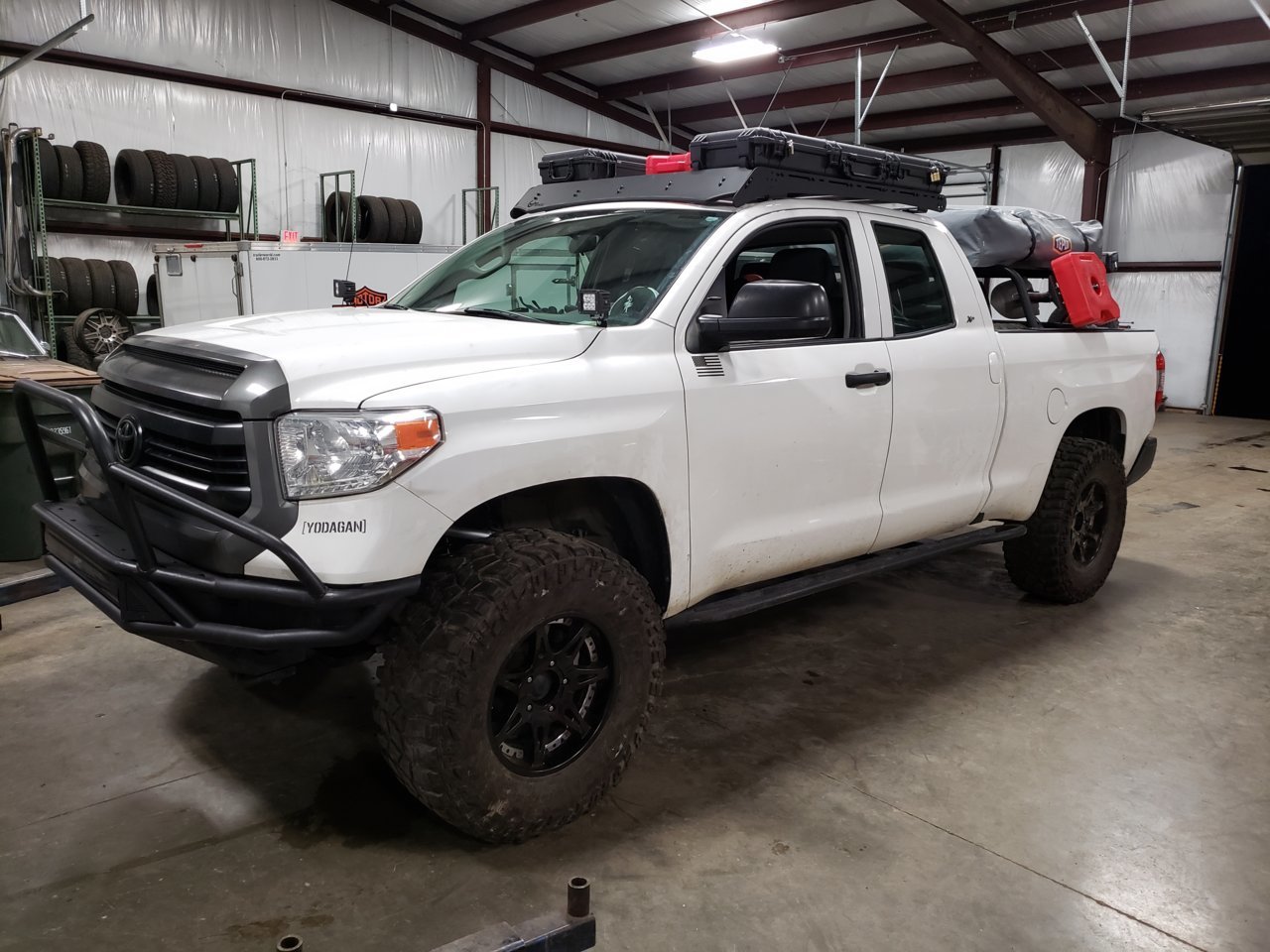

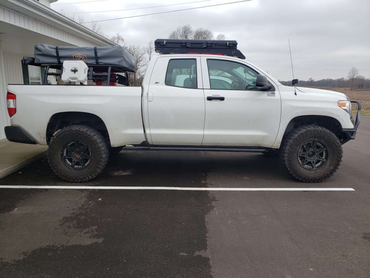

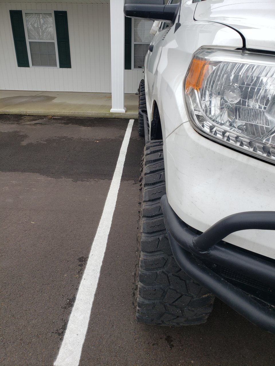

    6112 top setting, toytec shim on driver side. 5160 in the rear with icon/deaver leaf expansion pack and toytec aal. 37x13.50r18 Cooper Stt pro on moto metal MO961 18x9 +18 offset

    really really nice set-up there!
