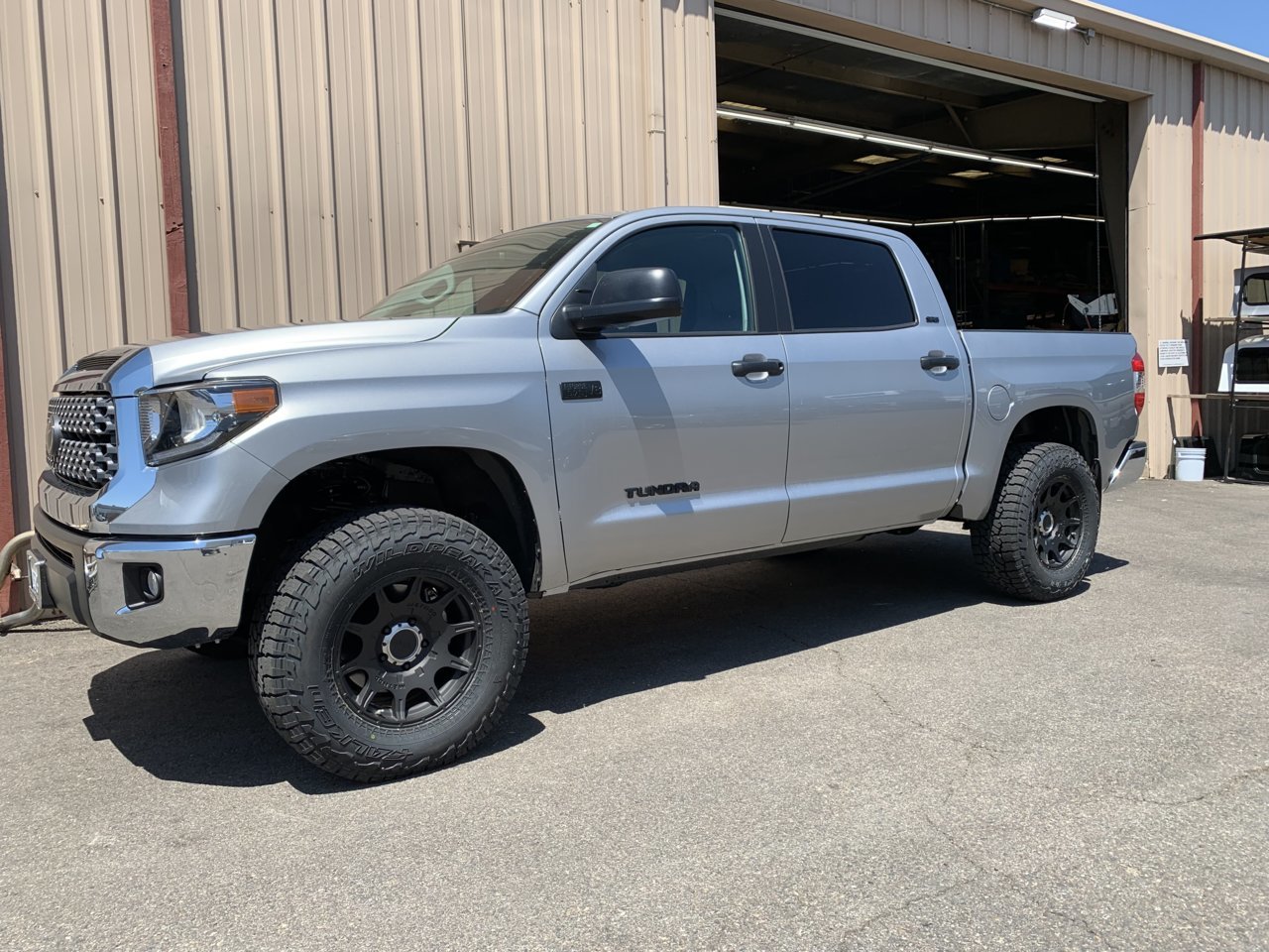

    6112 - 1.9”, and 1 CB shim on driver side. 5160 with no lift. D137E759-8385-46CD-BF0E-B35CD2B729D6.jpg18180D75-5A94-49E3-83E1-DEE0EA6CC924.jpg

    Looks damn perfect! This is probably the setup I'll take when the time comes for new tires (aka larger).

    6112/5160 2.5 +2 driver 1 pass CB shims, CB+3 shackles,
    What size tire are you running on that setup?

    275/70R18 Nitto Ridge Grapplers

    Wow looks great! What size and offset rims do u have? What size tires ? Any issues with rubbing?? Thanks.

    Thanks. Wheels are 18x9 +25mm offset. Tires are 275/70R18 Ridge Grapplers. No rubbing at all!

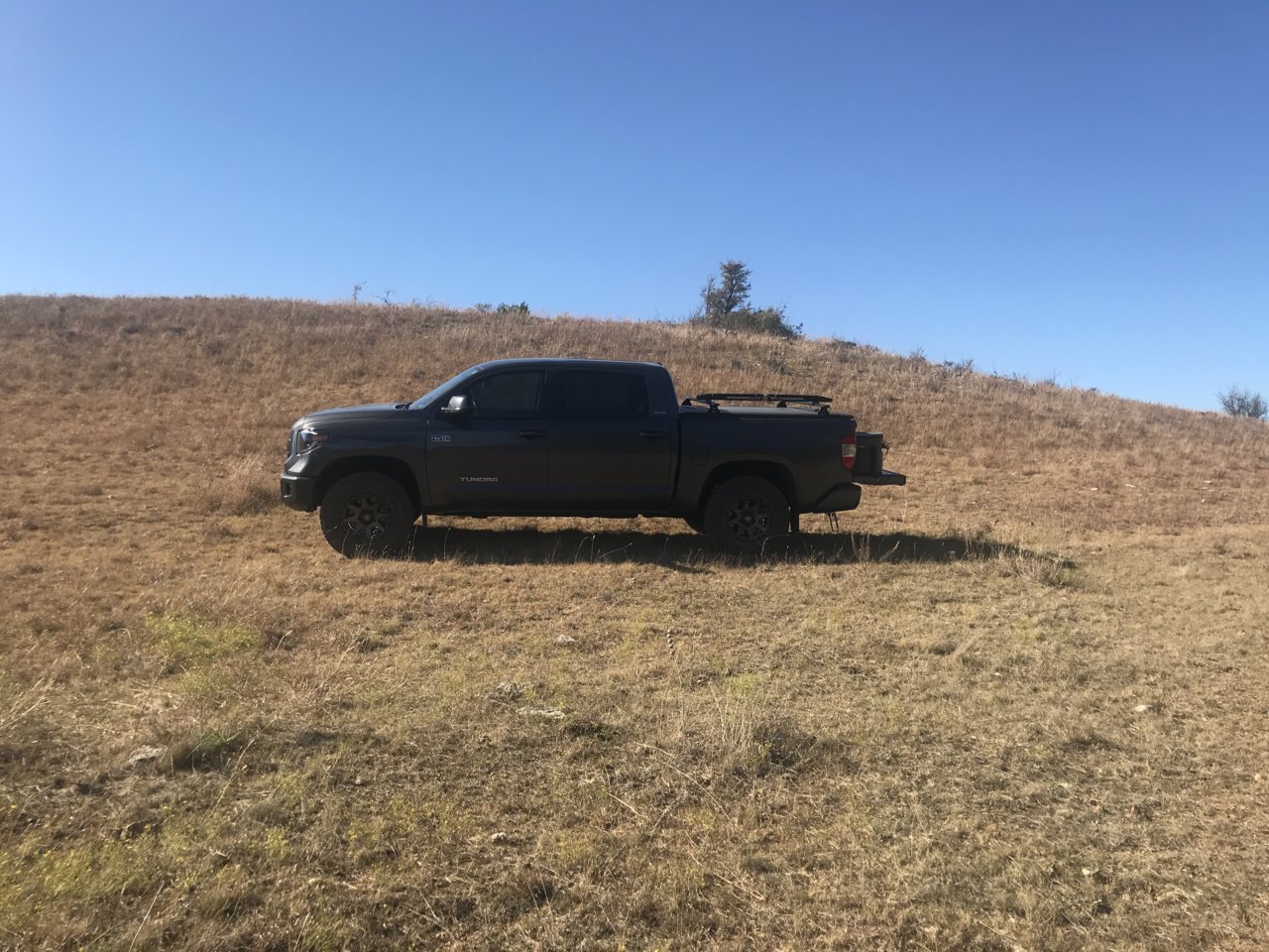

    I don’t think I ever posted pics of mine finished. 6112’s @ 1.9 with 1 shim per side, 5160’s with CB +2 shackles, CB bumper shims, removed small front mud flap, and Icon rebound in bronze with 285/75/17 Cooper AT3 XLT’s. No rubbing anywhere.

    How’s the ride on top settings? I got mine coming in to replace a spacer lift, debating about going 1.9 or top setting.

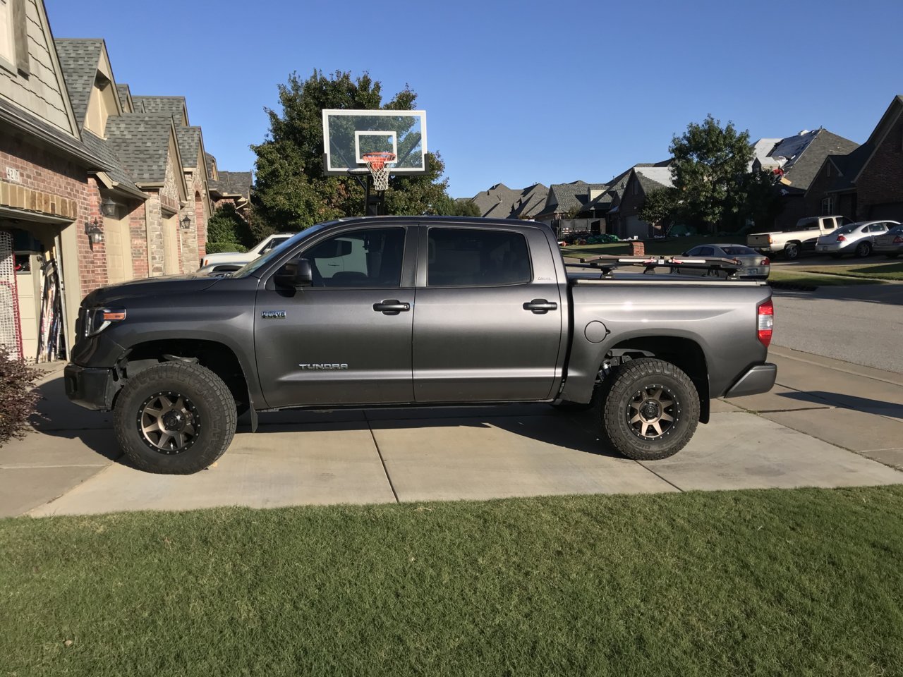

    Bilstein 6112 front (2.5")/5160 rear Total Chaos UCAs Toytec Shackles 1" Method Roost 18x9 Falken Wildpeaks 295/70 R18 Carven Cat Back Exhaust Baja Designs Squadron Fogs (Amber) Stubby Antennae Blackout Badges/ Tailgate Insert Front Tint (20%) K&N Air Filter Gate King adjustable lift gate Color matched grille/bulge
    The ride is a little stiff, but I feel like they’ve softened some over the last 3 months. I have nothing else to compare the ride quality to on these other than the stock suspension, which that was totally improved otherwise. I hear it’s softer at the 1.9 setting, so maybe that’d be your preferred route if retaining some “plushness” is a concern.

    If you want the height but retain the plushness, go 1.9 with 1 shim like I did. My dad was fully convinced I was ruining the ride when he came over and helped me install them. After a 3 hr ride in it to go fishing he couldn’t believe how smooth the ride was. I highly recommend going this route.
