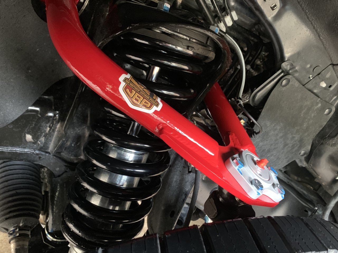

    Can you post pictures and details of your setup? I don't want to regret doing the 1.9" simply to avoid the new UCAs.

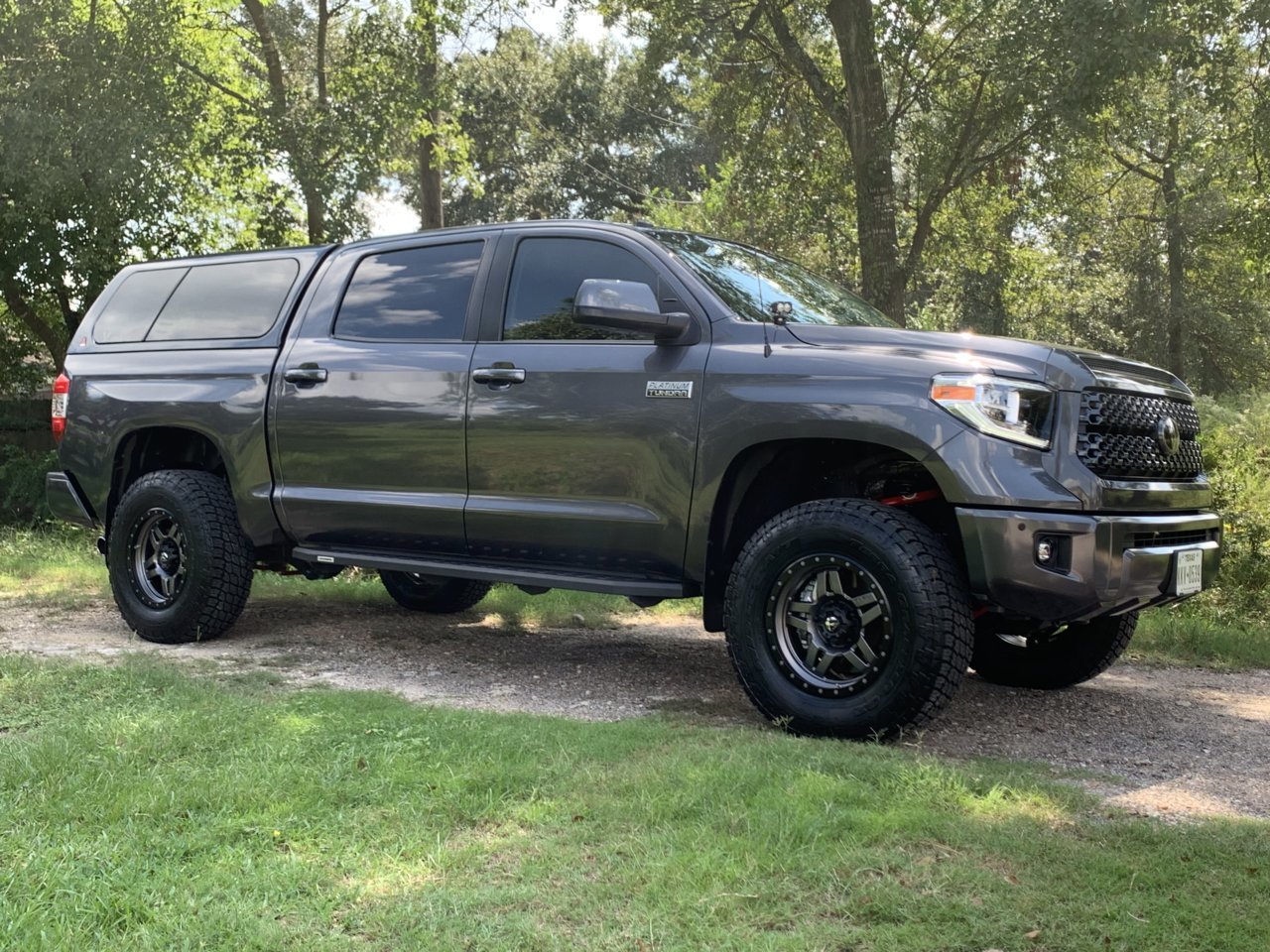

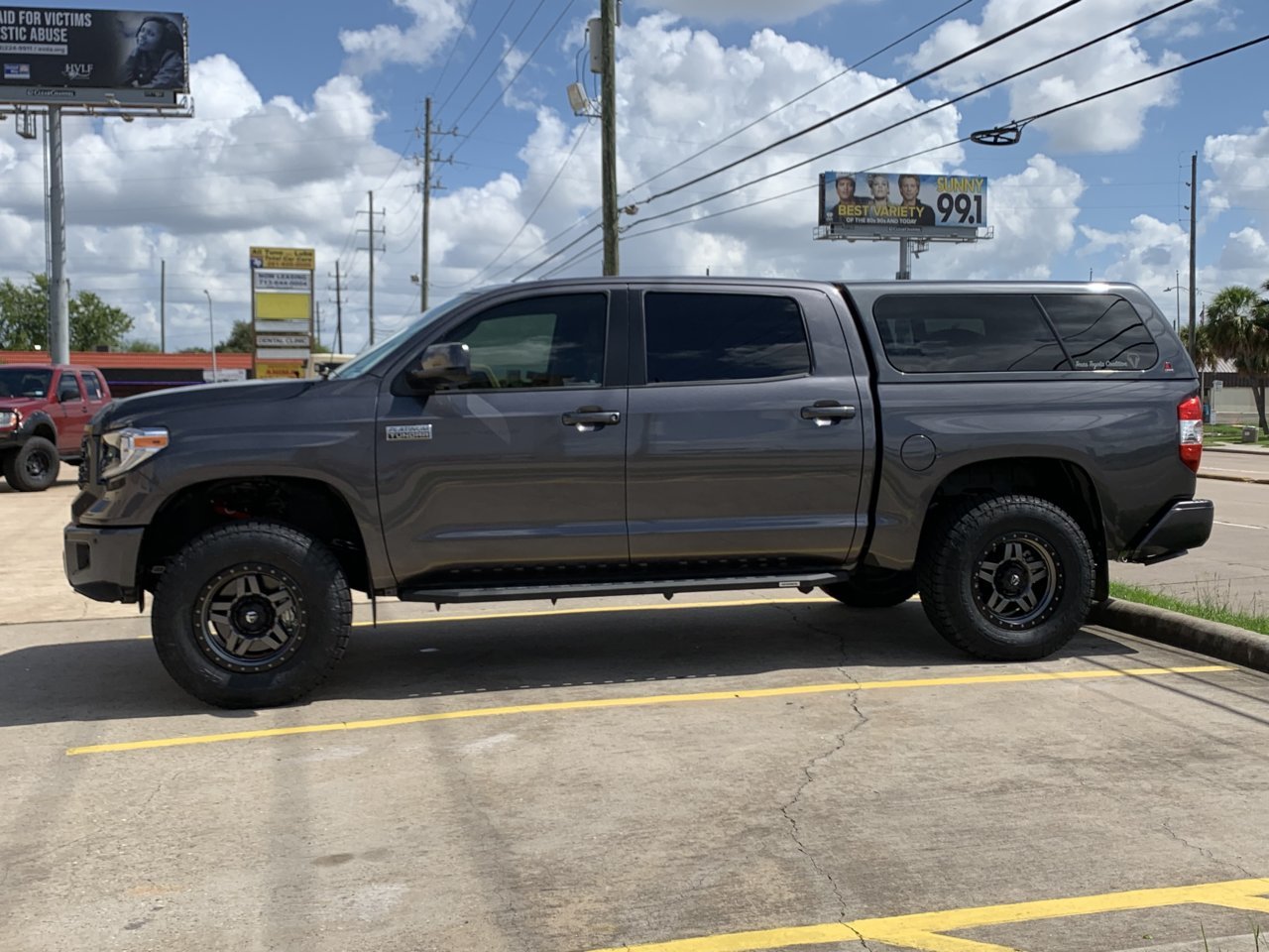

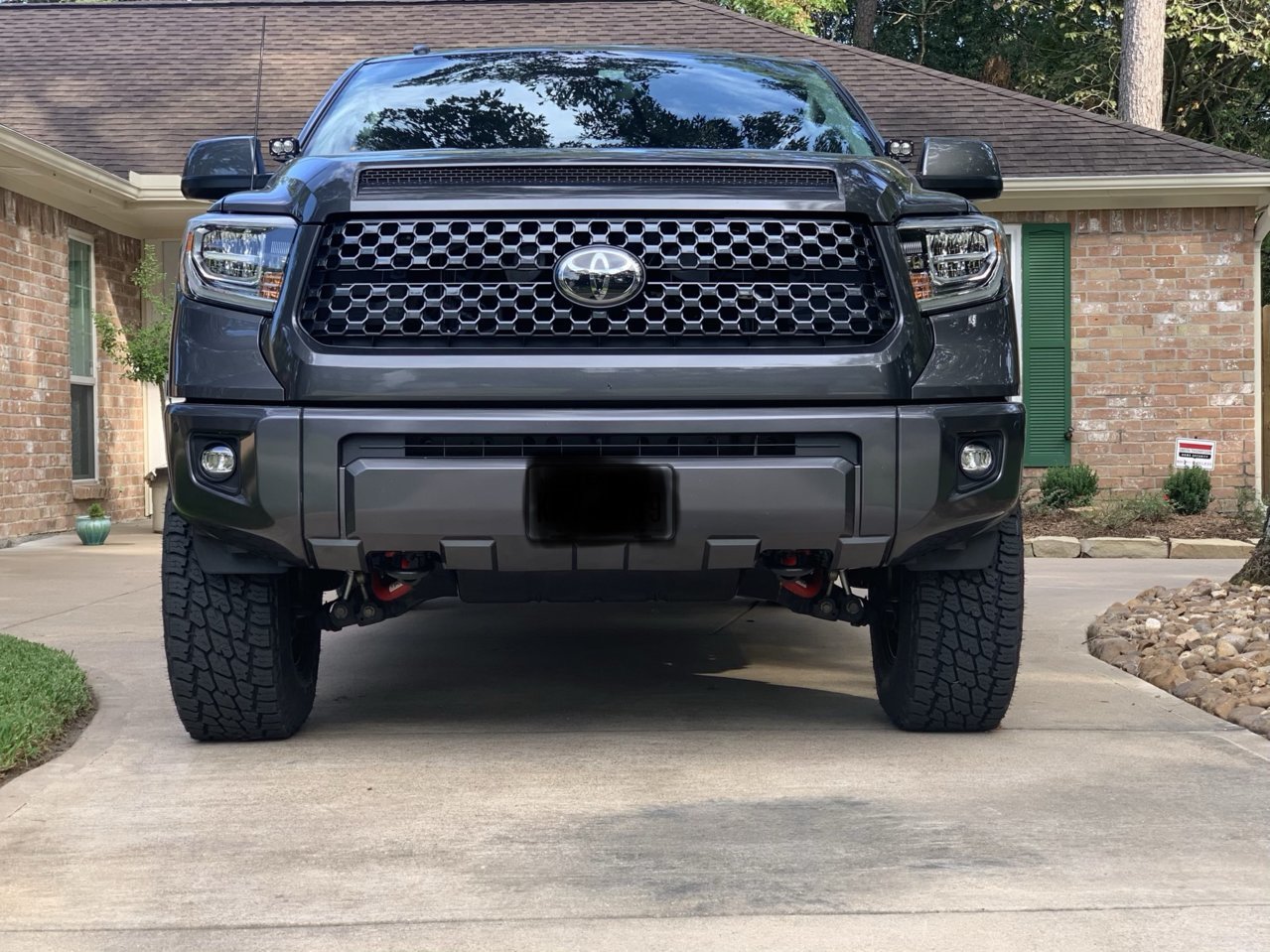

  17. Oct 23, 2019 at 2:05 PM
    #617
    MAGDADDY
    MAGDADDY TTC #280
    Aug 11, 2019
    #34446
    529
    JON
    Houston TX
    18 Platinum CM MGM
    Leer 100XL, Bedrug, Go Rhino running boards, LED int/ext lighting, Bilstein 6112/5100 1/2”shims up front, Coachbuilder +3 shackles, CB drop, TRD front/rear sway bar, 275/65/20 Michelin LTX M/S 2, sequoia painted mirror cap/door handles, Rago Fab low pro ditch brackets, Baja Designs S2 sports ditch lights. Baja Designs S2 sport rear flush mount pod
    112EA572-6509-40FE-B936-921B4868FB9C.jpg B351EAA4-FF74-4228-B20D-8C7AE3CB85A2.jpg B1775853-D344-427E-8900-89E90FC7AD8B.jpg
    Bilstein 6112 set at top 2.5” 2 cb shim on driver 1 on pass. JBA upper control arms, rear Bilstein 5100 with cb +3 shackles and carrier Bering drop. Wheels are 18x9 +20 offset tires 295/70/18 Nitto Terra Grappler. Before this truck I had a 15 tundra dc with a 3” spacer lift and had issues I ended up putting total chaos arms on that truck to fix my problems. On this truck I didn’t want to skip anything so I went ahead and did the UCAs with the lift. Picked JBA for price and reviews, and have enjoyed them.

    Thanks for the information. So why is the shim needed on the passenger side to fix the driver side lean? Isn't that basically the same as just doing one shim on the driver side?

    Just a little more height up front. David at cb suggested it since I don’t do much towing and wanted to get it as close to level as possible.
