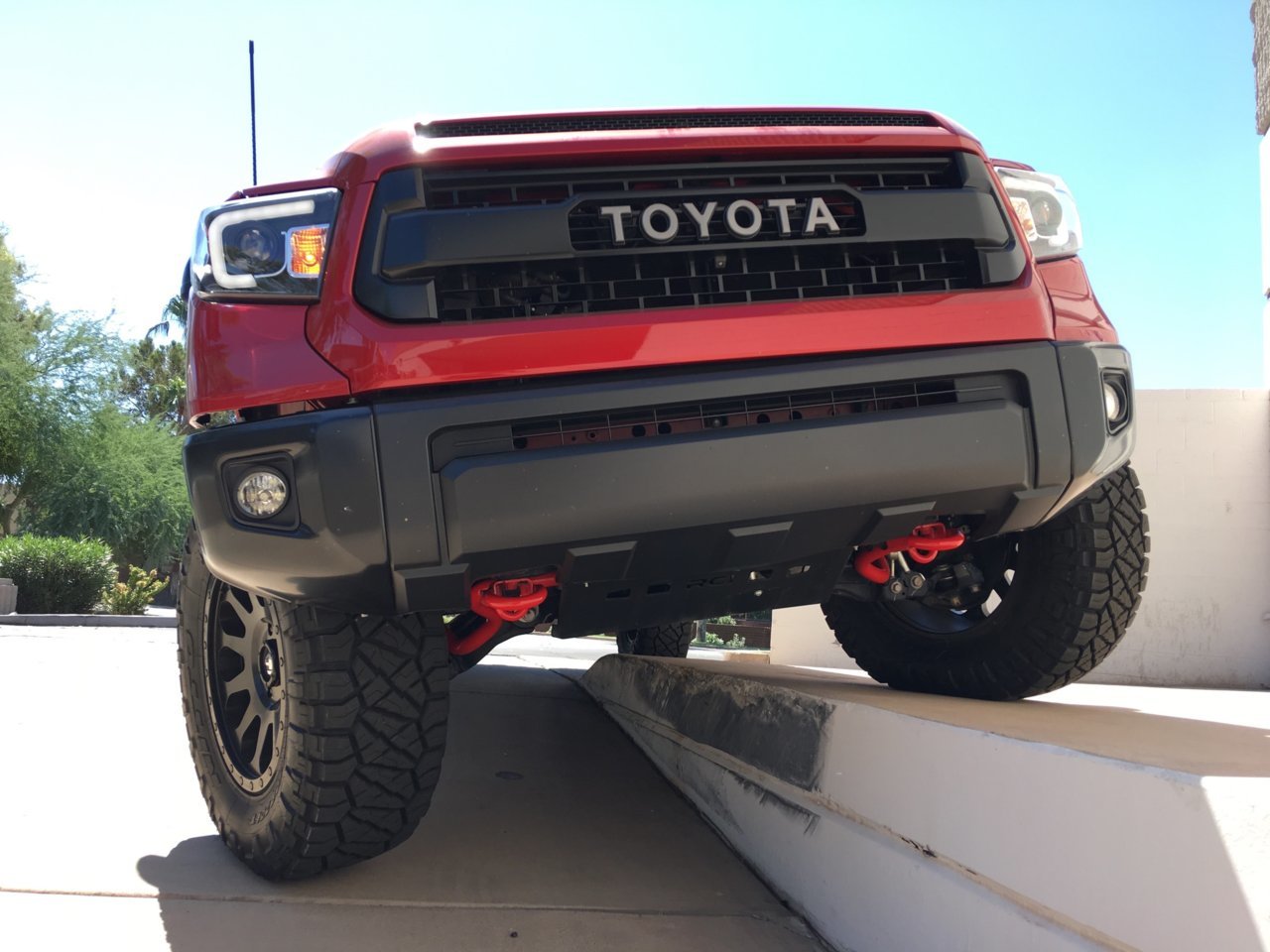

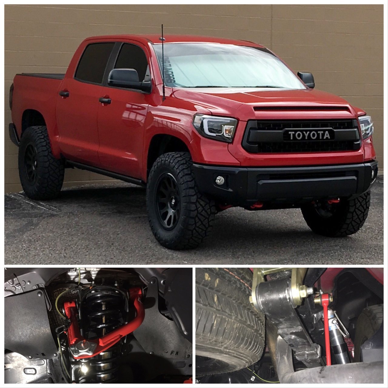

    3"/1.5" Lift (Fox 2.5 DSC all around, JBA UCA's and Toytec Shackles at 1.5") Front and Rear TRD Sway Bars Nitto Ridge Grappler 37x12.5R18 w/ Brz 18x9 +25mm Methods MR701 Wheels AFE Dry Filter with TRD Flow Acc Dirty Deed No Muffler Exhaust Nitro 5.29 Gears RCI Engine, Trany/Trans-Case and Fuel Skid Plates Relocated Rear Diff Breather | Rear Brake Line Extension Jomax ABS Sensor Armor Colored Matched Front Bulge and TRD Pro Grill Assy Modded ADD Stealth Fighter Front Bumper Custom High Clearance Rear Bumper with Modded Tow Receiver Behind Plate and Chopped Rear Fender Custom Bed Stiffeners 2019 TRD PRO LED Headlights w/ Ihacker Harness | BD 40" ARC AMB/WHT DC OnX6 BD 10" Onx6 in the Grill (2X) Rago Low-Profile Ditch and Extended Brkt with Daul BD Squadron Pros - AMB & WHT AMB LED Chase Light (Cargo) | Dual BD Squadron Sports in Rear Bumper Prinsu Roof Rack with a Pair of BD S1 For the Sides and Rear Mictunning C2 Rock Lights, 2 per wheel, and Toyota style switch 2X 55" Quick Light Whips with Toyota style switch Switch Pros SP-9100 with Custom Switch Mount, Custom Engine and Roof Terminal Junction Boxes 12K Lbs Smittybilt Winch with wireless remote and Factor 55 FlatLink E Amp Power Step EVO-One Remote Start Limo Tint (All Around) | De-Badged LED Interior lights with Front / Rear Interior Footwell LED Blue LED Lit Lock/Window Switch Mod AJT Full Chrome Delete Kit w/ 3R3 Painted SHCS Toyota LED Bed Lights Leather Perforated Wrapped Steering Wheel Black TRD Shift Knob ESP Long Box BakFlip MX4 Bed Cover Thinkware Q800Pro Dashcam (Front & Rear) Rago Dashmount w/ Ram Phone Holder
    Front: 6112 at top setting with JBA UCA's and 1 (1/4") coachbuilder shim at each side. 37x12.5 tires on 20x9 +20mm offset wheel.
    Rear: Toytec shackles at 1.5" and 5160.

    Works fine, even when the truck is on a frame lift and the axle at full droop my truck still has some clearence.

    The lowest leaf spring edge does hit the TRD swaybar at very end of the swaybar. I was planning to extend the end link anyway to level the swaybar so this problem will be solved.

    Did you have to do a lot of trimming for those 37s?? Sweet setup. AZTG represent!

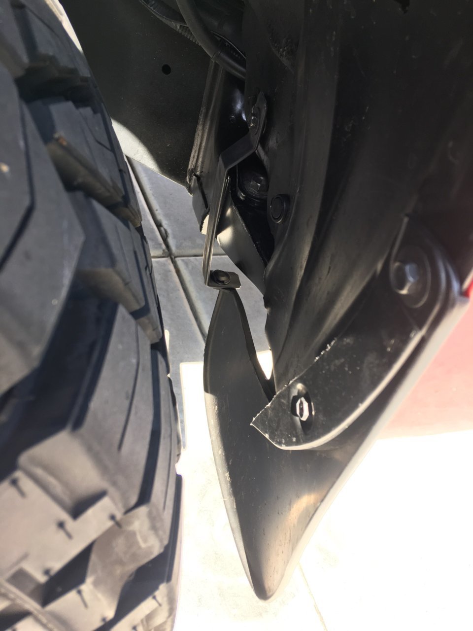

    Not as much as I expected. I folded the seam weld up to the 1st liner clip mount. The mods are circled in green, no rubbing at full articulation and at full steering lock. I even moded the liners and mudflaps for stock look, lol.
