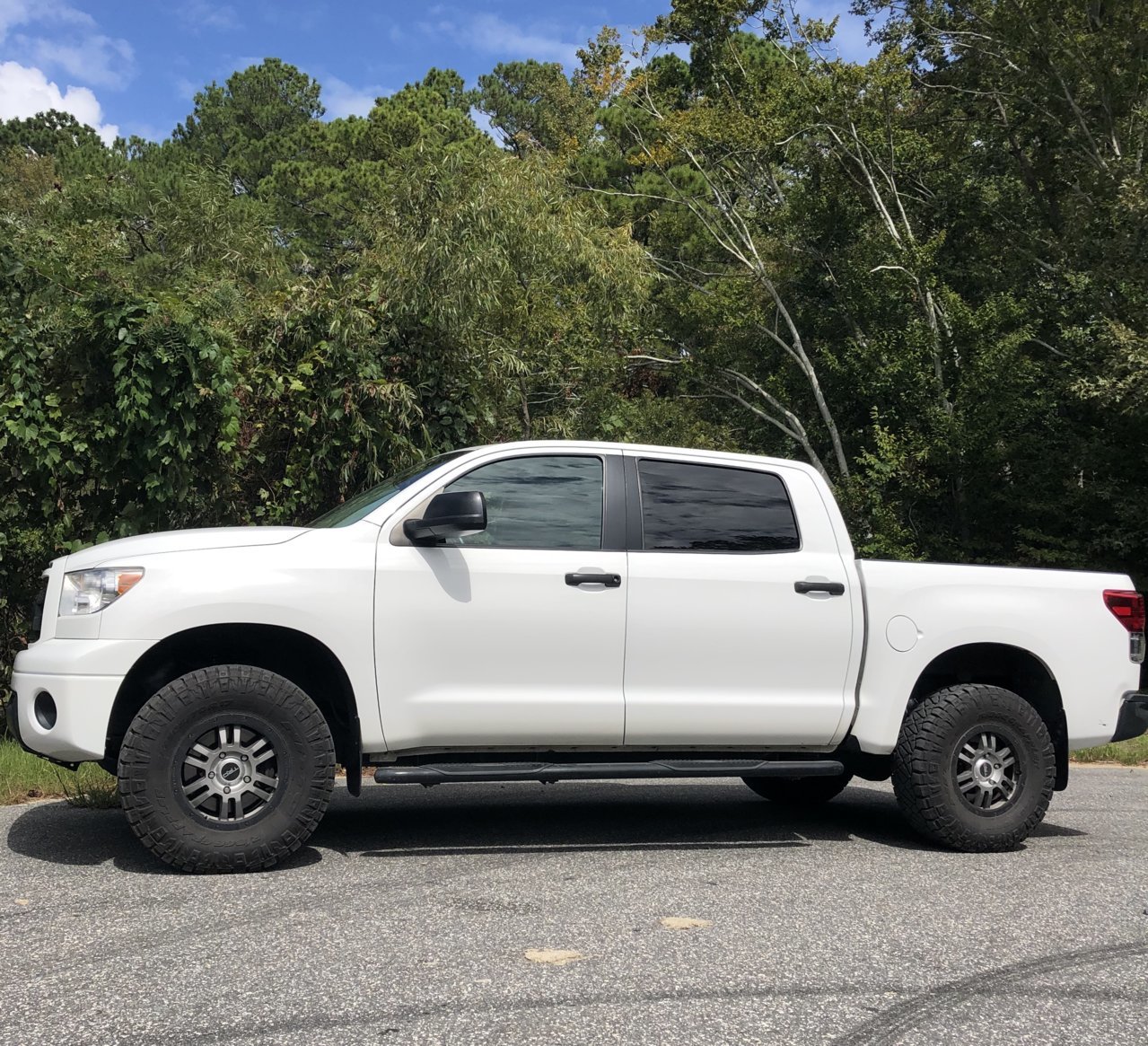

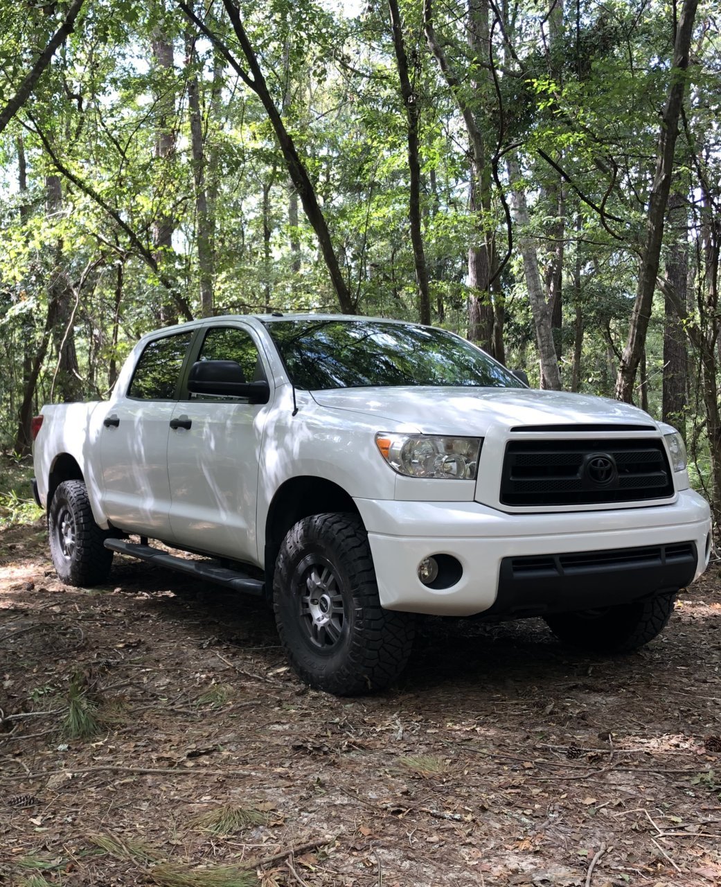

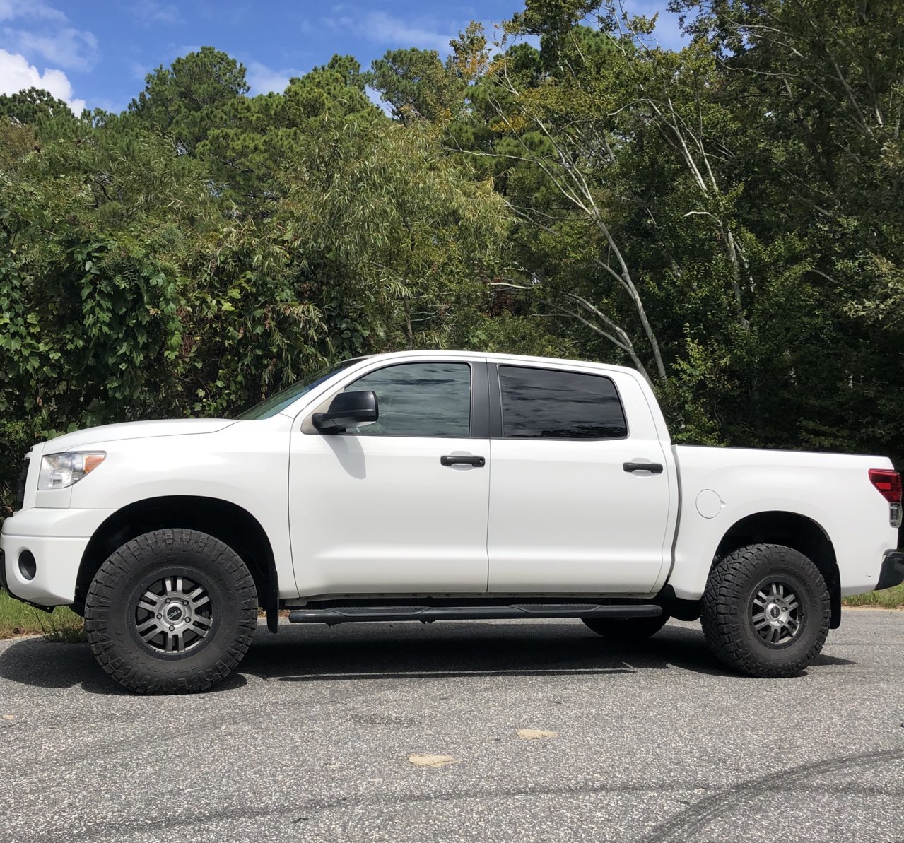

    6112 top setting no shims for now
    Stock uca
    5160 rear
    305/70/17 Ridge Grappler
    Rock Warrior Wheels

    Also big thanks @rons23 for confirming the referral I had to a local shop for install. They were great.
    rons23 likes this.

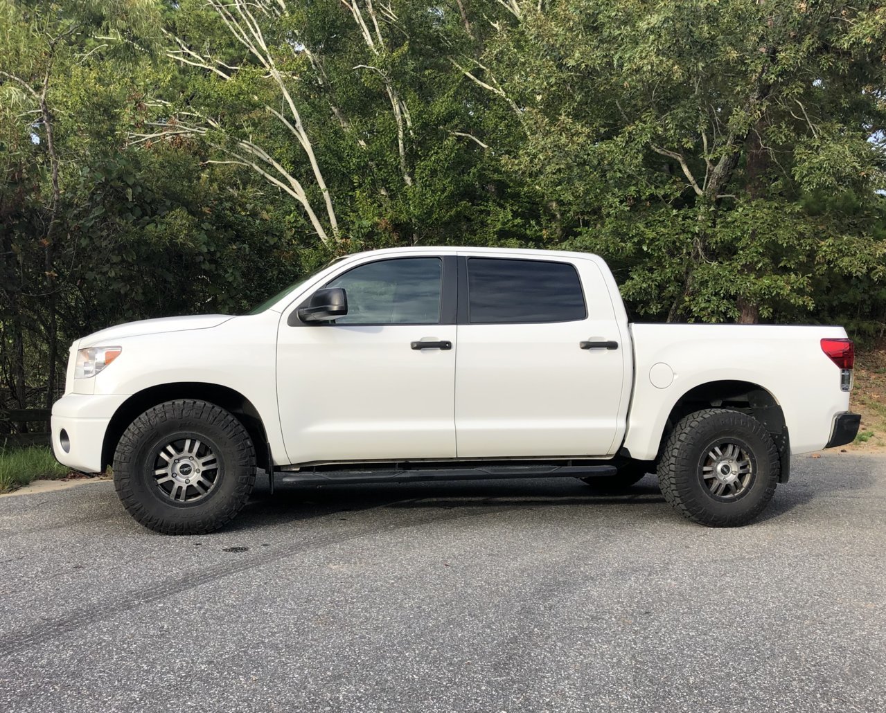

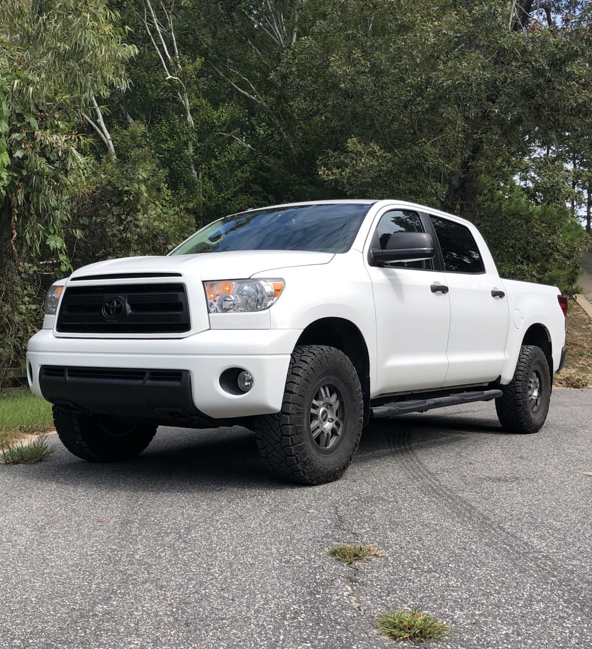

    Before pic
    After pic

    @trailrnr, Awesome man. Robbie is the man. Tundra looks great :thumbsup:. How do you like the ride?

    Robbie was great. Super attentive to details and getting everything dialed in.
    Ride is nice. I am coming off a pretty beat setup so I was definitely hoping for a noticeable change. And I am not disappointed.
    I would say the truck has better feel now while at the same time dips and bumps being nicely dampened. You simultaneously have better feel for the road while having less impact from rough spots. Went down the gravel road in Nags Head Woods and it felt awesome. Coming home down Colington Rd (for those who aren’t from here it’s a windy sometimes bumpy road) I was really impressed. Way more planted on curves and floating along over the chunked out spots.

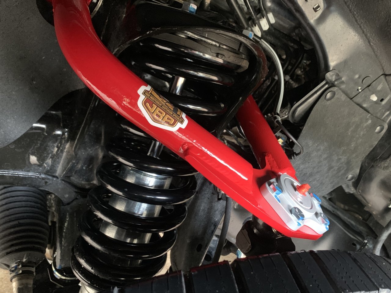

    I’ve got your set up too, I’m running some JBA upper control arms. They are beefy and work great. Check out JBA off road. CB040FFA-0CCE-49C6-B856-3F7EA4F22A57.jpg

    They look super beefy. Very nice looking.
