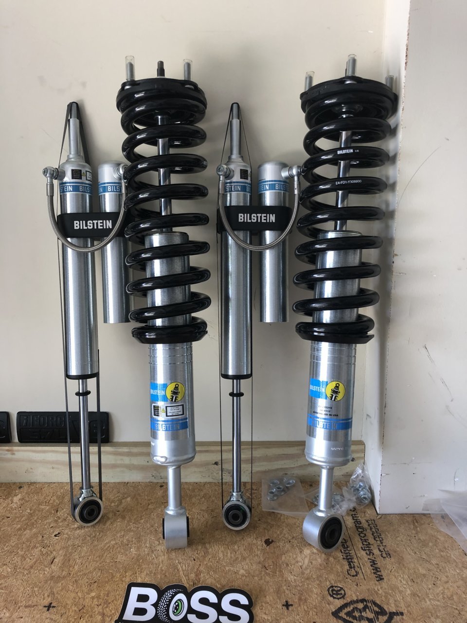

    Boss 4x4 Labor Day sale.
    Assembled coil overs for me and I just clamped on the billet reservoir holders.

    Mine should be coming from Shock Surplus soon! Sweet pic!

    Nice! Post up some pics once they are on!

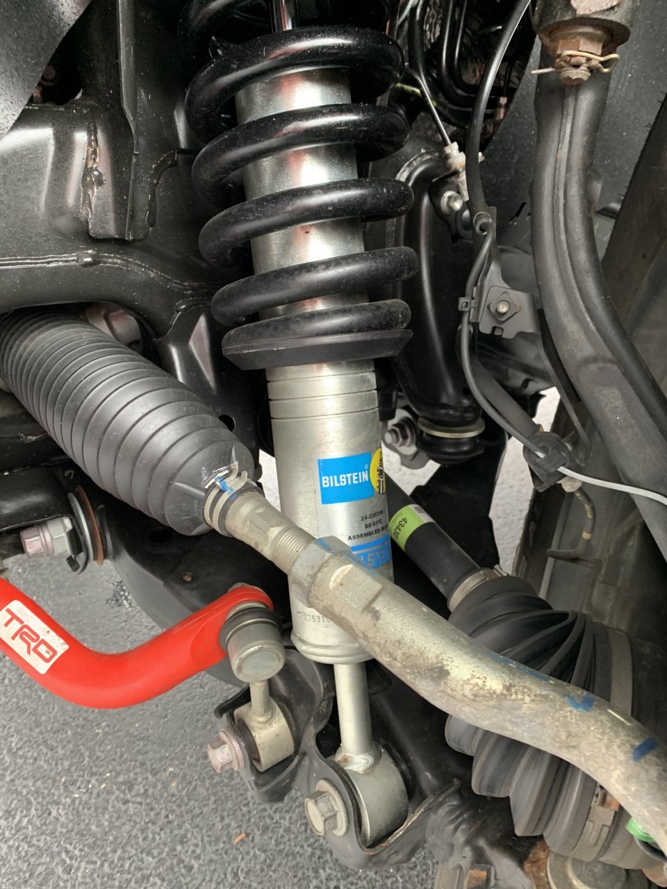

    Do you have a picture of the front shock?

    Mike19
    Mike19 New Member
    Mar 7, 2019
    #27224
    201
    Chi town
    2019 SR5 CM 4X4 TRD Sport
    TRD Exhaust, Bilsteins 6112/5100, CB Shims 2/1, CB +3 Shackles, Air Ride, RCI Engine and Trans Skid Plates, Cooper AT3 XLT 275/65/20
    Rica25[QUOTED] likes this.

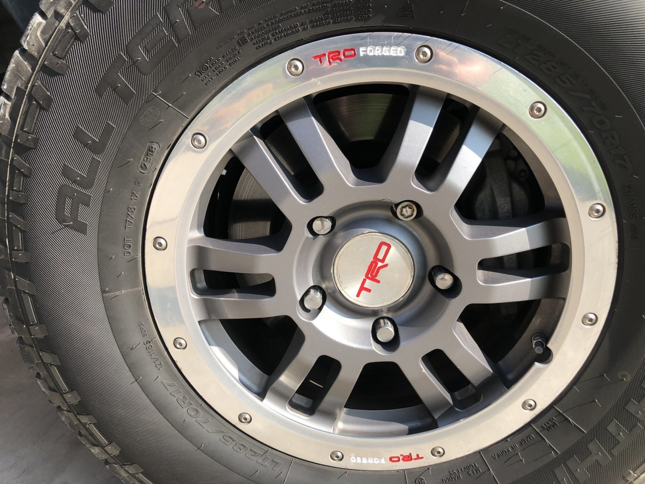

    6112’s middle setting 1.9”
    5160’s rear, no lift
    Stock UCA’s, no other spacers.
    Rock Warriors 285-70-17
    Truck remains a .5” rake.
    92B499FB-7AEE-4BF5-84AA-B49FE6A05775.jpg 65AA385F-721D-4203-9ABC-95E80292580A.jpg

    Dang those rock warrior wheels look new! Did you find new ones? Looks good with the 285/70's. :thumbsup:
  25. Sep 16, 2019 at 4:47 PM
    #475
    1794Hmoob
    1794Hmoob New Member
    Sep 16, 2019
    #36215
    3
    15 1794 Tundra CM
    Thanks! They’re not new but just in good shape. Need to polish the forged lip face so it’ll shine. I inked the ‘trd forged’ part with red and white paint to look a tad different.
