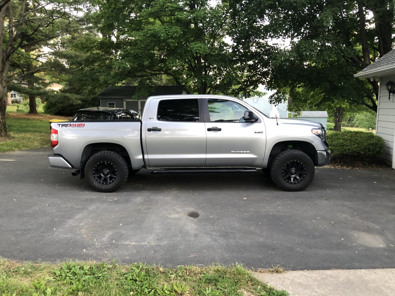

    Thanks for all the help everyone! Took about 6 hours of back breaking work but it turned out great. Those LCA bolts really were a bitch! Here is the final product. Ironman instead of 6112s.

    rear is setting lower than the front?
