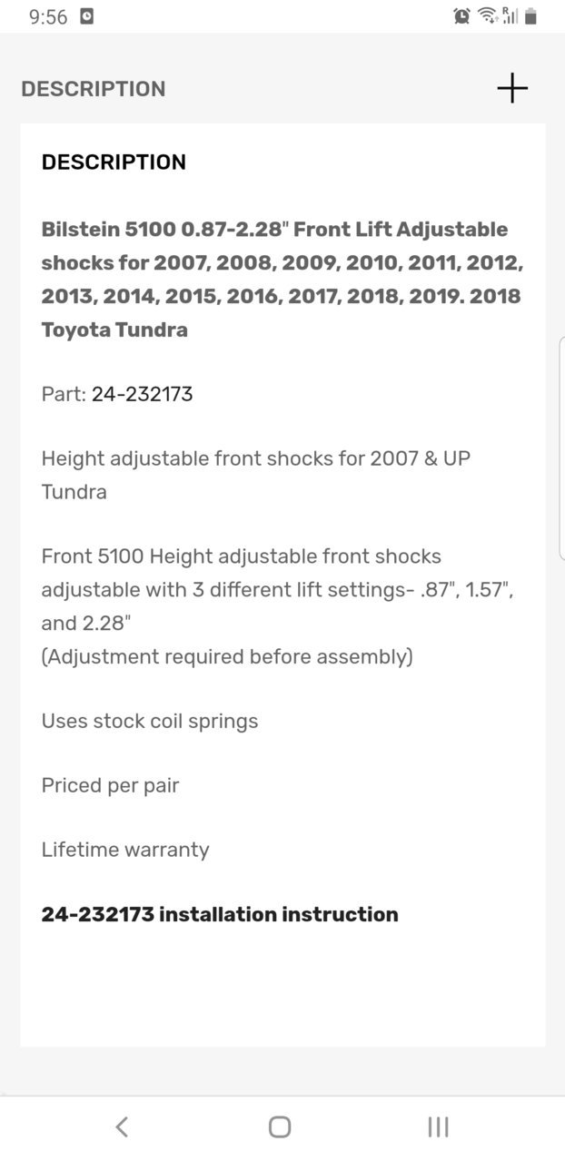

    Sorry to kind of bring back an older thread, but quick question. Would the ride height adjustable 5100's get you to the 1.9, and what shims are we talking about here?

  12. Dec 17, 2019 at 9:01 PM
    #42
    ez_day
    ez_day New Member
    Dec 3, 2019
    #39469
    9
    Aaron
    2015 Tundra 1794
    Tundyfundy likes this.
