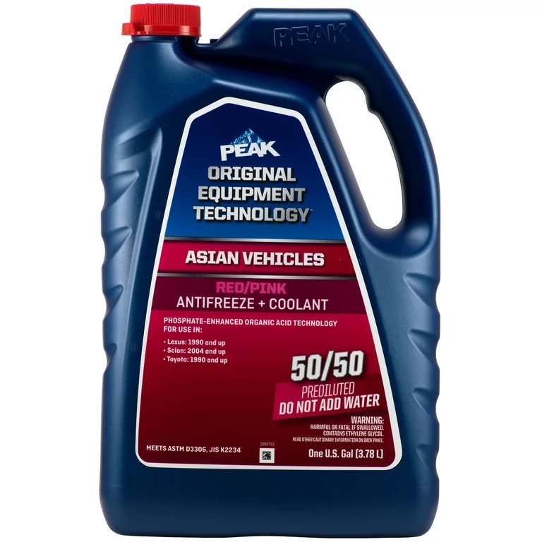

    On this note, while it may be too late, I use the peak OET coolant for toyotas. I run it in multiple toyotas I own and it does fine. Cheaper too and available at parts stores/Walmart.
