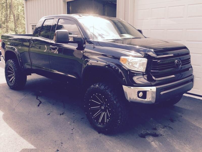

    Updates:
    1.
    I spoke with an attorney, and they said to go get the truck before they have a chance to do anything to it. It's sitting in my driveway right now. I took the liberty of getting a torque wrench to test the driver's side torque. Sure in sh*t, it failed the test. Videos below for your viewing pleasure! Bring more :popcorn:!
    Videos part 1 and 2:
    2.
    So as I mentioned, I brought it home. I looked at the service order, and it said I made a "right hand turn" which caused the issue. :evil: I wonder if this is all the confusion with everyone. Toyota isn't going to cover it. Neither is the dealership, neither is my insurance. So I guess that leaves me, huh? I'm done with this dealership. It will never go there again. By the way, every convo has been audio recorded, including my phone calls. My story has been the same since day 1. The dealership knows something's up: They offered to send me to a partner that does rim repair, and 'waived' my labor fee for this problem. So far, out of pocket is $0. Truck still isn't fixed though.
    The truck is going to an offroad shop this weekend to get some certified paperwork. Nothing on that front end is torqued within spec, and I'm blaming it on that. So is my insurance company. So will an offroad shop.
    3. I got a copy of every service order they had on the truck. 4 to be exact.
    1. Initial inspection and receipt of the truck
    2. Installation of the lift kit, tires, rims, window tint, and window deflectors.
    3. Aftermarket products (paint protector, underbody spray, etc.)
    4. This incident.
    So after studying the paperwork, #2 and #4 have the same technician. :facepalm: It's pretty clear at this point that the dealership is covering it up. Having the same technician check it out, taking the truck apart for an obvious diagnosis that could have been made by simply looking, the service order (#4) stating I made a right hand turn instead of a left, ToyCorp being completely unresponsive to any questions I had after the Regional Supervisor inspected the damage, etc. I didn't really check #1 and #3 yet, but I'm sure it's the same tech.
    P.S. When the hell would you use this icon? :violent:

    It is, there's a flat spot on it.

    According to the service order, it was installed by a technician at the dealership. It was done with 1 mile on the truck. The technician's name is on the order, and it isn't Charlie. I don't want to put his name out there though.

    After looking at the video now. There is ALOT and i mean ALOT of marks that are just plain wrong i mean REALLY WRONG. You have paint missing on the coil in more than a few places. That tells me you have some motion in there that shouldn't be. To me the shock looks to far extended. Upper and lower ball joints looks like they are near MAX if not over. That said the stress levels on the cams is very HIGH for a stock LCA with larger wheel combo.
    Imo there cheap way of doing the lift is BITING you in the :censored: badly. They have changed the geometry so much and using factory parts. factory parts and ball joints where not designed to handle that load and stresses at those angles you will have :violent: failure in time.. Tundra is a HEAVY truck.
    Now bolt torque is questionable. Not only could you move then one makes me wander what else. Those bolts are flange nuts (locking nuts) but with the video, i wander if the back side of the nut is smooth not ridged like it needs to be for locking. Someone can not tell me no one has messed with those UCA bolts at least 10 times plus with the marks before you touched it. More red flags.

    Agree with Mike. Most dealerships throw a cheap block lift on with no regard to geometry. The truck may look good, but it's going to have issues.
    Some of those bolts are torque to yield, meaning one time use. Even if they only had 1 mile on them, they should have been replaced with the lift.
    Everything points to shoddy work.

    On Friday, I got a call from the "winning dealership" who stated that the FR and RR camber bolts were torqued under spec. Specifically, 150 ft. lbs. Hmm... Sounds about what an impact wrench would torque to, right? They also inspected the rest of the suspension and didn't find any other problems which is kind of weird. But still not a bad find, considering the installing dealership hadn't touched the rear of the truck during the initial findings.
    I immediately called Toyota Corp. and let them know about the findings. They reiterated that I would be responsible for the diagnostics fee for the incident because they have already denied responsibility. The case manager for ToyCorp called first thing this morning to get some more information on the findings. He said he was going to call the "winning dealership" to see what information they had. About 20 minutes later, he called back and said that ToyCorp's decision still stands -- that they weren't going to cover it. I reiterated back to them that I wasn't expecting them to since it's not a manufacturing flaw. I also reiterated that I expected them to push back on the installing dealership to get this issue resolved, and that I have an attorney on retainer. Of course, they didn't have a comment about that. He just said "I'm sorry you're going through all this..." as if it was supposed to make my day or something.
    I called the installing dealership after ToyCorp and spoke with the Customer Relations Manager (CRM). I explained the phone call I had just received and she acted like she had no idea what I was talking about. I understand she may not know the technical aspect of a vehicle, but this is getting crazy now -- she should know what parts I'm talking about, especially as long as this has been going on. So she puts me on hold for about 5 minutes as she looks for the Shop Foreman (the guy who called me a liar to my face). She comes back empty-handed and said that she'll have him give me a call back in a few minutes. To date, still no phone call.
    I've been trying to get a hold of the installing dealership all morning. I think their phone lines are down or maybe my number is black-listed; my phone rings once and hangs up. I tried 3 different numbers and finally got through on one of them. I was forwarded to the CRM and had to leave a voicemail. That was at 12:35pm EST, and it's now 1:08pm. Probably at lunch or something. I'll give her till 2pm and call back. I'll have another update after this.
    I called the "winning dealership" after I left a message with the installing dealership to verify what had been done. In particular, I was curious about the caster bolts as well as the strut assembly bolts/mounts. She said all that was checked and looked good. Then I asked if I could have an estimate to fix the truck. She said the only way they'll fix it is to put a new chassis under it. They won't even attempt to weld new eccentrics to the frame. I think she wanted to close the gap of liability just in case the repair failed. She's drafting an estimate now and will be sending it to my email. :pout::evil:
    In the meantime, I think it's time to call in the troops. I'll be getting a hold of some TV stations today and see who's "on my side". I'm done with the games and I just want a new truck like I'd bought.
