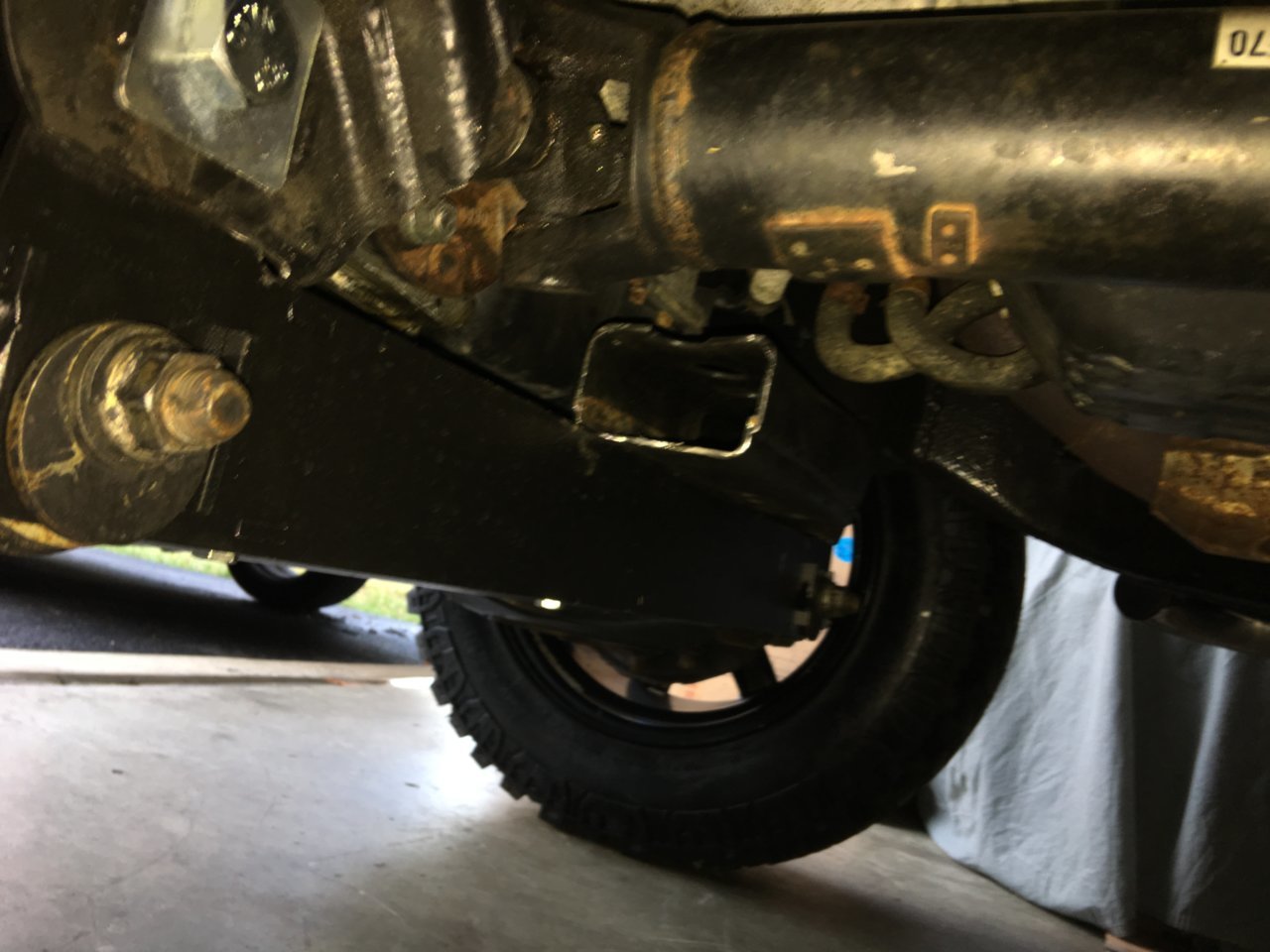

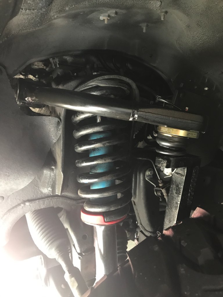

    I hope you can see from the thumbnail. This is basically my setup
    The 6inch RC
    The SPC link. Also watch the video
    Truck recently
    The adj SPC UCA and shocks without RC shocks
    Underneath with cut crossmember
    Let me know what else is needed
    Watch at 3:14 how the shocks travels easier in the adj SPC.
