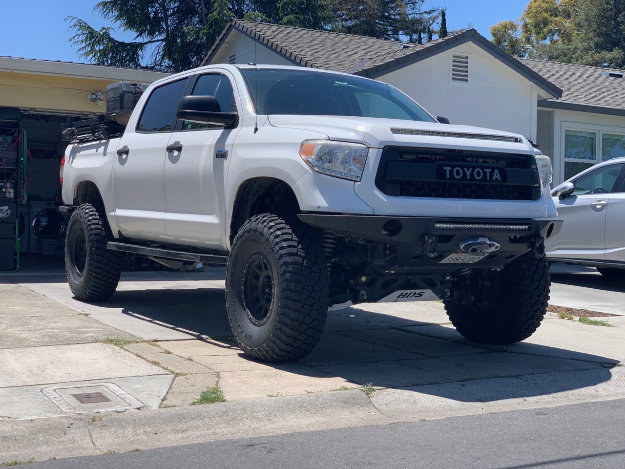

    2017 Blazing Blue Tundra
    7" BDS
    Factory bumper did some trimming and also cab mount chop to clear.

    My wheels are 22x 12.5 and tires are 37x13.5x22 so they do make them. It's better to have the tires bubble out past the lip of the rim.

    No issues with 13.5 on zero offset. But why stop at 38s?
    How about 39s?
    Or even 40s?

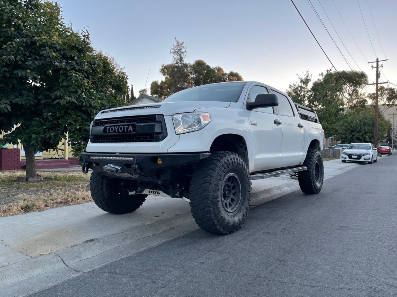

    Atturo Trail Blade Boss MT 40x13.50r17

    I don't like them because they are E rated - too rigid for me but I picked them up on Craigslist... $500 for a set of 5 tires, couldn't pass that deal up. My next set will be C rated (probably Mickey Thompson Baja Pro XS), which will be more pliable and will flatten out more when I air down.
