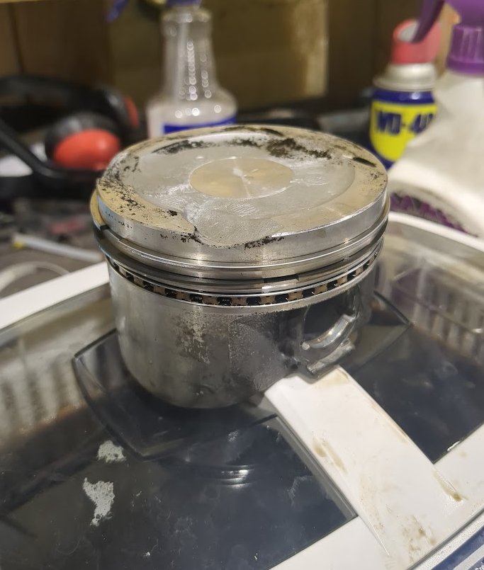

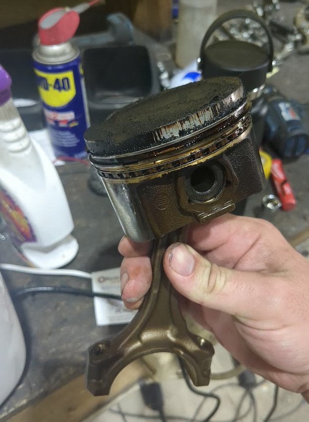

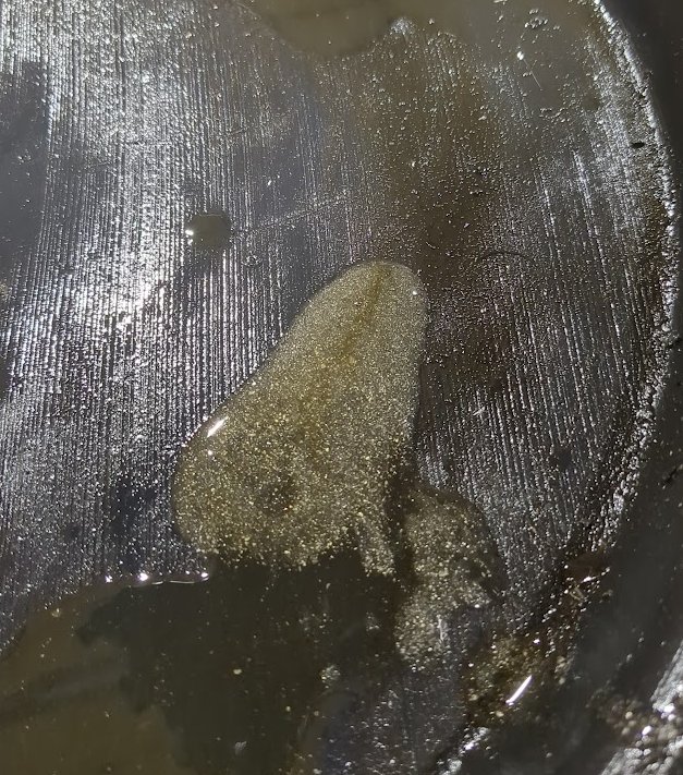

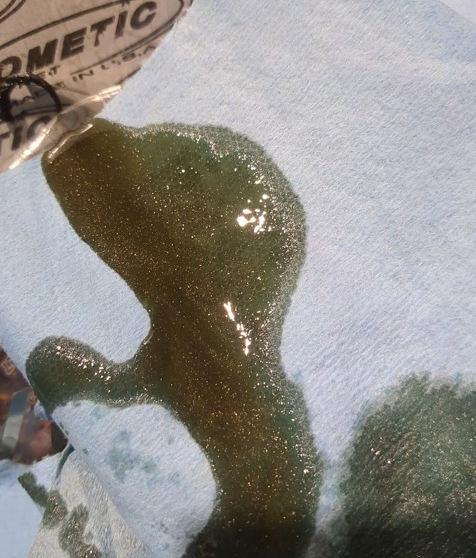

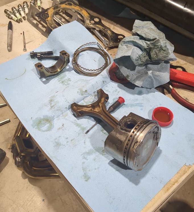

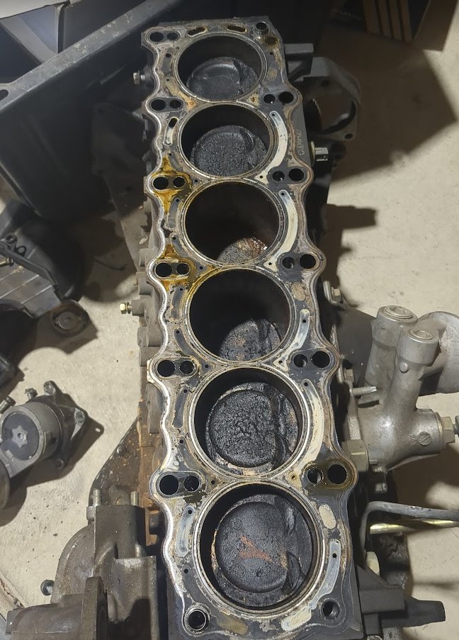

    Today I tore the spare engine down, it definitely saw some shit in its final moments.
    What the fuck is even that?
    I took piston #1 because it vaguely looked the cleanest? I doubt it mattered, besides maybe that mega squanchy one.

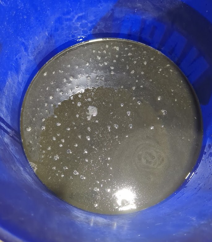

    I had a tub of purple power cleaner so poured the remains of it into the sonic cleaner and let it sit for 20 minutes, and it looks nearly brand new!
    After consulting with some friends, it was established that the mis-matched interface would be between the wrist pin and piston. Both wrist pins were the same, so it seemed to make sense to swap only the piston over so there's as little mass above the mis-matched interface.
    And since we're ballin on a budget here, I just kept the rings the piston had on it. I also didn't have a small enough ball hone so just took some scotch brite and roughed up the cylinder walls a bit, though they still had cross hatching left but it made me feel a little better. And back in she went!
    And that about wraps up today. Until I get the head studs I'll just do other things, like painting the valve covers!
    An extra treat from the spare engine is it has a Fluid Damper, which appears to cost $400+ by itself, so I'd say that $300 engine is more than paying for itself right now!

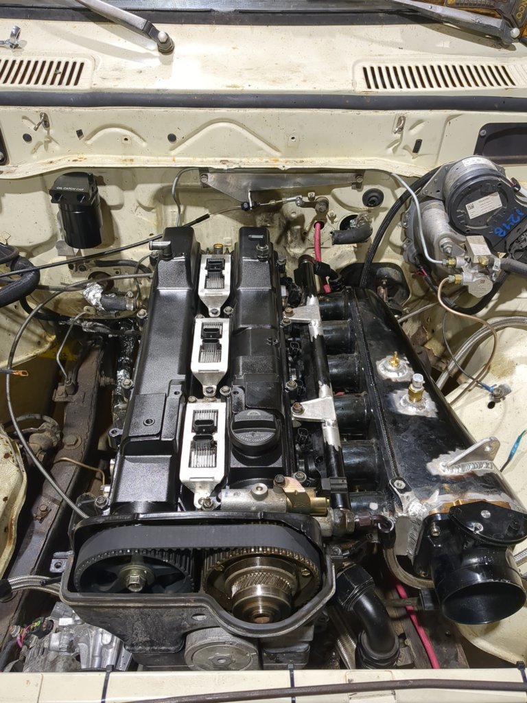

    Got the head studs today, and she's back together!
    Some exhaust upgrades to do tomorrow and she should be driving again! Not a bad turn around time from tear down.

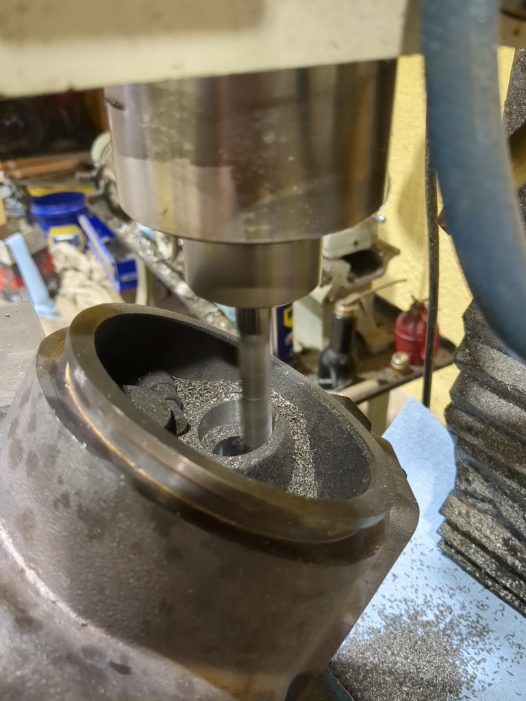

    Was going to save it for the next update, but yes! Yesterday machined the wastegate hole from <0.75" to 1.125" which is a ~2.25x increase in area.

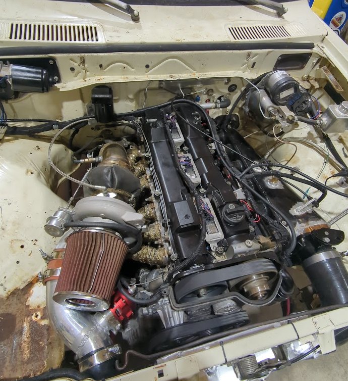

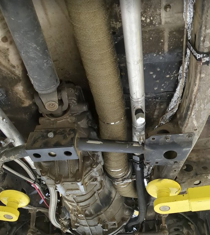

    Wow what a week! We'll see how much I actually type out or say fuck it.

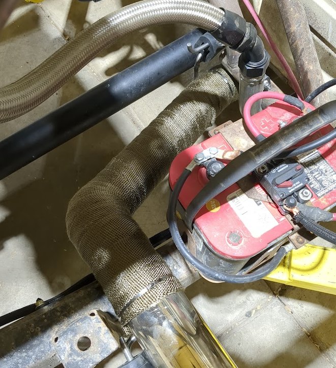

    Exhaust got wrapped, including the header and a turbo blanket.
    At this point, the engine is back together and running! After warming up the oil pressure is a bit low, 18-20psi at idle which is weird because it used to be at 35-40psi at idle. But revving it just a little and the pressure jumps up, so while concerning and odd it is running fine and does have fine oil pressure--just a lot lower than before.

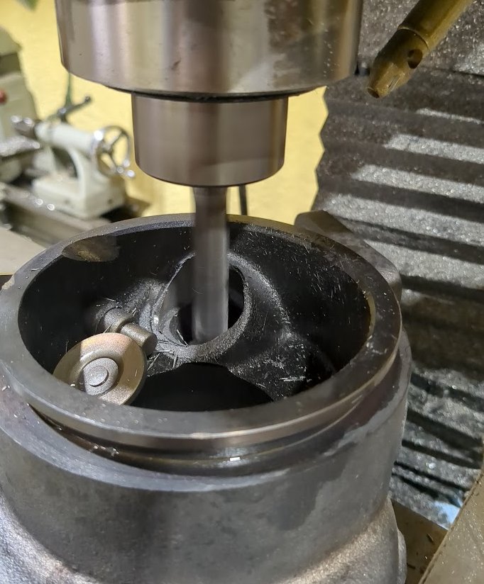

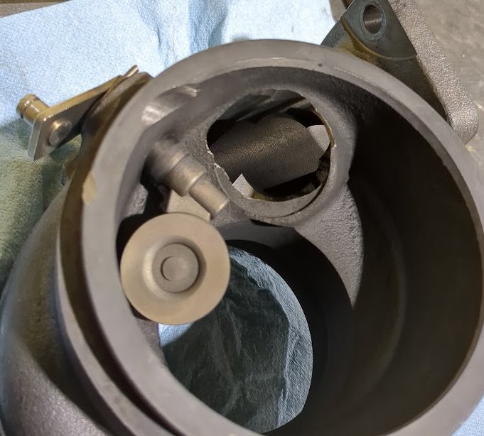

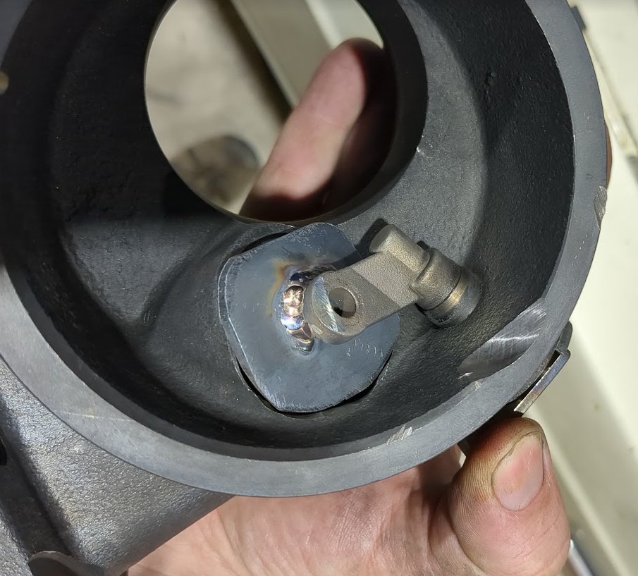

    I take it for a drive to test the amount of boost since porting the wastegate, and at 60% throttle and 4800rpm with the wastegate all the way open and it's already making over 10psi, so take my foot off the throttle to not overboost it and the engine dies. It was kind of odd, but I didn't think much about it and pulled over to check things over. I then cranked it and it wouldn't fire. Nothing from the datalog was showing anything weird, but I called my neighbor and his brother came and towed me home. On the way back I popped the clutch to roll start it and it fired right up, but when I got home it wouldn't start from cranking, so we again roll started it. After that I screwed with the cranking parameters and then it seemed to fire up fine. Why did it die on the road? No idea. But the starting was maybe just related to poor tuning? I had changed a fair bit in the tune, richened it out, changed timing, but I didn't change anything at idle or for cranking and it had never had an issue cranking before this so also odd.
    I decided to port the wastegate even more, if I can't get the turbo to make lower pressure then I'm kind of hosed since the exhaust is built for this style turbocharger and it'd be a lot of work to redo it. I absolutely go to town on it, rotating the turbo all over and absolutely hogging out as much material as I can, and with a focus of angling the wastegate port down towards the exhaust flange to try and get smoother airflow into the wastegate instead of the abrupt angle it had before.
    It's not pretty but this is what peak performance looks like :D
    I cut the flapper off and make a new one to vaguely seal it up. I'm not worried about a perfect seal since it spooling up fast hasn't been an issue.
    I finish that last night, get the turbo thrown back on and go for a rip to see how much boost it's making now. Somehow the truck making too much boost has become a big issue ironically.
    The boost was a lot better, a couple psi getting on it (with the wastegate totally open again). I decided to do a full throttle pull to red line to see what the max boost it would make was. At 7000rpm it was making about 10psi, which is great! I can have the wastegate closed to spool it fast and then once boost is reached the wastegate can fully open to just hold at 10psi!

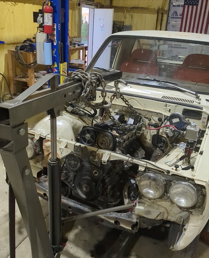

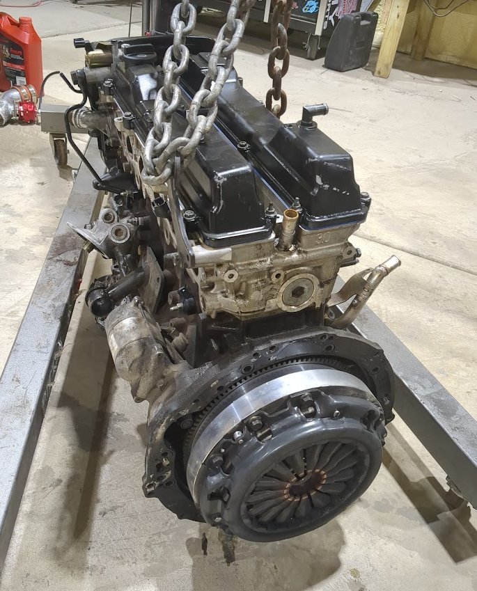

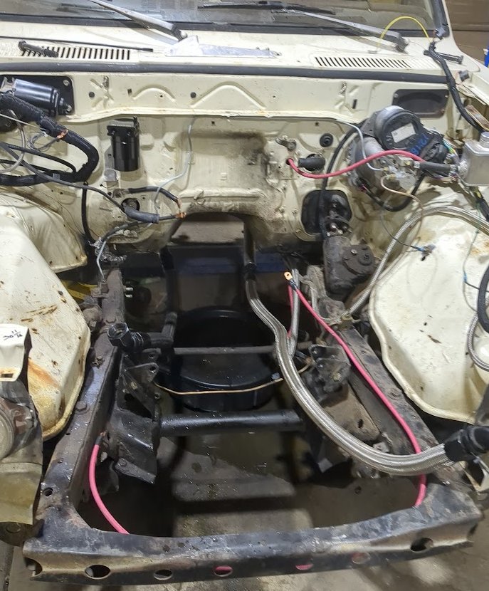

    So this morning I started to pull the engine, one of my friends came over and helped.
    That little beam of the core support that the hood latches to was a bit in the way, so we cut that out. I'll make some brackets so it can be easily installed/removed.
    And by noon we had everything out!
    First time the engine had been out since I installed it.

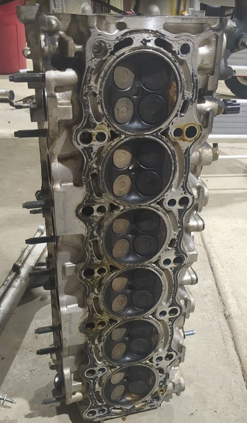

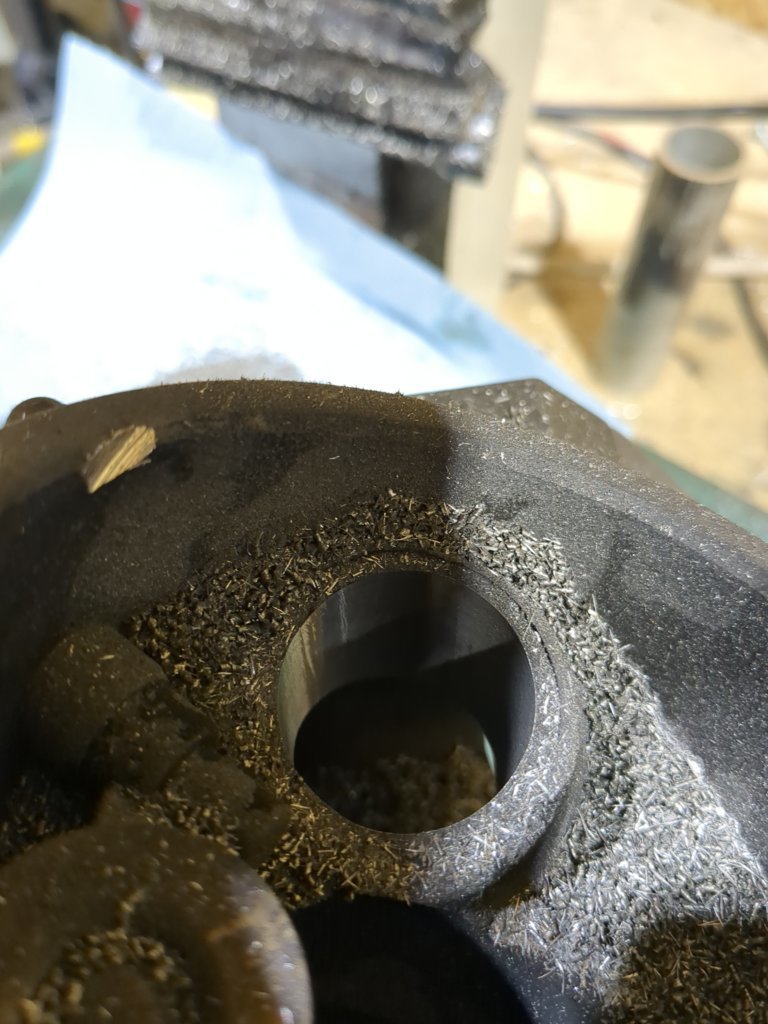

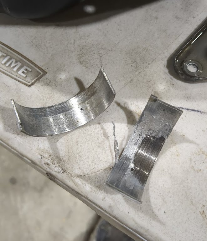

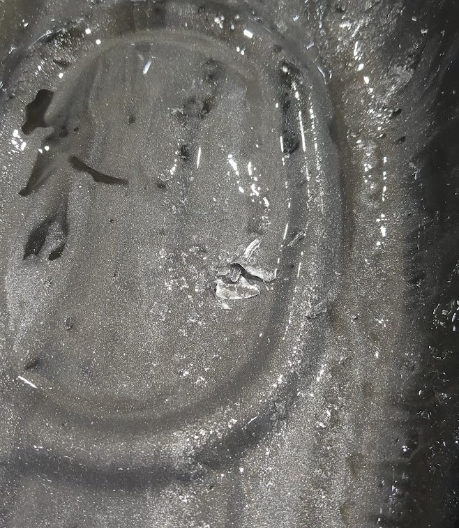

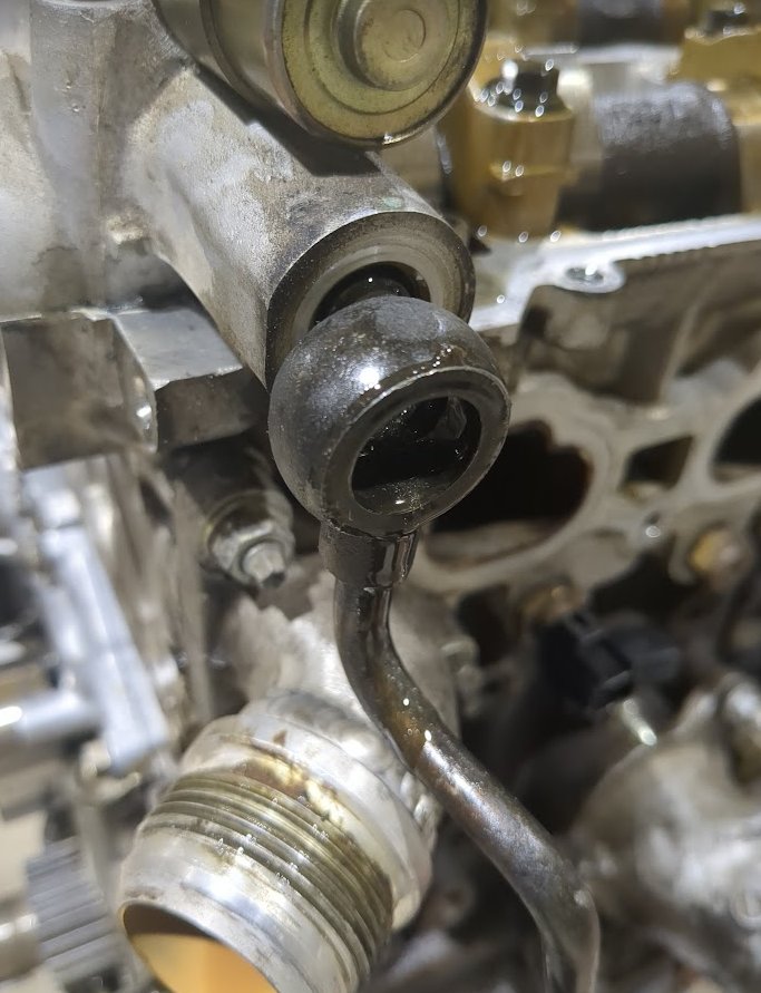

    Tearing into it, metal everywhere obviously. A LOT of metal came out of the VVTi port.
    Highly concentrated there! There's a filter at the VVTi port. I think the engine started eating itself and that clogged the VVTi filter and that's why it wasn't doing what it needed.
    Some big chunks in the oil pan!
    And the grand finale!

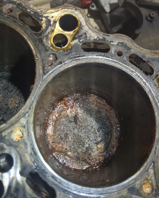

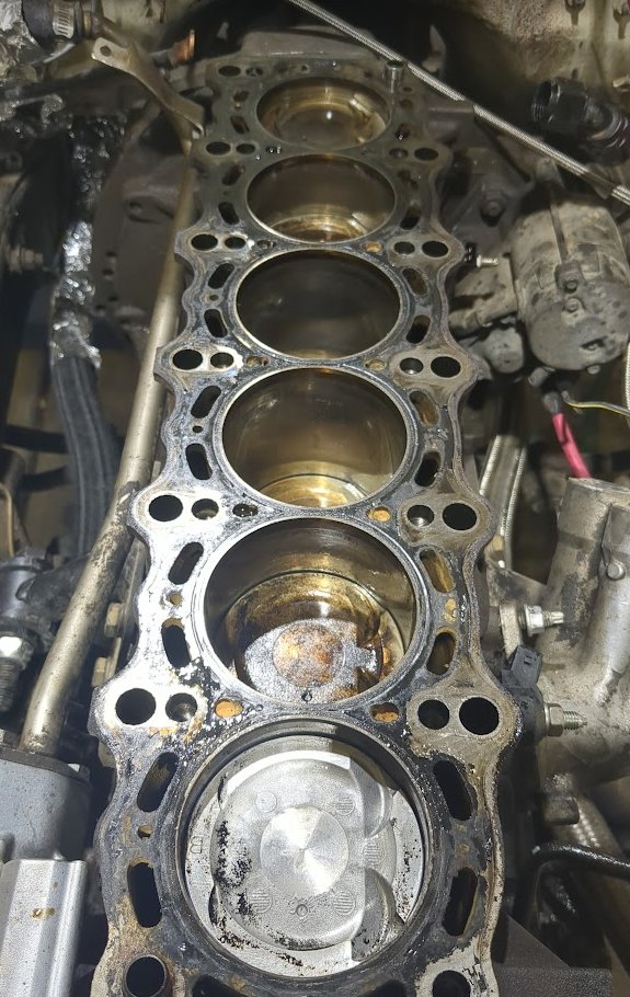

    And of course, from cylinder #1, the one I just swapped parts into. These are the rod bearings going to the crank.
    When I pulled the bolts they were suspiciously not tight, certainly not compared to the other rod I also pulled. The consensus was the rod bolts were torque to yield, and I just tightened them to the same torque spec as an unused bolt. That was too loose, so right off the bat the #1 rod was bouncing around, and the more it bounced the more it wore out the bearings, the more the bearings wore out the more oil pressure was getting bled.
    I had thought about reusing the rod bolts, but I said fuck it, how much of a difference can it be. You always hear of people reusing bolts on heads and stuff and how it ended up fine. Well in my case it wasn't fine!
    I pulled #6 just to compare, and at least the crank looked fine on #6 and there was still bearing material left. The crank on #1 is scratched up, it can probably get polished out or I will just use the spare engine's crank.
    So now the question is, what path to go down? I had instantly jumped to the thought of fuck it, build the thing. And really there's not much to build, just do new rods and pistons while it's apart and drop it off at the machine shop and make it nice. The whole engine needs to be torn down to clean the metal out anyway. I'm still leaning towards doing that, I don't want to tear into the engine again just because a rod bent or another ring land breaks. I want it to just be overbuilt and not worry the turbo is making too much power. Though some of my friends have different thoughts, clean it up, use the pistons and rods in it, just fix what I have since it will still make plenty of power and put the money from the other parts towards other stuff and does the little truck really need to be capable of tons of power? I don't know, there is something to that too.
    At a minimum, my plan is to drop the block off at the machine shop, probably Tuesday so it at least gets in the que to get flushed and cleaned. What an adventure!

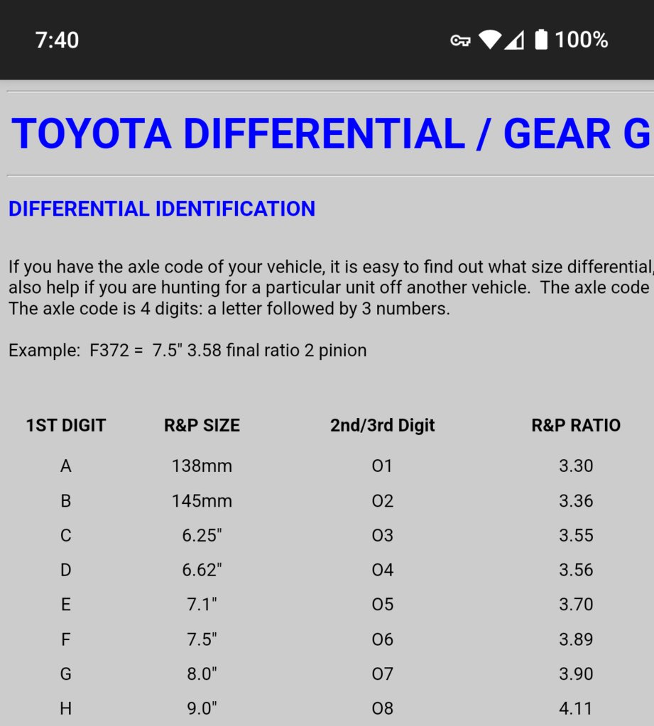

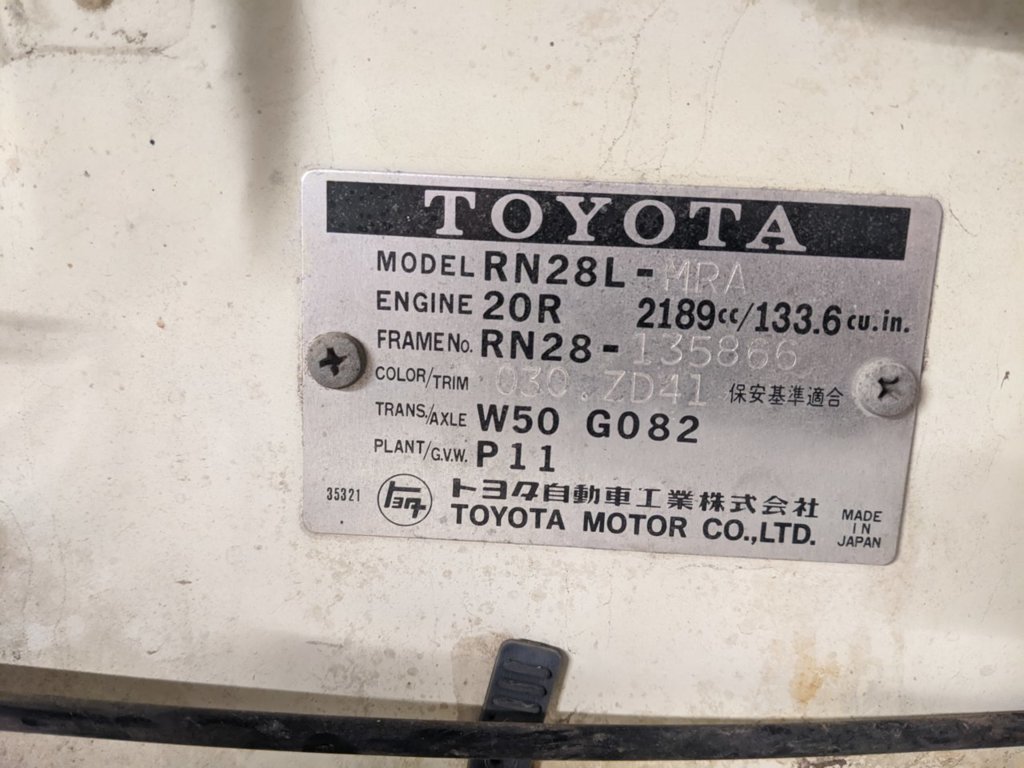

    Oh wow lol 4.56s, you sure? What's the axle code on the metal tag in the engine bay say? That's an uncommon factory ratio imo. Almost all 2wd trucks pre tacoma got the 5 lug axle with 7.5" gear whereas the 4wd got 6 lugs with 8" gear. The mk3 supra runs 8" gear and some have fitted the lsd carriers into 4wd trucks. The mk2 supra runs a 7.5" gear so I wonder if those guts would fit the 2wd trucks... 3.73s with lsd was an option in the mk2. Could even swap in a complete 8" axle from a 79-85 pickup depending how much wider it is. Would open up gear options and it's stronger with bigger drums. Or you could just build a 9" haha

    I didn't realize all 2wd trucks had the 7.5", I thought it was some funky size that predated the 8". I was 90% confident from spinning it, but looking up the axle code it says it's a 4.11 8" so I guess I have no idea what's actually under it :rofl:
    I appreciate the offer, I should be able to find a 8" around here from one of my Toyota friends though. But I don't know if there's Toyota gears that are high enough to drop the rpms down, the 350Z axle ratio is 3.54, and I've read about 3.58 Toyota gears and tried to buy them but never got anywhere with that so not sure they even exist.

    So the automatic 350Z came with a 3.3 ratio vs the 3.5 with the manual trans. I found this out the hard way because some asshat sold me a stock VLSD pumpkin with a 3.3 instead of the 3.5 he advertised it as.
    My vote says swap in an entire subframe from an auto 350Z and get the IRS back there. Should be plenty of them in junkyards. And plan to upgrade the axles when you snap them.
