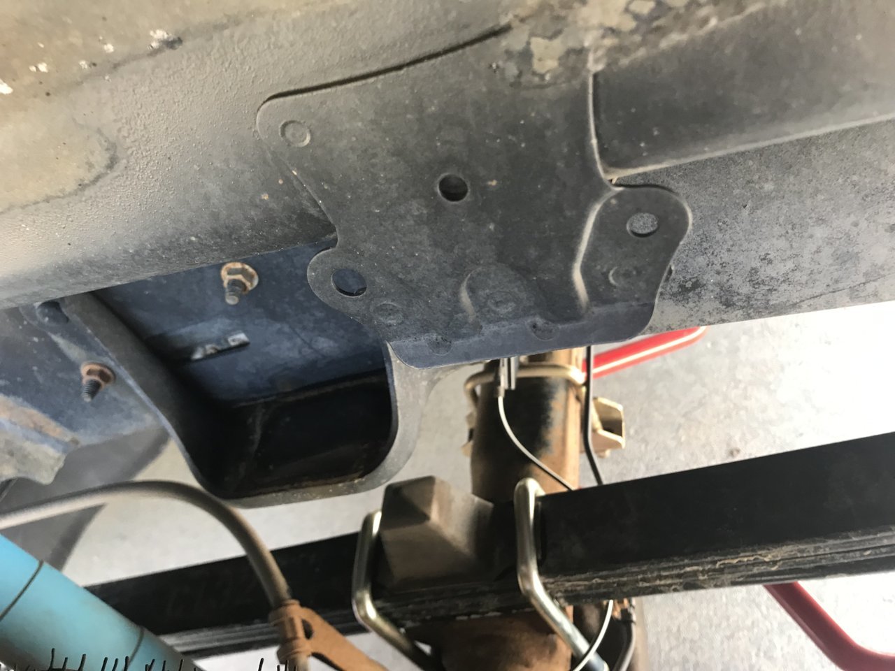

    The part you’re referring to on the bottom of the leaf spring is called a centering pin.
    I would recommend loosening the U bolts on the opposite side so the whole axle can move around better and the centering pin will seat in the hole on the spring perch.

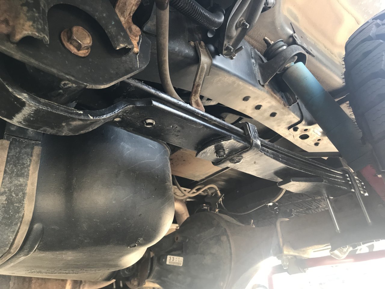

    It’s all apart on both sides at the moment, I managed to stick the new leaf spring in the passenger side and loosely fit the 3 bolts but that’s it...

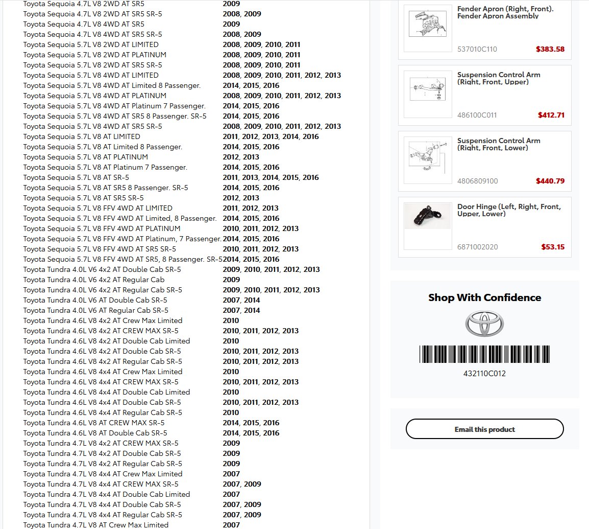

    I like hearing this. I couldn’t imagine going thru all this only to find they don’t fit. Still wonder why they’re listed as 2012+ tho...

    I’ve been emailing him tryin to work it out, thanks for lookin out!

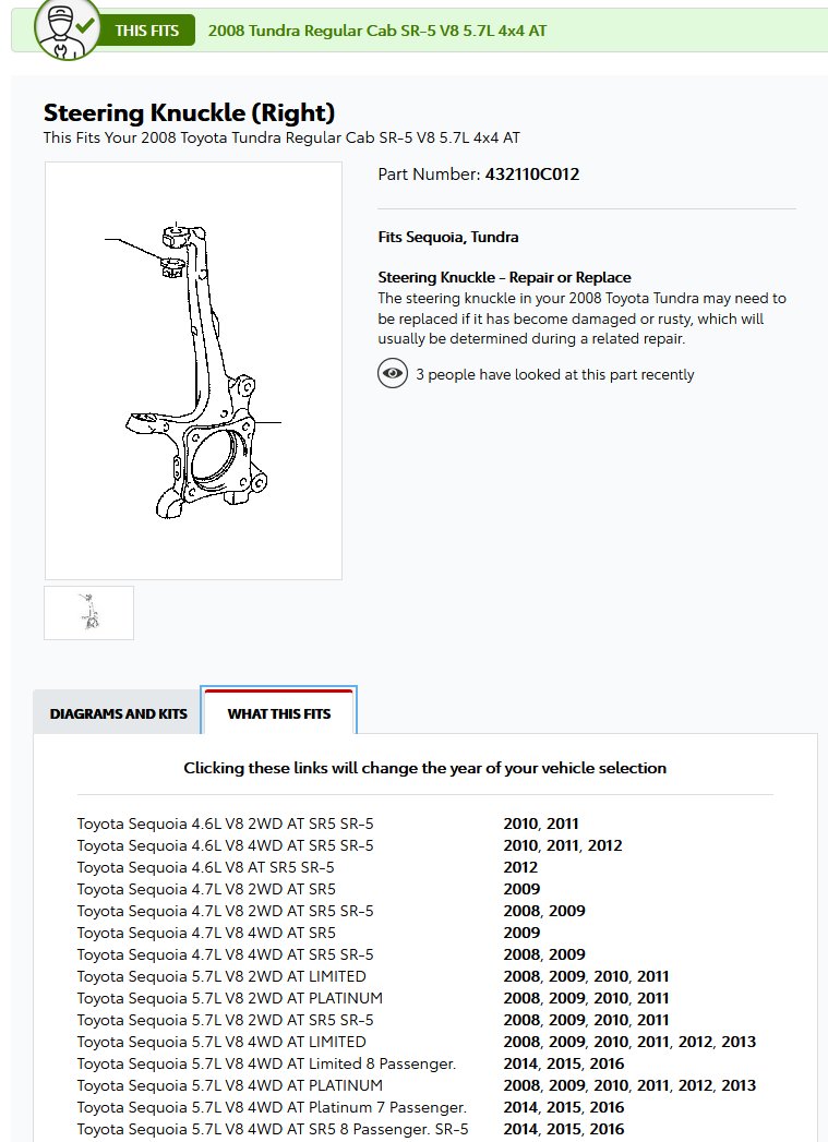

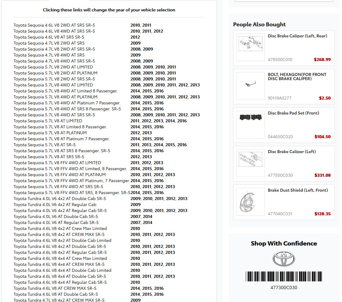

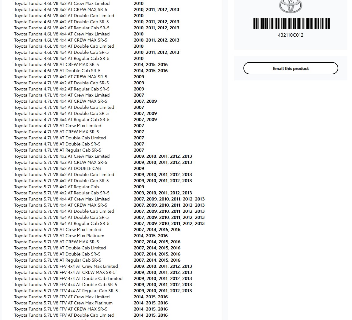

    Wrong. I just talked to Kibbetec about a bed cage for my long travel setup. It was for '07 to '13 I think. He's the one that told me the frame changed. Talking to my friends about this @Vizsla confirmed there in a minor change in 2014. Also, the spindles changed in 2016 and brake calipers from a '15 will not work on a '16

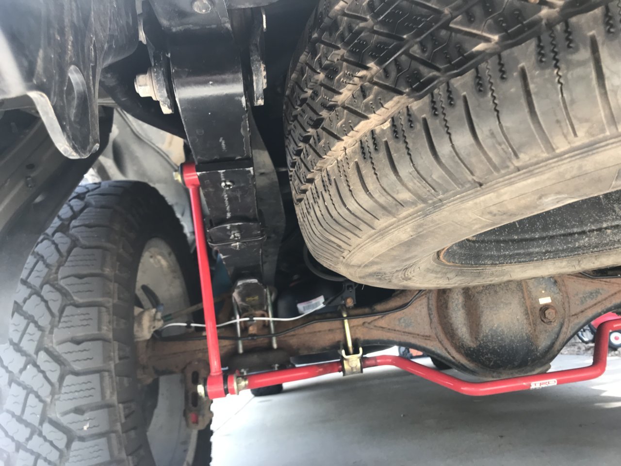

    What are the chances my sway bar ate my leaf? That energy has to go somewhere...frame and axle...then leafs, right?

    The cab never changed, the chassis is the same. Spindles, calipers, shock valving changes have nothing to do with the chassis.
  17. Sep 14, 2019 at 10:14 PM
    #47
    computeruser6
    computeruser6 Gott Mit Uns
    Dec 8, 2015
    #2216
    1,036
    Dirk
    Escondido
    2008 Regular Cab Tundra
    King 2.5 coilovers Nitto Exo Grapplers
    Are you sure?

    None, leaf springs are a wear item and this happens every once in a while.

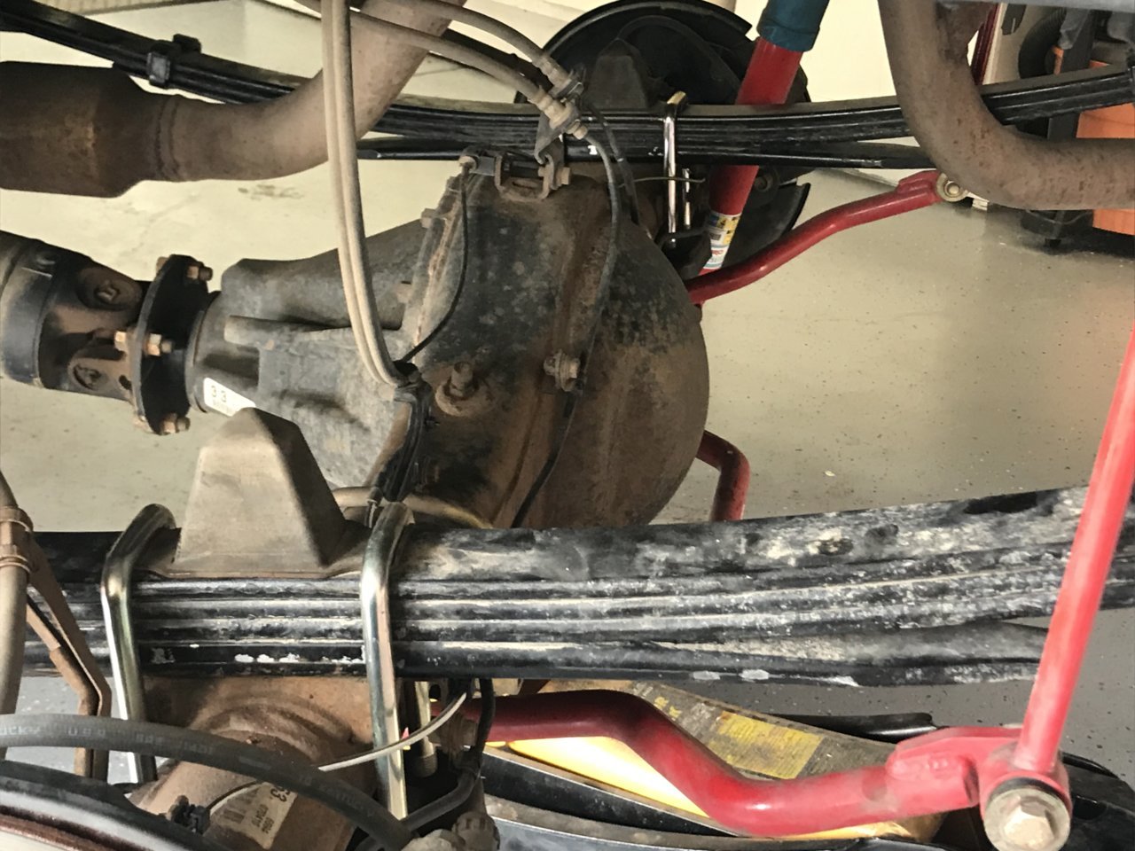

    You don't want to reuse the U-bolts, did you get new ones?

    #52
    15whtrd
    15whtrd Mr. Blonde
    Sep 20, 2015
    #1829
    9,376
    Sean
    SoCal
    Pretty sure that is only the brakes that mount differently.
    sr5shark[QUOTED] likes this.

    Yes, the bolt holes in the spindle are larger on 16 and up for the brakes...... don't ask me how I know.

    I did

    I don’t think you’re a Nancy. I just know a bottle jack is stronger than me. I’m old and decrepit and have a torn rotator cuff.
    You beat on that and mess the threads up you’re hosed.
    U bolts are supposed to be a one time use item but I’d just check them several times for proper torque over the next week and you will be fine.

    So, yeah. Pretty sure the spindles are different

    17 Tundra CM TRD
    Op, any luck? I went out and looked at mine this morning and it looks like that stud/bolt is pressed into that shackle. If you heat up the shackle part and try to keep the bolt cool (wrap it w a wet rag) you might be able to knock that piece out easier. You’ll still have to cut the bolt though to get it off tho old leaf where it’s stick in that bushing sleeve.

    Top of the morning gents! She’s all finished up...fuck ya, beer thirty! Thanks for all your help. She sits about a 1/2” taller and rides a bit firmer. I’m all in for $160, $120 for the 2018 leafs and $40 for the shackles. I upgraded to 2018 TRD sport shocks last year ($200), so this should complete the 2018 suspension upgrade, all for $360, lol.
