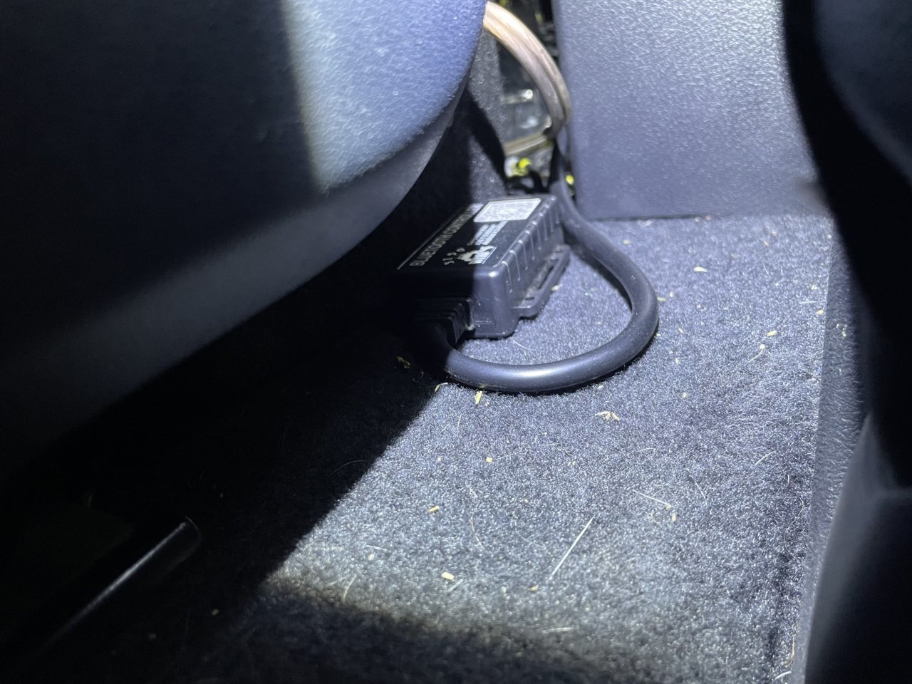

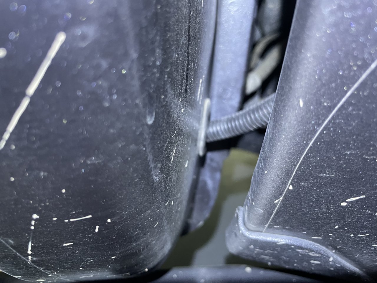

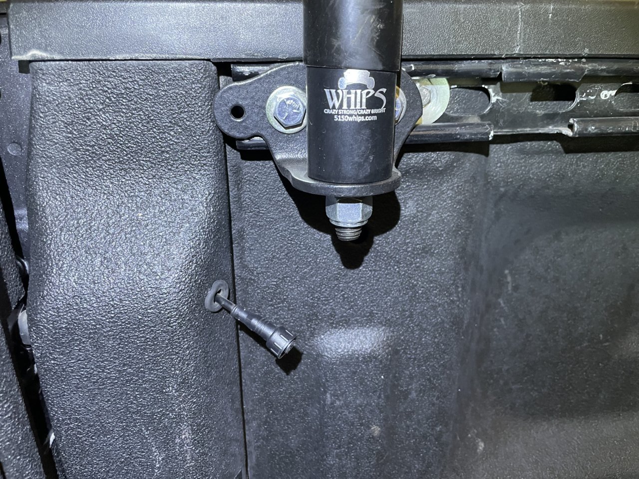

  24. Sep 1, 2022 at 10:48 AM
    #234
    TRDFerguson
    Oct 18, 2018
    #20730
    10,689
    Jake
    Southeast Greater Basin, AZ
    2018 MGM CrüeMax
    Where the controller is mounted (Velcro “hook” stuck to the bottom to hold it to the carpet)
    The grommet is used to exit the cab
    Hole in the bed, located near my BAMF mount for the whip holder

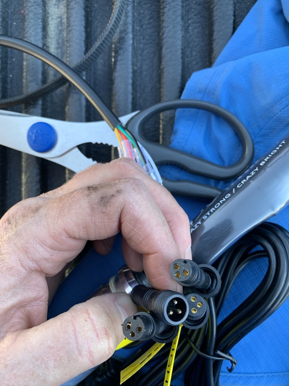

  25. Sep 18, 2022 at 6:03 PM
    #235
    Sunnier
    Aug 21, 2017
    #9171
    12,301
    Sunny
    San Diego, CA
    Hey, Guys, owing to the crazy heat last month, I’m just today trying to install this whip. Well. Wire it and connect it with zip ties anyway, so @RUSTYNUTS won’t feel disrespected about Hulk showing up nekid to the dude ranch. But I cannot get the connectors to connect. Lined up arrows, I’m not sure what I’m missing.
  26. Sep 18, 2022 at 6:12 PM
    #236
    FrenchToasty
    FrenchToasty [OP] The Desert rat, SSEM #5/25, 6 lug enthusiast
    Sep 15, 2019
    #36156
    18,350
    Mo
    The SoAz….. big surprise
    Bone stock
    The connectors are definitely not the easiest to couple together, look closely at the pins, sometimes one is tweaked a hair and needs alignment.
    Also I start by trying to get the single lower pin started by holding them at a angle and praying the top two align and slide together
  27. Sep 18, 2022 at 6:13 PM
    #237
    Sunnier
    Aug 21, 2017
    #9171
    12,301
    Sunny
    San Diego, CA
  28. Sep 18, 2022 at 6:17 PM
    #238
    Sunnier
    Aug 21, 2017
    #9171
    12,301
    Sunny
    San Diego, CA
    Nope. I either got a controller and extender that are for the non-187 whip or a wrong connector built into the 187 whip.
    Look closely, you can see those prongs are different between the connector on the whip, left; and the connector on the extension, right. The connector built into the whip has the three prongs as an evenly spaced triangle within the circle of the housing. The connector built into the extension has the three prongs basically arranged in a flat triangle that occupies only the lower half of that circular housing. See?
  29. Sep 18, 2022 at 6:25 PM
    #239
    Sunnier
    Aug 21, 2017
    #9171
    12,301
    Sunny
    San Diego, CA
    I tried each of the various combinations and there is no amount of fiddling that will make these move. I am certain there different connectors. When I look on the site it looks like they have different connectors for the 187 and the non-187. I’m thinking maybe they mixed them up-?
  30. Sep 18, 2022 at 8:55 PM
    #240
    alb1k
    Mar 6, 2021
    #60092
    6,564
    Left Coast
    05 2WD DC w/ attitude
    It's good
    sure looks like it.
