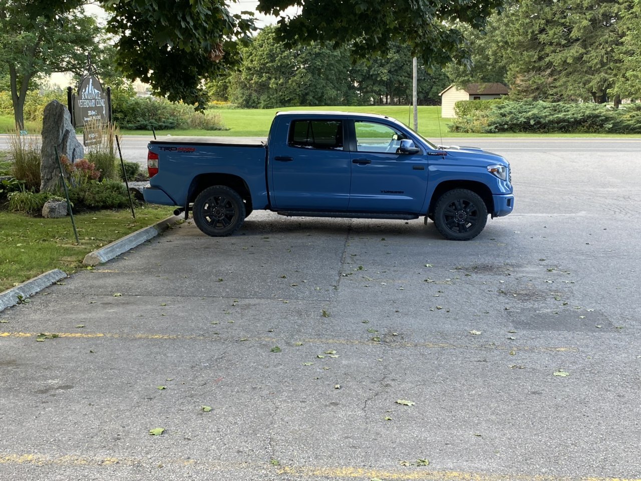

    Hey guy new here. Just ordered a set of 5100s for my 2019 TRD Sport. I have stock 20 inch rims with k02s on. In order to get the truck near level where would you recommend I set them? Mid or top setting. Pic is of before. Once I get some input, and receive the 5100s I post after. Also will it affect TSS sensors? Thanks

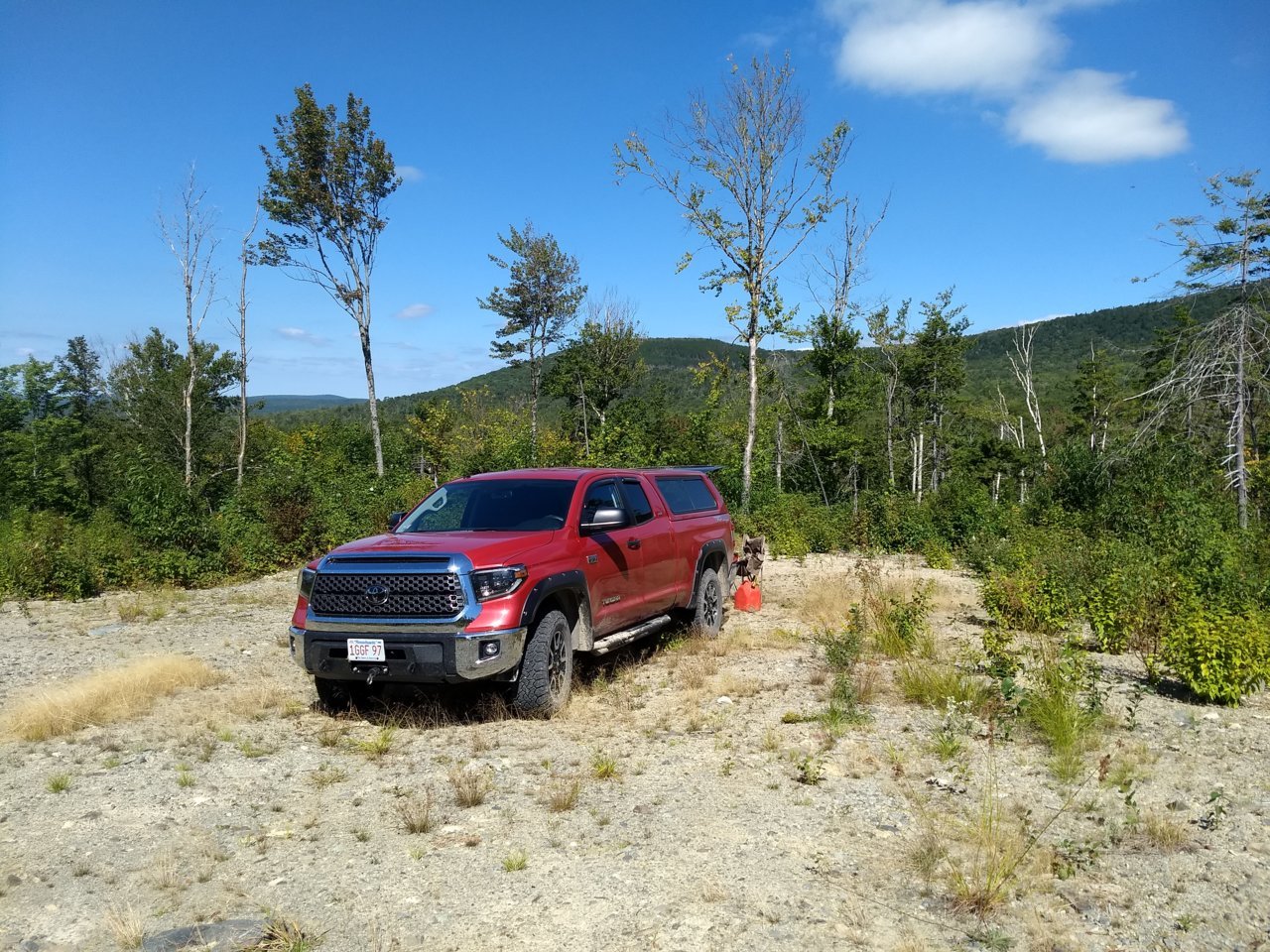

    34" on any setting unless cab mount chop mod is done. I run 33" w/o chop. Mid setting in front, +1" shackles in rear. It looked more of less level before I installed a semi-hidden bumper and a winch, but going in top setting would be too harsh ride for me.
    Probably will upgrade 5100s to Fox/King. They start OK in the morning, but heat-saturate in about an hour of relatively mild driving on log roads.

    Best pic I have w/o stepping out in a rain.
